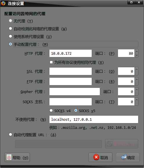

今天一时冲动,于是...嗯,就想用黑莓8100在ubuntu上网(其实是参加了中国移动的一个活动送了150M的流量,必须一个月用完--本着要充分利用社会资源,决不浪费的原则)...于是
参考着:http://blog.sina.com.cn/s/blog_59cf6726 ... revarticle
1.下载了barry-util-dbg_0.15-0_i386.deb

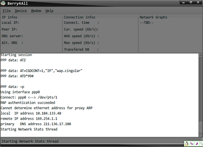

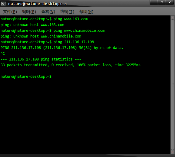

2.解压并运行 3.按Chaos前辈的提示把代理设成10.0.0.172:80. 4.结果发现网页还是打不开,于是ping了几个地址...终端上是一如少女的沉默 5.所以附上log,请各位大侠分析一下。不胜感谢!

Modem Ready at /dev/pts/1
Use ^C to terminate
Starting GPRS connect script
PPP data: BBT_OS
Starting session
Writing data size: 28
Modem -> [0x0 0x0 0x0 0x0 0x23 0x0 0x0 0x0 0x3 0x0 0x0 0x0 0x0 0xc2 0x1 0x0 ] [....#...........]
Modem -> [0x42 0x42 0x54 0x55 0x53 0x74 0x39 0x22 0x78 0x56 0x34 0x12 ] [BBTUSt9"xV4.]
Modem <- [0x0 0x0 0x0 0x0 0x23 0x0 0x0 0x0 0x23 0x0 0x0 0x0 0x0 0xc2 0x1 0x0 ] [....#...#.......]
Modem <- [0x18 0x0 0x0 0x0 0x78 0x56 0x34 0x12 ] [....xV4.]
PPP data: ATZ
Writing data size: 4
Modem -> [0x41 0x54 0x5a 0xd ] [ATZ.]
Modem <- [0x41 0x54 0x5a ] [ATZ]
Modem <- [0xd 0xa ] [..]
Modem <- [0xd 0xa 0x4f 0x4b 0xd 0xa ] [..OK..]
read: 35
PPP data: AT+CGDCONT=1,"IP","wap.cingular"
Writing data size: 33
Modem -> [0x41 0x54 0x2b 0x43 0x47 0x44 0x43 0x4f 0x4e 0x54 0x3d 0x31 0x2c 0x22 0x49 0x50 ] [AT+CGDCONT=1,"IP]
Modem -> [0x22 0x2c 0x22 0x77 0x61 0x70 0x2e 0x63 0x69 0x6e 0x67 0x75 0x6c 0x61 0x72 0x22 ] [","wap.cingular"]
Modem -> [0xd ] [.]
Modem <- [0x41 0x54 0x2b 0x43 0x47 0x44 0x43 0x4f 0x4e 0x54 0x3d 0x31 0x2c 0x22 0x49 0x50 ] [AT+CGDCONT=1,"IP]
Modem <- [0x22 0x2c 0x22 0x77 0x61 0x70 0x2e 0x63 0x69 0x6e 0x67 0x75 0x6c 0x61 0x72 0x22 ] [","wap.cingular"]
PPP data: ATD*99#
Writing data size: 8
Modem -> [0x41 0x54 0x44 0x2a 0x39 0x39 0x23 0xd ] [ATD*99#.]
Modem <- [0x41 0x54 0x44 0x2a 0x39 0x39 0x23 ] [ATD*99#]
Modem <- [0xd 0xa 0x43 0x4f 0x4e 0x4e 0x45 0x43 0x54 0xd 0xa ] [..CONNECT..]
read: 60
Serial connection established.
PPP data: ~p
Entering data mode
Modem -> [0x7e 0x70 0xd ] [~p.]
using channel 4
Using interface ppp0
Connect: ppp0 <--> /dev/pts/1
sent [LCP ConfReq id=0x1 <asyncmap 0x0>]
doubling 0x7E at: 1
Writing data size: 30
Modem -> [0x7e 0x7e 0xff 0x7d 0x23 0xc0 0x21 0x7d 0x21 0x7d 0x21 0x7d 0x20 0x7d 0x2a 0x7d ] [~~.}#.!}!}!} }*}]
Modem -> [0x22 0x7d 0x26 0x7d 0x20 0x7d 0x20 0x7d 0x20 0x7d 0x20 0x58 0x7b 0x7e ] ["}&} } } } X{~]
Modem <- [0x7e 0xff 0x7d 0x23 0xc0 0x21 0x7d 0x21 0x7d 0x20 0x7d 0x20 0x7d 0x2e 0x7d 0x22 ] [~.}#.!}!} } }.}"]
Modem <- [0x7d 0x26 0x7d 0x20 0x7d 0x20 0x7d 0x20 0x7d 0x20 0x7d 0x23 0x7d 0x24 0xc0 0x23 ] [}&} } } } }#}$.#]
Modem <- [0x7d 0x29 0xa1 0x7e ] [}).~]
Modem <- [0x7e 0xff 0x7d 0x23 0xc0 0x21 0x7d 0x22 0x7d 0x21 0x7d 0x20 0x7d 0x2a 0x7d 0x22 ] [~.}#.!}"}!} }*}"]
Modem <- [0x7d 0x26 0x7d 0x20 0x7d 0x20 0x7d 0x20 0x7d 0x20 0x31 0x7d 0x2f 0x7e ] [}&} } } } 1}/~]
read: 66
rcvd [LCP ConfReq id=0x0 <asyncmap 0x0> <auth pap>]
sent [LCP ConfAck id=0x0 <asyncmap 0x0> <auth pap>]
rcvd [LCP ConfAck id=0x1 <asyncmap 0x0>]
sent [PAP AuthReq id=0x1 user="" password=<hidden>]
doubling 0x7E at: 35
Writing data size: 49
Modem -> [0x7e 0xff 0x7d 0x23 0xc0 0x21 0x7d 0x22 0x7d 0x20 0x7d 0x20 0x7d 0x2e 0x7d 0x22 ] [~.}#.!}"} } }.}"]
Modem -> [0x7d 0x26 0x7d 0x20 0x7d 0x20 0x7d 0x20 0x7d 0x20 0x7d 0x23 0x7d 0x24 0xc0 0x23 ] [}&} } } } }#}$.#]
Modem -> [0x37 0x22 0x7e 0x7e 0xff 0x3 0xc0 0x23 0x1 0x1 0x0 0x6 0x0 0x0 0x81 0x29 ] [7"~~...#.......)]
Modem -> [0x7e ] [~]
Modem <- [0x7e 0xff 0x3 0xc0 0x23 0x2 0x1 0x0 0x4 0x94 0x86 0x7e ] [~...#......~]
read: 12
rcvd [PAP AuthAck id=0x1]
PAP authentication succeeded
sent [IPCP ConfReq id=0x1 <addr 0.0.0.0> <ms-dns1 0.0.0.0> <ms-dns2 0.0.0.0>]
doubling 0x7E at: 0
Modem -> [0x7e 0xff 0x3 0x80 0x21 0x1 0x1 0x0 0x16 0x3 0x6 0x0 0x0 0x0 0x0 0x81 ] [~...!...........]
Modem -> [0x6 0x0 0x0 0x0 0x0 0x83 0x6 0x0 0x0 0x0 0x0 0x6e 0xdb 0x7e ] [...........n.~]
Modem <- [0x7e 0xff 0x3 0x80 0x21 0x1 0x1 0x0 0xa 0x3 0x6 0xa9 0xfe 0x1 0x1 0x33 ] [~...!..........3]
Modem <- [0xe7 0x7e ] [.~]
Modem <- [0x7e 0xff 0x3 0x80 0x21 0x4 0x1 0x0 0xa 0x83 0x6 0x0 0x0 0x0 0x0 0xa ] [~...!...........]
Modem <- [0xb1 0x7e ] [.~]
read: 36
rcvd [IPCP ConfReq id=0x1 <addr 169.254.1.1>]
sent [IPCP ConfAck id=0x1 <addr 169.254.1.1>]
rcvd [IPCP ConfRej id=0x1 <ms-dns2 0.0.0.0>]
sent [IPCP ConfReq id=0x2 <addr 0.0.0.0> <ms-dns1 0.0.0.0>]
doubling 0x7E at: 0
doubling 0x7E at: 17
Writing data size: 43
Modem -> [0x7e 0xff 0x3 0x80 0x21 0x2 0x1 0x0 0xa 0x3 0x6 0xa9 0xfe 0x1 0x1 0x5a ] [~...!..........Z]
Modem -> [0x93 0x7e 0x7e 0xff 0x3 0x80 0x21 0x1 0x2 0x0 0x10 0x3 0x6 0x0 0x0 0x0 ] [.~~...!.........]
Modem -> [0x0 0x81 0x6 0x0 0x0 0x0 0x0 0x7d 0x5e 0x1d 0x7e ] [.......}^.~]
Modem <- [0x7e 0xff 0x3 0x80 0x21 0x3 0x2 0x0 0x10 0x3 0x6 0xa 0xb1 0xb4 0x66 0x81 ] [~...!.........f.]
Modem <- [0x6 0xd3 0x88 0x11 0x6c 0xeb 0x47 0x7e ] [....l.G~]

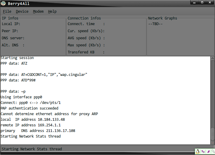

PPP data: BBT_OS
Starting session

PPP data: ~p
Entering data mode
using channel 4

Cannot determine ethernet address for proxy ARP
local IP address 10.184.133.48
remote IP address 169.254.1.1
primary DNS address 211.136.17.108
Script /etc/ppp/ip-up started (pid 6340)
Script /etc/ppp/ip-up finished (pid 6340), status = 0x0
