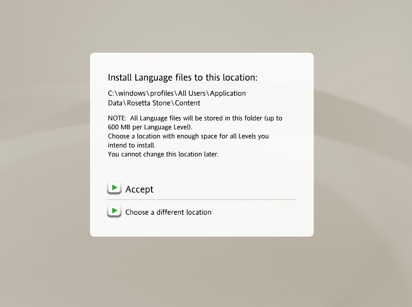

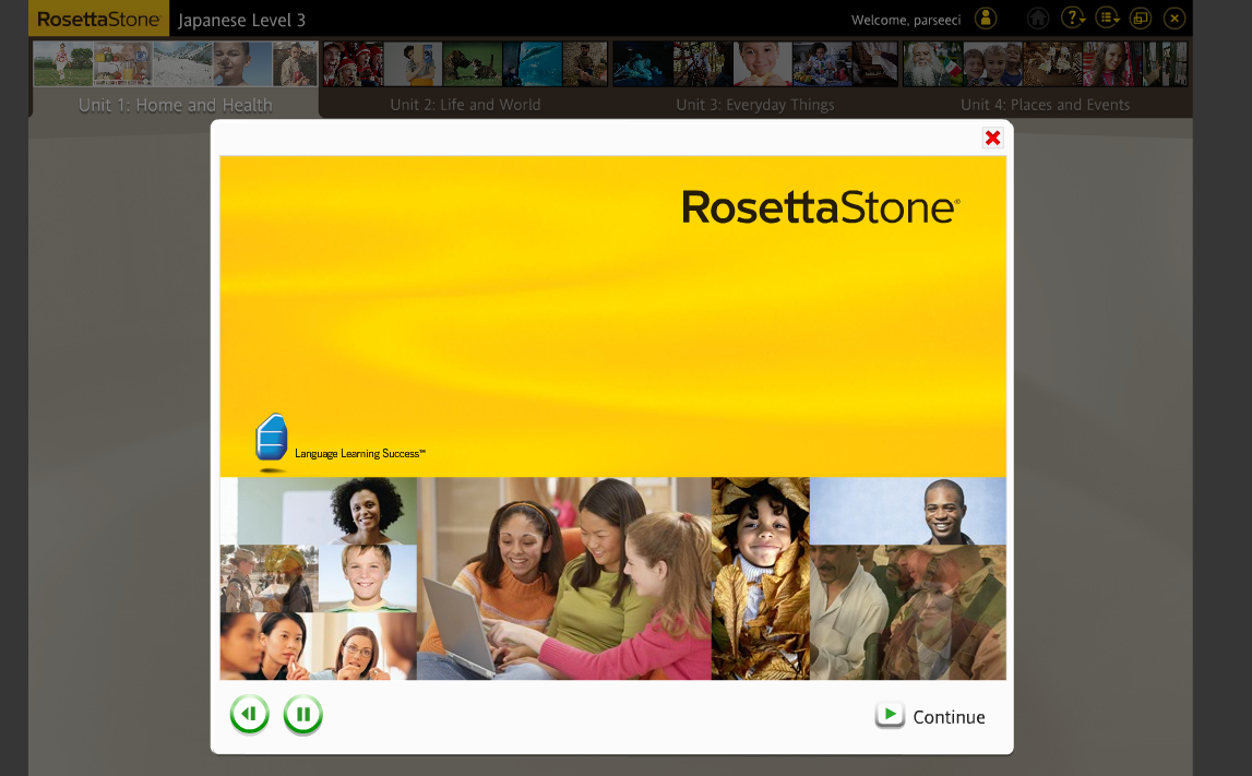

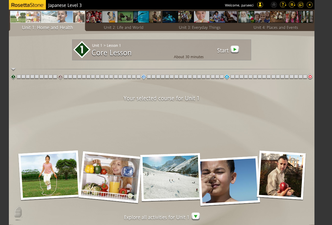

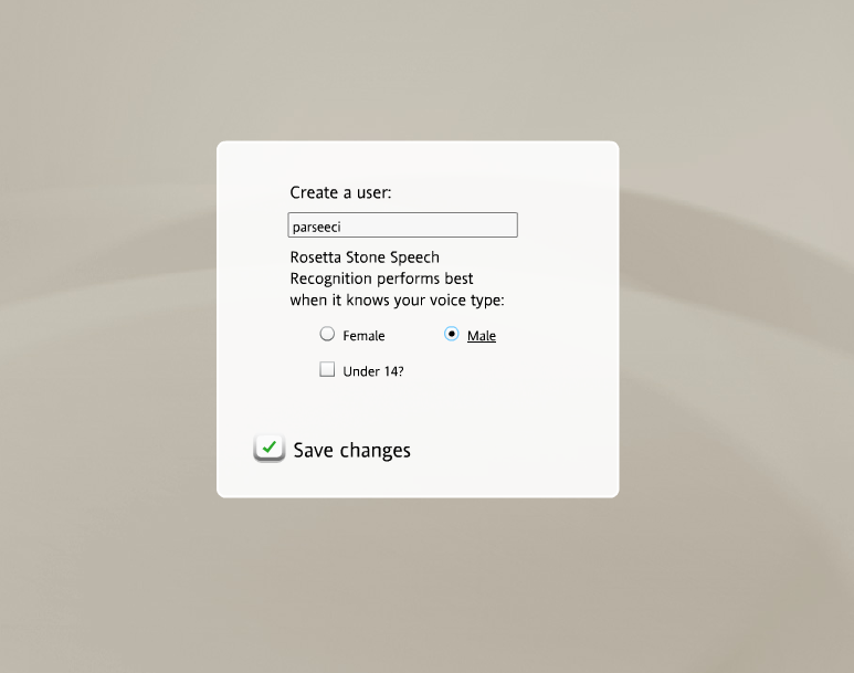

自从老衲学会如何使用gmount-iso加载虚拟光驱,然后使用configure
wine - 驱动器(driver) - 自动侦测- 去在wine 中加载iso文件
后,老衲wine成功了新东方英语学习系列软件,还有大学英语听力教程
iso等之前在虚拟机中才能完成的任务。
老衲太高兴了,学习软件能够在ubuntu中使用,老衲的学习更方便了。
老衲使用verycd下载了一套rosetta stone语言学习软件,
昨天成功wine出来了,和大家分享一下~
screenshot54.png [ 114.89 KiB | 被浏览 2268 次 ]

嗯~ 俺也打算使用它学习一下普通话,支持你使用~ 首先,你去下载rosetta stone3.4.5这个版本,和对应版本的语言包。
rosetta其他的版本俺虽然全部下载了,可是3.4.5成功了就不打算实验
其他版本了。 还有,俺的wine是1.2版本 —— ubuntu10.04都是1.2吧~
然后使用gmount-iso去加载.iso文件.
接着就按照windows下面的步骤去安装rosetta.
非常简单就ok了
咳咳…… 安装语言包可要折腾人了
不过,老外成功解决了这个问题:
..this is what worked for me
install Rosetta Stone language packs with Wine
To get language packs installed:
1. copy the language .iso from the cd to a folder
2. mount the .iso using gmount-iso from the folder
3. In Configure Wine from the applications menu go to the drives tab and add the mounted .iso as a drive. Under advanced settings set the type to CDROM.
4. Run Rosetta Stone and install the language pack.
这个老外可谓言简意赅,按他的方法俺成功安装了语言包
接下来:
To get the microphone working:
1. In volume control, device is set to Alsa mixer. Under preferences add all the capture and input source tabs, make sure they are not muted and input source is set to mic.
2. In wine configuration under the audio tab make sure alsa is selected.
that is it... I have read running 'killall pulseaudio' in a terminal before running Rosetta Stone helps. This worked for me, not sure if it is good advice or what it does... some of these steps might not be necessary, but this is what I did... everything works fine.
还有什么不懂的,去这里看看: http://appdb.winehq.org/objectManager.p ... &iId=10043
俺就是从这里了解如何去安装的~ 祝你成功~
喜欢笨兔,没事研究一下~ 目前最大的愿望是ubuntu能够出萌化包.deb~
