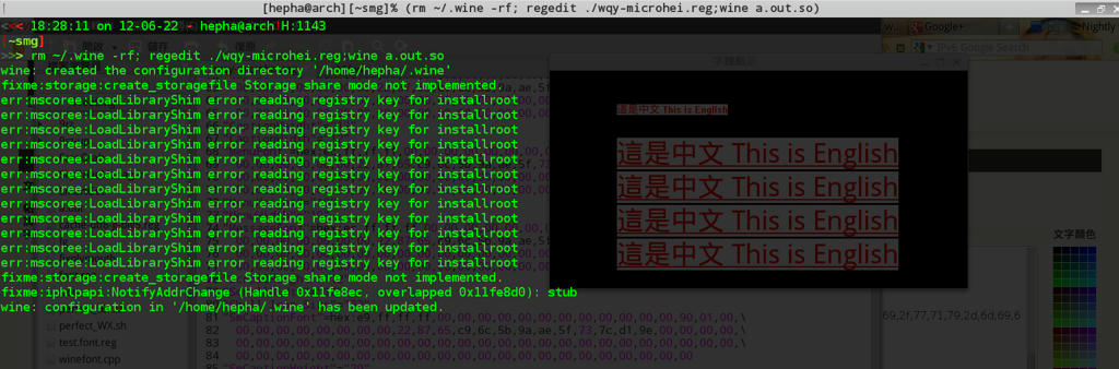

hepha
帖子: 23
注册时间: 2008-06-19 4:54
Re: wine 中文问题【新解决方案】【高手进】
帖子 hepha » 2012-06-22 19:01
從以下可以看出來Wine\Fonts\Cache中的字型Courier、Tahoma位置都錯了
[HKEY_CURRENT_USER\Software\Wine\Fonts\Cache\Courier\Regular\832]
"File Name"=hex:2f,75,73,72,2f,62,69,6e,2f,2e,2e,2f,73,68,61,72,65,2f,77,69,6e,65,2f,66,6f,6e,74,73,2f,63,6f,75,72,65,2e,66,6f,6e,00
echo 2f,75,73,72,2f,62,69,6e,2f,2e,2e,2f,73,68,61,72,65,2f,77,69,6e,65,2f,66,6f,6e,74,73,2f,63,6f,75,72,65,2e,66,6f,6e,00| xxd -r -p
/usr/bin/../share/wine/fonts/coure.fon
[HKEY_CURRENT_USER\Software\Wine\Fonts\Cache\Tahoma\Regular]
"File Name"=hex:2f,75,73,72,2f,62,69,6e,2f,2e,2e,2f,73,68,61,72,65,2f,77,69,6e,65,2f,66,6f,6e,74,73,2f,2f,74,61,68,6f,6d,61,2e,74,74,66,00
echo 2f,75,73,72,2f,62,69,6e,2f,2e,2e,2f,73,68,61,72,65,2f,77,69,6e,65,2f,66,6f,6e,74,73,2f,2f,74,61,68,6f,6d,61,2e,74,74,66,00| xxd -r -p
/usr/bin/../share/wine/fonts//tahoma.ttf
我修改成正確的路徑
echo  /usr/share/wine/fonts/tahoma.ttf |od -tx1 |cut -c8-|tr -d '\n'|tr -s ' ' ','|sed 's/^,//'
2f,75,73,72,2f,73,68,61,72,65,2f,77,69,6e,65,2f,66,6f,6e,74,73,2f,74,61,68,6f,6d,61,2e,74,74,66,0a
echo  /usr/share/wine/fonts/courer.fon |od -tx1 |cut -c8-|tr -d '\n'|tr -s ' ' ','|sed 's/^,//'
2f,75,73,72,2f,73,68,61,72,65,2f,77,69,6e,65,2f,66,6f,6e,74,73,2f,63,6f,75,72,65,72,2e,66,6f,6e,0a
加上字體修正的登錄檔就如圖片所示
REGEDIT4
[HKEY_LOCAL_MACHINE\Software\Microsoft\Windows NT\CurrentVersion\FontLink]
"FontLinkControl"=dword:00004000
"FontLinkDefaultChar"=dword:00003000
[HKEY_CURRENT_USER\Software\Wine\X11 Driver]
;打開字體的防鋸齒
"ClientSideAntiAliasWithCore"="Y"
"ClientSideAntiAliasWithRender"="Y"
"ClientSideWithRender"="Y"
[HKEY_USERS\.DEFAULT\Control Panel\Desktop]
;打開字體的平滑功能
"FontSmoothing"="2"
[HKEY_LOCAL_MACHINE\Software\Microsoft\Windows NT\CurrentVersion\FontSubstitutes]
"Arial CE,238"="WenQuanYi Micro Hei"
"Arial CYR,204"="WenQuanYi Micro Hei"
"Arial Greek,161"="WenQuanYi Micro Hei"
"Arial TUR,162"="WenQuanYi Micro Hei"
"Arial"="WenQuanYi Micro Hei"
"Courier New CE,238"="WenQuanYi Micro Hei"
"Courier New"="Courier New"
"Courier New CYR,204"="WenQuanYi Micro Hei"
"Courier New Greek,161"="WenQuanYi Micro Hei"
"Courier New TUR,162"="WenQuanYi Micro Hei"
"FixedSys"="WenQuanYi Micro Hei"
"Helvetica"="WenQuanYi Micro Hei"
"Helv"="WenQuanYi Micro Hei"
"MingLiU"="WenQuanYi Micro Hei"
"MS Sans Serif"="WenQuanYi Micro Hei"
"MS Shell Dlg 2"="WenQuanYi Micro Hei"
"MS Shell Dlg"="WenQuanYi Micro Hei"
"PMingLiU"="WenQuanYi Micro Hei"
"System"="WenQuanYi Micro Hei"
"Times New Roman CE,238"="WenQuanYi Micro Hei"
"Times New Roman CYR,204"="WenQuanYi Micro Hei"
"Times New Roman Greek,161"="WenQuanYi Micro Hei"
"Times New Roman"="Times New Roman"
"Times New Roman TUR,162"="WenQuanYi Micro Hei"
"Times"="WenQuanYi Micro Hei"
"Tms Rmn"="WenQuanYi Micro Hei"
"新細明體"="WenQuanYi Micro Hei"
[HKEY_CURRENT_USER\Software\Wine\Fonts\Replacements]
@="WenQuanYi Micro Hei"
"Fixedsys"="WenQuanYi Micro Hei"
"Lucida Sans Unicode"="WenQuanYi Micro Hei"
"Microsoft Sans Serif"="WenQuanYi Micro Hei"
"MS UI Gothic"="WenQuanYi Micro Hei"
"Simsun"="WenQuanYi Micro Hei"
"Songti"="WenQuanYi Micro Hei"
"Terminal"="WenQuanYi Micro Hei"
[HKEY_LOCAL_MACHINE\SOFTWARE\Microsoft\Windows NT\CurrentVersion\GRE_Initialize]
"GUIFont.Facename"="WenQuanYi Micro Hei"
[HKEY_CURRENT_USER\Control Panel\Desktop\WindowMetrics]
"BorderWidth"="1"
"CaptionFont"=hex:ec,ff,ff,ff,00,00,00,00,00,00,00,00,00,00,00,00,90,01,00,00,\
00,00,00,00,00,00,00,22,87,65,c9,6c,5b,9a,ae,5f,73,7c,d1,9e,00,00,00,00,00,\
00,00,00,00,00,00,00,00,00,00,00,00,00,00,00,00,00,00,00,00,00,00,00,00,00,\
"CaptionHeight"="12"
"CaptionWidth"="12"
"MenuFont"=hex:ec,ff,ff,ff,00,00,00,00,00,00,00,00,00,00,00,00,90,01,00,00,00,\
00,00,00,00,00,00,22,87,65,c9,6c,5b,9a,ae,5f,73,7c,d1,9e,00,00,00,00,00,00,\
"MenuHeight"="10"
"MenuWidth"="10"
"MessageFont"=hex:ec,ff,ff,ff,00,00,00,00,00,00,00,00,00,00,00,00,90,01,00,00,\
"ScrollHeight"="12"
"ScrollWidth"="12"
"Shell Icon Size"="32"
"SmCaptionFont"=hex:e9,ff,ff,ff,00,00,00,00,00,00,00,00,00,00,00,00,90,01,00,\
00,00,00,00,00,00,00,00,22,87,65,c9,6c,5b,9a,ae,5f,73,7c,d1,9e,00,00,00,00,\
"SmCaptionHeight"="29"
"SmCaptionWidth"="14"
"StatusFont"=hex:ec,ff,ff,ff,00,00,00,00,00,00,00,00,00,00,00,00,90,01,00,00,\
[HKEY_USERS\S-1-5-4\Software\Wine\AppDefaults\SMG.exe]
"Version"="win2k"
[HKEY_LOCAL_MACHINE\System\CurrentControlSet\Hardware Profiles\Current\Software\Fonts]
"LogPixels"=dword:00000078
[HKEY_LOCAL_MACHINE\SOFTWARE\Microsoft\Windows NT\CurrentVersion\FontDPI]
[HKEY_LOCAL_MACHINE\SYSTEM\CurrentControlSet\Hardware Profiles\0001\Software\Fonts]
[HKEY_LOCAL_MACHINE\SYSTEM\CurrentControlSet\Control\FontAssoc\Associated]
"DefaultFonts"="WenQuanYi Micro Hei"
[HKEY_USERS\S-1-5-21-0-0-0-1000\Software\Wine\Fonts\Cache\Tahoma\Regular]
"File Name"=hex:2f,75,73,72,2f,73,68,61,72,65,2f,77,69,6e,65,2f,66,6f,6e,74,73,2f,74,61,68,6f,6d,61,2e,74,74,66,0a
[HKEY_USERS\S-1-5-21-0-0-0-1000\Software\Wine\Fonts\Cache\Courier\Regular\832]
"File Name"=hex:2f,75,73,72,2f,73,68,61,72,65,2f,77,69,6e,65,2f,66,6f,6e,74,73,2f,63,6f,75,72,65,72,2e,66,6f,6e,0a
wqy-microhei.reg
http://www.mediafire.com/?wwmbbcp7yc16di1
全正常但tahoma字變小不知要如何解決?
