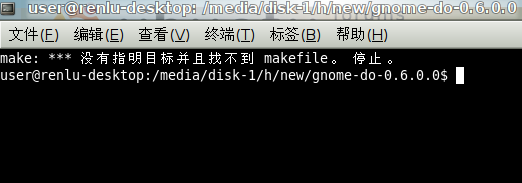

按照网上说的方法,.tar.gz文件一般都是采用以下方法安装
解压后编译:
sudo ./configure
make
make install
但我在执行make时,返回来下图的提示
screenshot1.png [ 28.03 KiB | 被浏览 467 次 ]
这是什么意思?

誰教你的?
解压后编译:
sudo ./configure (錯)
make
make install (錯)
不對,應該是:
./configure
make (對於驅動安裝,有時要sudo make)
sudo make install
更正確是:
./configure --prefix=/usr
make
sudo make install
對於gnome-do,不用configure的。用autogen
詳細參考:
https://wiki.ubuntu.com/GnomeDo/Installation

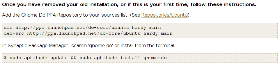

再回2楼,你给我的地址好像是删除gnome-do吧?里面好像只有在提供了在网上的升级方法,没有说如何在下载了.gz文件后的安装方法。

lvyichat 写道:
你看完全文了嗎?
最後有一個主題是"From Source"
摘要:
Building from the latest source currently requires the following development libraries:
bzr (>= 0.92)
* mono-gmcs
* cairo-sharp
NDesk DBus & NDesk DBus Glib
* gtk-sharp2
* gnome-vfs-sharp
* gconf-sharp
* glade-sharp-2
* glib-sharp-2
* glib-2.0
* gdk-2.0
* gdk-x11-2.0
* gtk+-2.0
* gnome-desktop-sharp-2.0 (gnome-sharp2)
* notify-sharp
There may be other dependencies not listed here. If there are, autogen.sh should complain about them (feel free to add these to the list!). Building from bzr also requires autotools & intltool. You can also download periodic releases, which do not require autotools, but they may not be up-to-date.
On an Ubuntu, Debian, or derived system, these dependencies can be installed by
sudo aptitude install automake bzr mono-gmcs libmono-cairo2.0-cil gtk-sharp2 libndesk-dbus-glib1.0-cil libndesk-dbus1.0-cil libgnome-vfs2.0-cil libgtk2.0-dev libtool intltool gnome-sharp2 ca-certificates bazaar gnome-keyring-sharp-cli gnome-desktop-sharp2 libnotify0.4-cil
Users of Ubuntu releases prior to Hardy (Gutsy, Feisty, etc) will need a newer version of bzr. This can be found either in the official backports repository, or in the Bazaar team PPA
Once all the dependencies are installed, the Do source can be branched by:
$ bzr branch lp:do gnome-do
and then built and installed by one of the following:
$ cd gnome-do
$ ./autogen.sh
$ make
$ sudo make install
To install system wide, or
$ cd gnome-do
$ ./autogen.sh --prefix=$HOME/.local
$ make
$ make install
To install into the home directory of the current user. The gnome-do binary will end up at ~/.local/bin/gnome-do
To update run
$ bzr pull
in the gnome-do source directory, then build as before.
Plugins are also available from source. Plugins may be installed in a system-wide location or in ~/.local/share/gnome-do/plugins on per-user basis.
$ bzr branch lp:do-plugins
$ cd do-plugins
