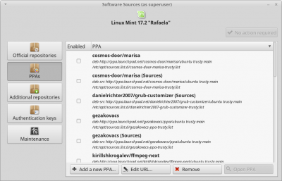

「Software Sources」を起動させ、PPAs で(すべてのPPAS のチェック外し)
右上角の「キャッシュをアップデート」をクリック
Launch "Software Sources", with PPAs (Uncheck all PPAS)
Click "update cache" in the upper right corner
m@m ~ $ export LC_ALL=en_US.UTF-8
m@m ~ $ sudo apt-get update
[sudo] password for m:
Ign http://packages.linuxmint.com rafaela InRelease
6% [Connecting to ftp.mondorescue.org] [Waiting for headers] [Waiting for head
W: GPG error: ftp://ftp.mondorescue.org 14.04 Release: The following signatures were invalid: BADSIG 6BA8C2D220EBFB0E Bruno Cornec (FLOSS & Early Music) <bruno@victoria.frmug.org>
W: Duplicate sources.list entry https://dl.winehq.org/wine-builds/ubuntu/ trusty/main amd64 Packages (/var/lib/apt/lists/dl.winehq.org_wine-builds_ubuntu_dists_trusty_main_binary-amd64_Packages)
W: Duplicate sources.list entry https://dl.winehq.org/wine-builds/ubuntu/ trusty/main i386 Packages (/var/lib/apt/lists/dl.winehq.org_wine-builds_ubuntu_dists_trusty_main_binary-i386_Packages)
m@m ~ $
