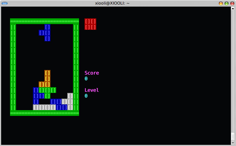

RT
无意间居然发现了一个bash版的俄罗斯方块,太完美了 :D
Screenshot-xiooli@XIOOLI.png [ 19.92 KiB | 被浏览 1867 次 ]

   #显示右边预显示的方块
   echo -ne "\033[1m\033[7m\033[3${cBoxNew}m\033[4${cBoxNew}m"
   for ((j = 0; j < 8; j += 2))
   do
      ((i = iTop + 1 + ${boxNew[$j]}))
      ((t = iLeft + 2 * iTrayWidth + 7 + 2 * ${boxNew[$j + 1]}))
      echo -ne "\033[${i};${t}H[]"
   done
   echo -ne "\033[0m"
#初始绘制
function InitDraw()
   clear
   RandomBox   #随机产生方块,这时右边预显示窗口中有方快了
   RandomBox   #再随机产生方块,右边预显示窗口中的方块被更新,原先的方块将开始下落
   local i t1 t2 t3
   #显示边框
   echo -ne "\033[1m"
   echo -ne "\033[3${cBorder}m\033[4${cBorder}m"
   ((t2 = iLeft + 1))
   ((t3 = iLeft + iTrayWidth * 2 + 3))
   for ((i = 0; i < iTrayHeight; i++))
   do
      ((t1 = i + iTop + 2))
      echo -ne "\033[${t1};${t2}H||"
      echo -ne "\033[${t1};${t3}H||"
   done
   ((t2 = iTop + iTrayHeight + 2))
   for ((i = 0; i < iTrayWidth + 2; i++))
   do
      ((t1 = i * 2 + iLeft + 1))
      echo -ne "\033[${iTrayTop};${t1}H=="
      echo -ne "\033[${t2};${t1}H=="
   done
   echo -ne "\033[0m"
   #显示"Score"和"Level"字样
   echo -ne "\033[1m"
   ((t1 = iLeft + iTrayWidth * 2 + 7))
   ((t2 = iTop + 10))
   echo -ne "\033[3${cScore}m\033[${t2};${t1}HScore"
   ((t2 = iTop + 11))
   echo -ne "\033[3${cScoreValue}m\033[${t2};${t1}H${iScore}"
   ((t2 = iTop + 13))
   echo -ne "\033[3${cScore}m\033[${t2};${t1}HLevel"
   ((t2 = iTop + 14))
   echo -ne "\033[3${cScoreValue}m\033[${t2};${t1}H${iLevel}"
   echo -ne "\033[0m"
#退出时显示GameOVer!
function ShowExit()
   local y
   ((y = iTrayHeight + iTrayTop + 3))
   echo -e "\033[${y};0HGameOver!\033[0m"
   exit
#显示用法.
function Usage
   cat << EOF
Usage: $APP_NAME
Start tetris game.
  -h, --help              display this help and exit
      --version           output version information and exit
EOF
#游戏主程序在这儿开始.
if [[ "$1" == "-h" || "$1" == "--help" ]]; then
   Usage
elif [[ "$1" == "--version" ]]; then
   echo "$APP_NAME $APP_VERSION"
elif [[ "$1" == "--show" ]]; then
   #当发现具有参数--show时,运行显示函数
   RunAsDisplayer
else
   bash $0 --show&   #以参数--show将本程序再运行一遍
   RunAsKeyReceiver $!   #以上一行产生的进程的进程号作为参数
fi

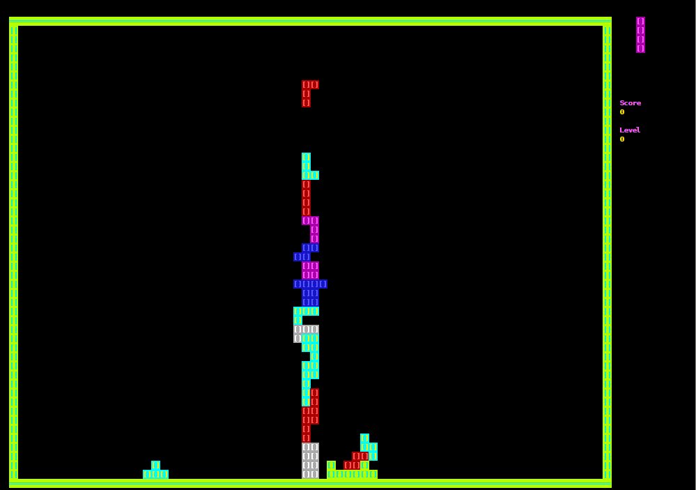

如果
1>能改变下落的方向就好了, 比如从左向右
2>能改变尺寸就好了, 空间太小了。
3>能自定义空间的大小
4>不是矩形, 而是梯形是不是会更意思

yjcong 写道:
:em05 :em05
你是怎么调的啊?
帖子发表于 : 2008-07-20 19:03
注册: 2006-02-28 3:11
帖子: 2470
xiooli 写道:
yjcong 写道:
:em05 :em05
你是怎么调的啊?
#位置和大小
iLeft=3
iTop=2
((iTrayLeft = iLeft + 2))
((iTrayTop = iTop + 1))
((iTrayWidth = 40))
((iTrayHeight=30))
iTrayWidth 和iTrayHeight , 如果你把终端的字体也调的很小, 那么这两个值可以更大
一梦三年,
松风依旧,
萝月何曾老.
灵幽听微, 谁观玉颜?
灼灼春华, 绿叶含丹.
