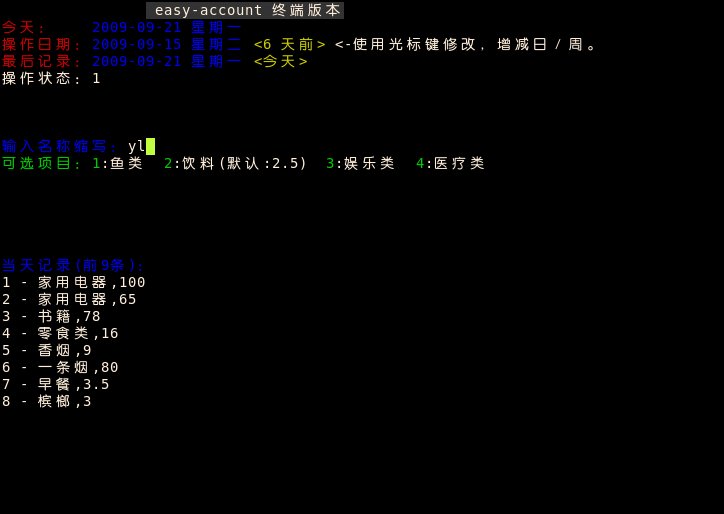

screenshot-2009-09-21-20-10-54.jpg [ 30.42 KiB | 被浏览 843 次 ]

☛ cat ea.sqlite3.pl
#!/usr/bin/perl
use Term::Screen;
$scr = new Term::Screen;
unless ($scr) { die "无法产生屏幕。\n"; }
$black="\e[30m"; $red="\e[31m"; $green="\e[32m"; $yellow="\e[33m";
$blue="\e[34m"; $pink="\e[35m"; $cyan="\e[36m"; $white="\e[37m";
$normal="\e[0m"; $bold="\e[1m"; $reverse="\e[7m";
$b_black="\e[40m"; $b_red="\e[41m"; $b_green="\e[42m"; $b_yellow="\e[43m";
$b_blue="\e[44m"; $b_pink="\e[45m"; $b_cyan="\e[46m"; $b_white="\e[47m";
$scr->clrscr();$scr->noecho();
$scr->resize(80,30);
print "\t\t${reverse} easy-account sqlite3 终端版本${normal}";
