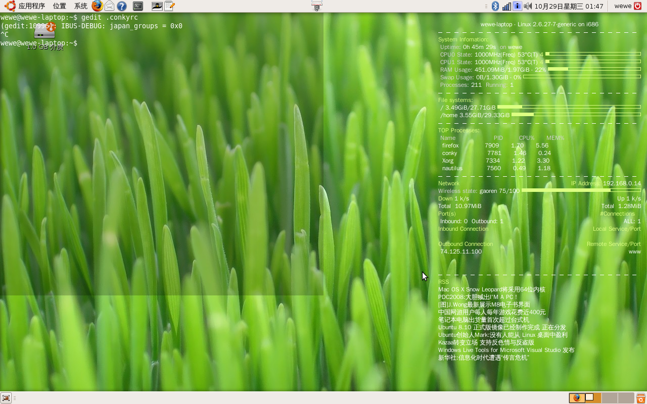

根据别人的东拼西凑的,只有无线那一条是自己些的,有时间再完善一下,哈哈
# Conky sample configuration
# the list of variables has been removed from this file in favour
# of keeping the documentation more maintainable.
# Check http://conky.sf.net for an up-to-date-list.
# set to yes if you want Conky to be forked in the background
background yes
# X font when Xft is disabled, you can pick one with program xfontsel
#font 5x7
#font 6x10
#font 7x13
#font 8x13
#font 9x15
#font *mintsmild.se*
#font -*-*-*-*-*-*-34-*-*-*-*-*-*-*
# Use Xft?
use_xft yes
# Xft font when Xft is enabled
xftfont Liberation Monospace:size=9
# Text alpha when using Xft
xftalpha 1.0
# Print everything to stdout?
# out_to_console no
# MPD host/port
# mpd_host localhost
# mpd_port 6600
# mpd_password tinker_bell
# Print everything to console?
# out_to_console no
# mail spool
#mail_spool $MAIL
# Update interval in seconds
update_interval 2.0
# This is the number of times Conky will update before quitting.
# Set to zero to run forever.
total_run_times 0
# Create own window instead of using desktop (required in nautilus)
own_window yes
# If own_window is yes, you may use type normal, desktop or override
own_window_type override
# Use pseudo transparency with own_window?
own_window_transparent yes
# If own_window_transparent is set to no, you can set the background colour here
# own_window_colour hotpink
# If own_window is yes, these window manager hints may be used
#own_window_hints undecorated,below,sticky,skip_taskbar,skip_pager
# Use double buffering (reduces flicker, may not work for everyone)
double_buffer yes
# Minimum size of text area
minimum_size 400 5
# Draw shades?
draw_shades no
# Draw outlines?
draw_outline no
# Draw borders around text
draw_borders no
# Draw borders around graphs
draw_graph_borders yes
# Stippled borders?
stippled_borders 8
# border margins
border_margin 4
# border width
border_width 1
# Default colors and also border colors
default_color white
default_shade_color black
default_outline_color black
# Text alignment, other possible values are commented
#alignment top_left
alignment top_right
#alignment bottom_left
#alignment bottom_right
#alignment none
# Gap between borders of screen and text
# same thing as passing -x at command line
gap_x 12
gap_y 40
# Subtract file system buffers from used memory?
no_buffers yes
# set to yes if you want all text to be in uppercase
uppercase no
# number of cpu samples to average
# set to 1 to disable averaging
cpu_avg_samples 2
# number of net samples to average
net_avg_samples 2
# Force UTF8? note that UTF8 support required XFT
override_utf8_locale yes
# Add spaces to keep things from moving about?  This only affects certain objects.
use_spacer no
# Allow each port monitor to track at most this many connections (if 0 or not set, default is 256)
#max_port_monitor_connections 256
# Maximum number of special things, e.g. fonts, offsets, aligns, etc.
#max_specials 512
# Maximum size of buffer for user text, i.e. below TEXT line.
#max_user_text 16384
# Timing interval for music player thread, e.g. mpd, audacious
#music_player_interval (update_interval is default)
# variable is given either in format $variable or in ${variable}. Latter
# allows characters right after the variable and must be used in network
# stuff because of an argument
# stuff after 'TEXT' will be formatted on screen
#${color #88aadd}MPD: ${alignc}$mpd_artist - $mpd_title
#${color #88aadd}$mpd_bar
#${color #88aadd}${alignc}$mpd_status
#${color red}${cpugraph 0000ff 00ff00}
#${color #0000ff}${downspeedgraph eth1 32,150 ff0000 0000ff} ${color #22ccff}${upspeedgraph eth1 32,150 0000ff ff0000}
TEXT
${alignc}$nodename - $sysname $kernel on $machine
$stippled_hr
${color  #dcff82}System Infomation:
 ${color lightgrey}Uptime:$color $uptime ${color lightgrey} on $color${exec whoami}
 ${color lightgrey}CPU0 State: $color${freq cpu0}MHz(Freq) $acpitemp°C(T) ${color #dcff82}${cpu cpu0} ${cpubar}
 ${color lightgrey}CPU1 State: $color${freq cpu1}MHz(Freq) $acpitemp°C(T) ${color #dcff82}${cpu cpu1} ${cpubar}
 ${color lightgrey}RAM Usage:$color $mem/$memmax - $memperc% ${color  #dcff82}${membar}
 ${color lightgrey}Swap Usage:$color $swap/$swapmax - $swapperc% ${color  #dcff82}${swapbar}
 ${color lightgrey}Processes:$color $processes  ${color lightgrey}Running:$color $running_processes
$color$stippled_hr
${color  #dcff82}File systems:
 ${color}/ $color${fs_used /}/${fs_size /} ${color  #dcff82}${fs_bar /}
 ${color}/home $color${fs_used /home}/${fs_size /home} ${color  #dcff82}${fs_bar /home}
$color$stippled_hr
${color  #dcff82}TOP Processes:
${color lightgrey} Name                   PID        CPU%      MEM%
${color}  ${top name 1}    ${top pid 1}    ${top cpu 1}    ${top mem 1}
${color}  ${top name 2}    ${top pid 2}    ${top cpu 2}    ${top mem 2}
${color}  ${top name 3}    ${top pid 3}    ${top cpu 3}    ${top mem 3}
${color}  ${top name 4}    ${top pid 4}    ${top cpu 4}    ${top mem 4}
$stippled_hr
${color #dcff82}Network $alignr ${color #dcff82}IP Address: ${color FFFFFF}${addr wlan0}${color}
${color lightgrey}Wireless state: $color${wireless_essid wlan0} ${wireless_link_qual_perc wlan0}/${wireless_link_qual_max wlan0} ${color #dcff82}${wireless_link_bar wlan0}
Down ${color FFFFFF}${downspeed wlan0} k/s ${color}${alignr}Up ${color FFFFFF}${upspeed wlan0} k/s
Total  ${color FFFFFF}${totaldown wlan0}${color} ${alignr}Total  ${color FFFFFF}${totalup wlan0}
${color #dcff82}Port(s)${alignr}#Connections
$color Inbound: ${tcp_portmon 1 32767 count}  Outbound: ${tcp_portmon 32768 61000 count}${alignr}ALL: ${tcp_portmon 1 65535 count}
${color  #dcff82}Inbound Connection ${alignr} Local Service/Port$color
 ${tcp_portmon 1 32767 rhost 0} ${alignr} ${tcp_portmon 1 32767 lservice 0}
${color  #dcff82}Outbound Connection ${alignr} Remote Service/Port$color
 ${tcp_portmon 32768 61000 rhost 0} ${alignr} ${tcp_portmon 32768 61000 rservice 0}
 ${tcp_portmon 32768 61000 rhost 1} ${alignr} ${tcp_portmon 32768 61000 rservice 1}
 ${tcp_portmon 32768 61000 rhost 2} ${alignr} ${tcp_portmon 32768 61000 rservice 2}
$stippled_hr
${color #dcff82}RSS
${color}${rss http://www.cnbeta.com/backend.php 5 item_titles 10}

效果图 :em06 :em06
conky.png [ 1.24 MiB | 被浏览 11066 次 ]

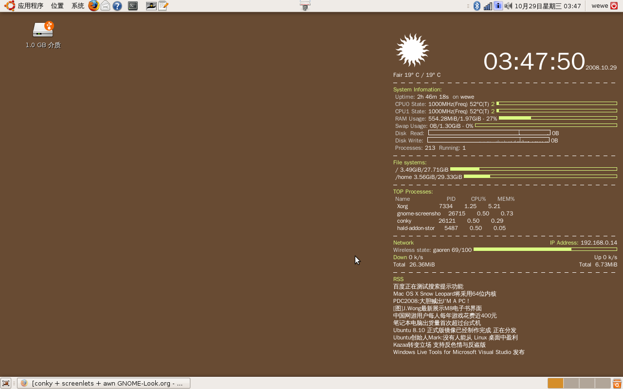

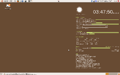

background yes
#font 5x7
#font 6x10
#font 7x13
#font 8x13
#font 9x15
# Use Xft?
use_xft yes
xftalpha 1.0
# out_to_console no
# MPD host/port
# mpd_port 6600
# out_to_console no
# mail spool
#mail_spool $MAIL
update_interval 2.0
total_run_times 0
own_window yes
double_buffer yes
minimum_size 400 5
# Draw shades?
draw_shades no
# Draw outlines?
draw_outline no
draw_borders no
# Stippled borders?
stippled_borders 8
# border margins
border_margin 4
# border width
border_width 1
default_color white
#alignment top_left
alignment top_right
#alignment none
gap_x 12
gap_y 40
no_buffers yes
uppercase no
cpu_avg_samples 2
net_avg_samples 2
use_spacer no
#max_specials 512
TEXT
${font weather:size=80}${execi 600 ~/scripts/conditions.sh} $alignr ${font Zekton:style=Bold:pixelsize=50}${alignc}${time %H:%M:%S}${font Zekton:size=9}${time %Y.%m.%d}${color}
${color slate grey}${font}${color}${font}${execi 1800 ~/scripts/pogodynka.sh}
$stippled_hr
 ${color lightgrey}Disk  Read:  ${color}${diskiograph_read /dev/sda 10,250 000000 ffffff} ${color}$diskio_read
 ${color lightgrey}Disk Write:  ${color}${diskiograph_write /dev/sda 10,250 000000 ffffff} ${color}$diskio_write
$color$stippled_hr
$color$stippled_hr
$stippled_hr
$stippled_hr
${color #dcff82}RSS
又偷了一个,添加了天气和时间 :em06
Screenshot.png [ 142.34 KiB | 被浏览 10920 次 ]
