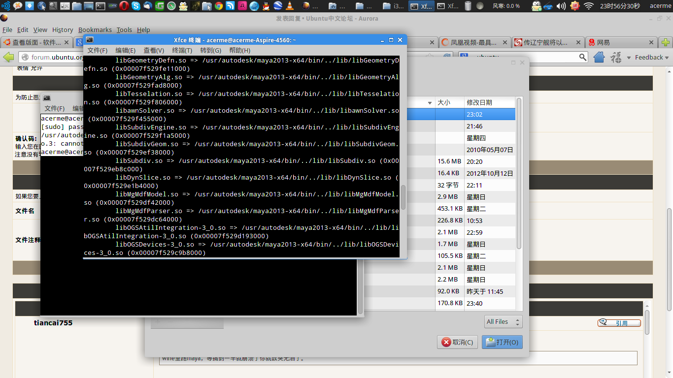

acerme@acerme-Aspire-4560:~$ sudo /usr/autodesk/maya/bin/maya[sudo] password for acerme:
/usr/autodesk/maya/bin/maya.bin: error while loading shared libraries: libtiff.so.3: cannot open shared object file: No such file or directory
