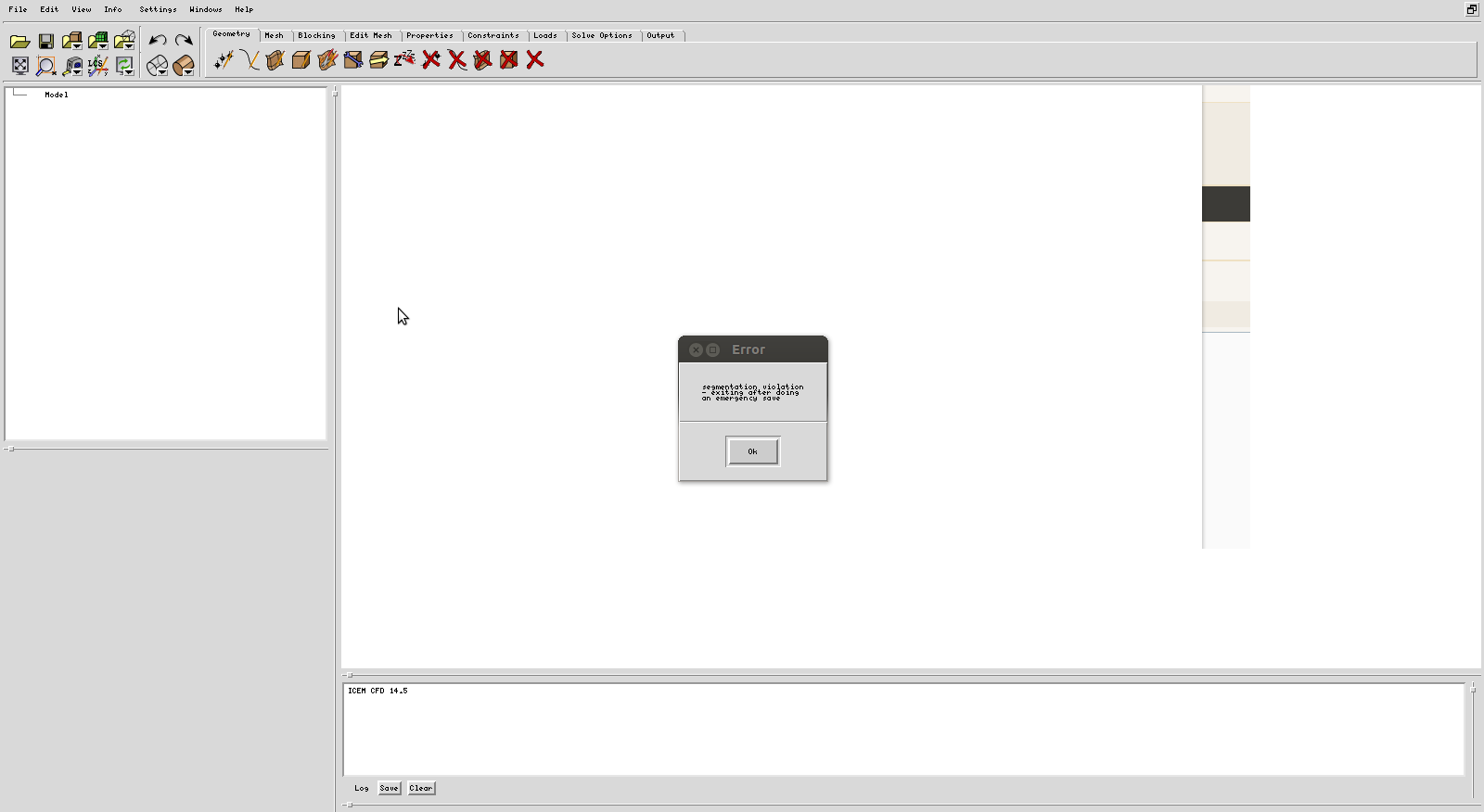

恩,我在ubuntu中安装了ansys14.5,各个模块一切运行正常,但是ICEM CFD启动后却又异常出现
命令窗口的错误代码输出情况如下所示:
ICEM_ACN is "/usr/ansys_inc/v145/icemcfd/linux64_amd".
ANSYSLIC_DIR is set to /usr/ansys_inc/shared_files/licensing
args =
Missing font family helvetica
Window information: depth = 24
class = 4
visual depth = 24 class = 4
can't load font screen14, using variable
Signal 11 caught!
segmentation violation - exiting after doing an emergency save
deleting viewer .v.f1.frame.p3.f0.frame.view:
从上面红色标注的部分,仿佛是字体出了问题,请问诸位,你们是否遇到这个问题呢,是如何解决的呢?
文件注释: 这是启动ICEM CFD时发生错误时的屏幕截图
屏幕截图.png [ 32.91 KiB | 被浏览 1780 次 ]

原因是缺少字体,所以还要sudo apt-get install xfonts-75dpi xfonts-100dpi
