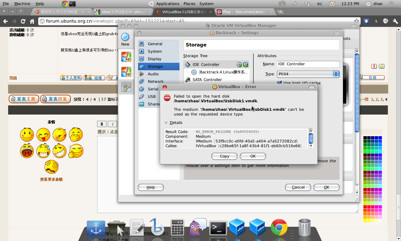

帖子: 120
Failed to open the hard disk /home/zhao/.VirtualBox/UsbDisk1.vmdk.
The medium '/home/zhao/.VirtualBox/UsbDisk1.vmdk' can't be used as the requested device type.
Result Code:
NS_ERROR_FAILURE (0x80004005)
Component:
Medium
Interface:
IMedium {53f9cc0c-e0fd-40a5-a404-a7a5272082cd}
Callee:
IVirtualBox {c28be65f-1a8f-43b4-81f1-eb60cb516e66}
59 楼
 文章标题 : Re: VirtualBox从USB设备启动方法
帖子发表于 : 2012-03-09 12:27
注册: 2011-10-02 21:06
帖子: 120
求解决。。已经成功创建了硬盘文件,u盘是不是先要unmount一下?
