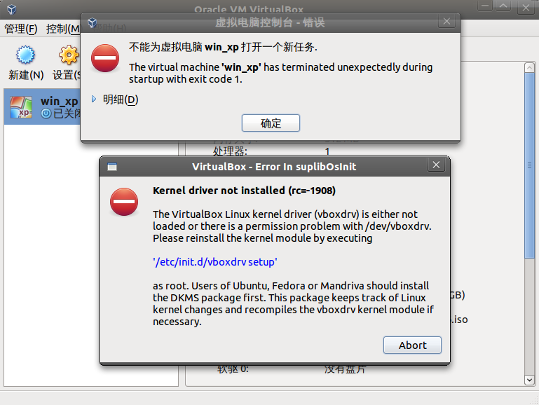

以前用的好好的,好像是升级ubuntu10.10后开启virtualbox时弹出一个对话框,我没看就点了,后来开启就出现如图错误。
在终端运行/etc/init.d/vboxdrv setup后出现
* Stopping VirtualBox kernel modules
* done.
* Uninstalling old VirtualBox DKMS kernel modules
/etc/init.d/vboxdrv: 388: cannot create /var/log/vbox-install.log: Permission denied
* done.
* Trying to register the VirtualBox kernel modules using DKMS
* Failed, trying without DKMS
* Recompiling VirtualBox kernel modules
* Look at /var/log/vbox-install.log to find out what went wrong
然后不知怎么弄了。 :em20

sudo /etc/init.d/vboxdrv setup

* Stopping VirtualBox kernel modules * done.
* Uninstalling old VirtualBox DKMS kernel modules * done.
Error! Your kernel headers for kernel 2.6.32-24-generic cannot be found at
/lib/modules/2.6.32-24-generic/build or /lib/modules/2.6.32-24-generic/source.
还是不行,/var/log/vbox-install.log里如下:
Uninstalling modules from DKMS
removing old DKMS module vboxhost version 3.2.10
Deleting module version: 3.2.10
completely from the DKMS tree.
Done.
Attempting to install using DKMS
Creating symlink /var/lib/dkms/vboxhost/3.2.10/source ->
/usr/src/vboxhost-3.2.10
DKMS: add Completed.
You can use the --kernelsourcedir option to tell DKMS where it's located, or you could install the linux-headers-2.6.32-24-generic package.
Failed to install using DKMS, attempting to install without
Makefile:159: *** Error: unable to find the sources of your current Linux kernel. Specify KERN_DIR=<directory> and run Make again。 停止。

貌似没安装好内核的header
麻烦贴一下下面的命令看看:
uname -r
dpkg -l | grep linux-headers

引用:
装内核的头文件,然后再运行这个命令

acid303 写道:
貌似没安装好内核的header
麻烦贴一下下面的命令看看:
uname -r
uname -r
2.6.32-24-generic
ii linux-headers-2.6.35-22 2.6.35-22.34 Header files related to Linux kernel version 2.6.35
ii linux-headers-2.6.35-22-generic 2.6.35-22.34 Linux kernel headers for version 2.6.35 on x86/x86_64
ii linux-headers-generic 2.6.35.22.23 Generic Linux kernel headers

你什么升级10.10的了还用10.04的内核啊,删除

那重启进 2.6.35-22那个内核就行了

按shift后显示:
Ubuntu,with linux 2.6.32-24-generic
Ubuntu,with linux 2.6.32-24-generic(recovery mode)
Memory test(memtest 86+)
Memory test(memtest 86+,serial console 115200)
没有2.6.35-22的。。。 :em20

可能是因为从10.04升级到10.10内核有问题,重装后内核就变为2.6.35-22了,也可以用virtualbox了。
看来升级还是直接安装好。

额...解决就好,其实你可以先update-grub一下,没有那个内核的话再手动安装也可以,确定有那个内核了,重起,按shift键,然后选35那个内核,进去 删除就内核
