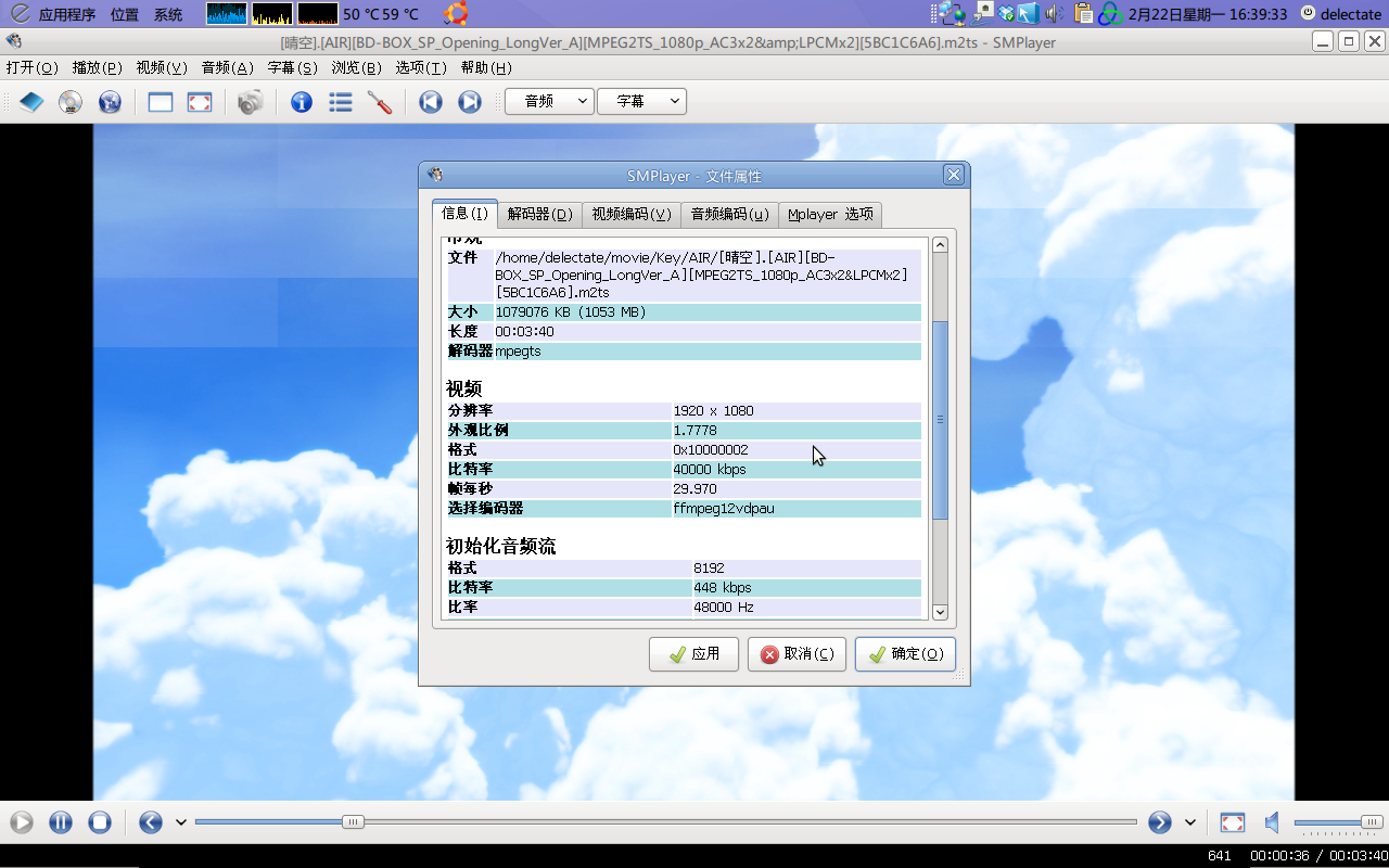

what's ffmpeg12vdpau?
smplayer,video output : vdpau
but,what's ffmpeg12vdpau?
as fat as i know,MPEG don't have standard mpeg12
so...what's ffmpeg12?

Re: what's ffmpeg12vdpau?
FFmpeg MPEG-1/2(VDPAU)?
identify,it is mpeg2,but mplayer use ffmpeg12vdpau to decode video streambodhi 写了:FFmpeg MPEG-1/2(VDPAU)?
because it is a m2ts file,so video stream usually is encode by mpeg2 ,not h264
"m2ts" is a kind of container like mkv/avi/ts/tp and so on which can also package H.264/VC-1 video stream inside itself.delectate 写了:identify,it is mpeg2,but mplayer use ffmpeg12vdpau to decode video streambodhi 写了:FFmpeg MPEG-1/2(VDPAU)?![]()
you're rightFreesnake 写了:"m2ts" is a kind of container like mkv/avi/ts/tp and so on which can also package H.264/VC-1 video stream inside itself.delectate 写了:identify,it is mpeg2,but mplayer use ffmpeg12vdpau to decode video streambodhi 写了:FFmpeg MPEG-1/2(VDPAU)?![]()
but this m2ts file i download is mpeg2
i recheck it by mediainfo,i am right
it's mpeg2
but,why it called ffmpeg12vdpau?
Ask ffmpeg development team directly by mailing list or IRC.delectate 写了:you're rightFreesnake 写了:"m2ts" is a kind of container like mkv/avi/ts/tp and so on which can also package H.264/VC-1 video stream inside itself.delectate 写了:identify,it is mpeg2,but mplayer use ffmpeg12vdpau to decode video streambodhi 写了:FFmpeg MPEG-1/2(VDPAU)?![]()
it's mpeg2
sighFreesnake 写了:Ask ffmpeg development team directly by mailing list or IRC.delectate 写了:you're rightFreesnake 写了:"m2ts" is a kind of container like mkv/avi/ts/tp and so on which can also package H.264/VC-1 video stream inside itself.delectate 写了:identify,it is mpeg2,but mplayer use ffmpeg12vdpau to decode video streambodhi 写了:FFmpeg MPEG-1/2(VDPAU)?![]()
it's mpeg2
my fault
I don't think mpeg1 need hardware acceleration. It's mainly used in VCD which can be decoded very well even by a Pentium3 processor.delectate 写了:sighFreesnake 写了:Ask ffmpeg development team directly by mailing list or IRC.delectate 写了:you're rightFreesnake 写了:"m2ts" is a kind of container like mkv/avi/ts/tp and so on which can also package H.264/VC-1 video stream inside itself.delectate 写了:identify,it is mpeg2,but mplayer use ffmpeg12vdpau to decode video streambodhi 写了:FFmpeg MPEG-1/2(VDPAU)?![]()
it's mpeg2
my fault

And then, most of modern NV cards support mpeg1 acceleration in a bad way - don't support VLD-level hardware acceleration. That might lead many errors when decoding.

maybe decode mpeg1 and mpeg2 use the same way?
so they named it ffmpeg12vdpau
My Card...only IDCT is supported
D V DT mpeg1video_vdpau MPEG-1 video (VDPAU acceleration)
D V DT mpegvideo_vdpau MPEG-1/2 video (VDPAU acceleration)
MPEG1&2 encoding method are similar, but requires different FPS&resolution.
When decoding, they think these two are similar.= =
My ATI HD card only support MPEG12 IDCT...No VLDFreesnake 写了:What's your card?zhu527812567 写了:My Card...only IDCT is supported
but the IDCT can not give the processor any pressure..
