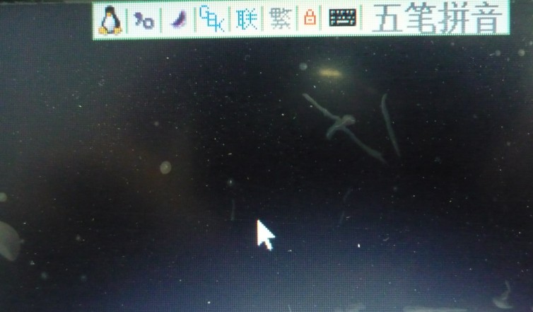

Ubuntu登录X桌面异常,表现为登录后黑屏,只显示一个鼠标及输入法(见图)
请教了,试过坛子中的一些方法,如重装Gnome等,均不可- eexpress

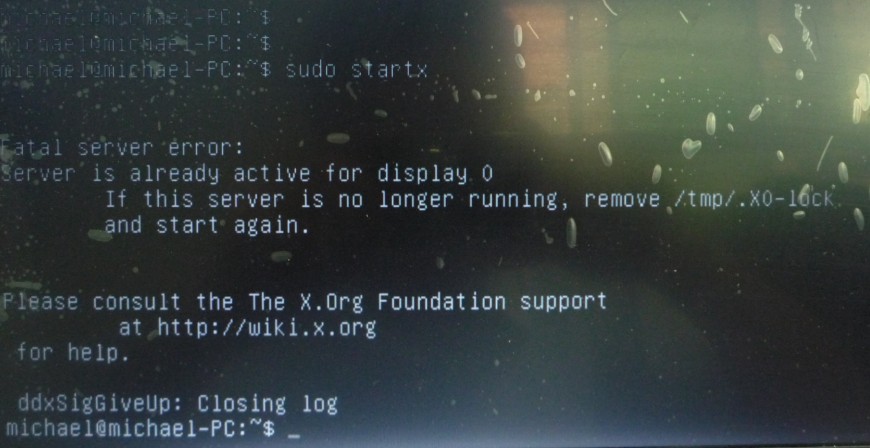

执行sudo startx则:
sauth: error in locking authority file /home/michael/.Xauthority
X: warning; process set to priority -1 instead of requested priority 0
Fatal server error:
Server is already active for display 0
If this server is no longer running,remove /tmp/.XO-lock
and start again.
Please consult the The X.Org Foundation support
at http://wiki.x.org
for help.
ddxSigGiveUp: Closing log
Invalid MIT-MAGIC-COOKIE-L keygiving up.
xinit: Resource temporarily unavailable (errno 11): unable to connect to X server
xinit: No such process (errno 3): Server error.

3楼所示:
1、桌面启动失败,但X启动成功了。X启动成功的理由就是看到了鼠标。
2、sudo startx必定是失败的。这个命令是手动启动X的命令。失败的原因是X已经成功启动了。
