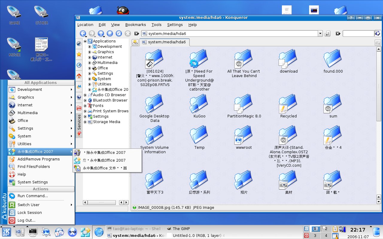

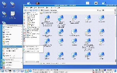

使用amarok播放mp3文件,amarok提示要安装支持软件,直接点确定,等更新完成后系统出现乱码。有的字显示为点,网页显示正常
如图,修改locale不能成功,求高人帮助。
是不是字体问题。从新安装wqy也不行。

还有,安装字体文件或者中文支持的时候提示
perl: warning: Setting locale failed.
perl: warning: Please check that your locale settings:
LANGUAGE = "zh_CN:zh:en_US:en",
LC_ALL = (unset),
LC_CTYPE = " "zh_CN.UTF-8",",
LC_ALL = " (unset),",
LANG = "zh_CN.UTF-8"
are supported and installed on your system.
perl: warning: Falling back to the standard locale ("C").
请问有人知道么,还有
tao@tao-laptop:/var/lib/locales/supported.d$ locale
locale: Cannot set LC_ALL to default locale: No such file or directory
LANG=zh_CN.UTF-8

装过了,问题不能解决,但装的过程中提示
LC_ALL = (unset),
我试过改了locale了但都还是这样.郁闷了

你的local出问题了,不知道是不是你手工改导致的.
sudo dpgk-reconfigure locales zh_CN.UTF8 看看行不行.
