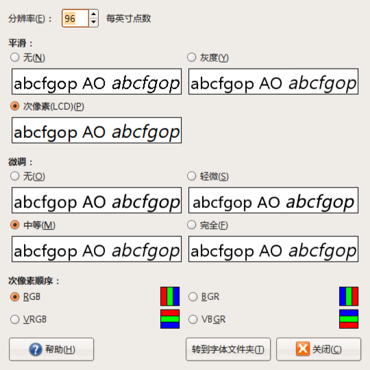

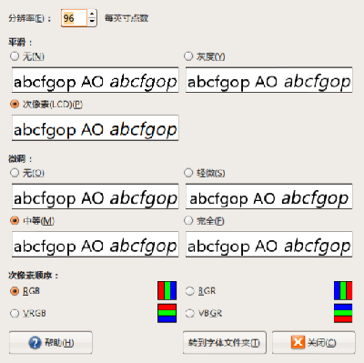

是不是要改 /etc/fonts/local.conf 呢?
要怎么改呢?
<?xml version="1.0"?>
<!-- /etc/fonts/local.conf file to configure system-wide font access -->
<fontconfig>
Target dots per inch.
Uncomment following block and change 96 to your LCD or CRT actual dpi
<match target="pattern" >
<edit name="dpi" mode="assign" >
<double>90</double>
</edit>
</match>
Enable LCD sub-pixel rendering.
Pay attention, subpixel rendering is exploited only on LCD not CRT.
Enable it will add some color fringing on the edge of font.It is not
always a bad thing,please sit away from your screen further enough
untill you can't observe the fringing.
Some people's LCD subpixel layout that is not rgb order will get
opposite result,there are four patterns horizontal rgb/bgr and
vertical rgb/bgr, but horizontal rgb is the most common.
Change rgb -> yours.
If you are using CRT, you may benefit from it.
If it disturb you or you prefer to the normal grayscale antialiasing,
change rgb -> none and you should also disable it for each place it
appear.
If you are using LCD, i recommand you enable it, or you can't enjoy ClearType-like
looking.
<match target="font" >
<edit name="rgba" mode="assign" >
<const>rgb</const>
</edit>
</match>
Default Fonts setting for those free fonts that probably have been existed
in your system, e.g. ttf-bitstream-vera and ttf-dejavu etc.
MS Vista fonts will not use this setting.
<edit name="antialias" mode="assign" >
<bool>true</bool>
</edit>
<edit name="autohint" mode="assign" >
<bool>true</bool>
</edit>
<edit name="hinting" mode="assign" >
<bool>false</bool>
</edit>
<edit name="hintstyle" mode="assign" >
<const>hintslight</const>
</edit>
</match>
要怎么改呢?
<fontconfig>
<double>90</double>
</edit>
</match>
appear.
looking.
<const>rgb</const>
</edit>
</match>
<bool>true</bool>
</edit>
<bool>true</bool>
</edit>
<bool>false</bool>
</edit>
</edit>
</match>
