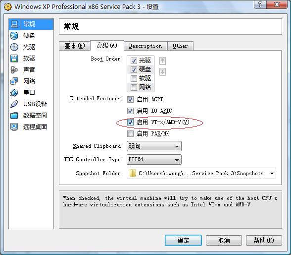

刚才用VirtualBox安装Ubuntu 8.10 x64版也遇到这个问题了。像下图这样设置就行了。
因为Ubuntu正在安装,不能进行设置,所以截图里用的是XP,但对Ubuntu有效。
当然你的CPU必须是64位的且支持Intel或AMD的虚拟化技术,可能还需要在CMOS设置里打开虚拟化选项。
我的CPU是Athlon64 X2 5000+。

我也遇到了这个,查了好多资料,终于到找原因了(https://answers.launchpad.net/ubuntu/+s ... tion/48333)
这个不是ubuntu的问题,个人觉得应该是virtualBox还不够好,导致这么多问题,用vmware就不会有这些问题了
(可惜vmware要收费)
一般来说,用virtualBox安装64bit的虚拟机:(http://forums.virtualbox.org/viewtopic.php?t=8669):
1. You need a 64-bit processor with hardware virtualization support (see User Manual chapter 1.2, Software vs. hardware virtualization (VT-x and AMD-V), page 10) and a 64-bit host operating system.
1: 64位的cpu(带硬件虚拟化支持)和64位的操作系统
2. You must run a 64-bit version of VirtualBox on that OS (Windows Vista, Linux or OpenSolaris). This can then run both 32-bit and 64-bit VMs; a 32-bit VirtualBox can only run 32-bit VMs, regardless of the hardware.
2:必须运行64位的VirtualBox,才可以装32位或64位的虚拟机;32位的VirtualBox只能装32位的虚拟机,而不论硬件是否支持64位
3. You must enable hardware virtualization; software virtualization is not supported for 64-bit VMs.
3:你必须允许硬件虚拟化;软件虚拟化是不支持64位虚拟机
So, running 64-bit guest require:
所以,运行64位的虚拟机需要
- hardware virtualization support in your CPU (called VT-x by Intel and AMD-V by AMD)
-cpu支持硬件虚拟化(intel的叫VT-x,amd的叫AMD-V)(下面的url可以查询你的cpu是否支持)
http://vmetc.com/2008/07/14/how-to-chec ... alization/
- you need to make sure it is not turned off by your BIOS (steps depends on your motherboard)
-确定该功能(硬件虚拟化)没有被BIOS关闭(步骤取决于主板)
- make sure it is enabled in virtual box settings of your machine (Settings --> Advanced --> check Enable VX-t/AMD-V)
-确定virtualBox可以在你的机器上设置(设置-》高级-》启用VX-t/AMD-v)

虚拟机上开了VX-t/AMD-v能装64位了.
