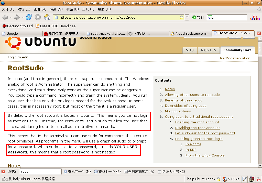

BigSnake.NET 写道:
goldfox_79 写道:
孤笑客 写道:
一开始ROOT密码是随机的,那我怎么改??
谁给你讲的,误人子弟啊!
刚一装好的ubuntu,root帐号的密码=你在安装过程中创建的那个帐号的密码!
你才是误人子弟
root密码是随机的
取得root权限,请用sudo
我不知道这个关于root密码是随机的说法是怎么传起来的,看正版说明!
root password.png [ 123.14 KiB | 被浏览 6927 次 ]
http://www.pandabang.info

goldfox_79 写道:
BigSnake.NET 写道:
goldfox_79 写道:
孤笑客 写道:
谁给你讲的,误人子弟啊!
你才是误人子弟
root密码是随机的
取得root权限,请用sudo
剛才去看了一下 ,果然不是隨機
bigsnake-net@bigsnake-host:~$ sudo cat /etc/shadow | grep root
root:*:<不重要>:<不重要>:<不重要>:<不重要>:::
第2個域的 * 說明賬戶被禁用 ,而不是加了隨機密碼
那麽 sudo 是怎麽回事呢?
$man sudo
然後看這裏
DESCRIPTION
sudo allows a permitted user to execute a command as the superuser or
another user, as specified in the sudoers file. The real and effective
uid and gid are set to match those of the target user as specified in
the passwd file and the group vector is initialized based on the group
file (unless the -P option was specified). If the invoking user is
root or if the target user is the same as the invoking user, no pass‐
word is required. Otherwise, sudo requires that users authenticate
themselves with a password by default (NOTE: in the default configura‐
tion this is the user’s password, not the root password). Once a user
has been authenticated, a timestamp is updated and the user may then
use sudo without a password for a short period of time (15 minutes
unless overridden in sudoers).
注意
所以sudo用的是 運行sudo的用戶的密碼
至于所謂的控制台登錄,經測試再控制台(CTRL+ALT+F1)用root登錄,是肯定失敗的,su程序的表現也是如此
