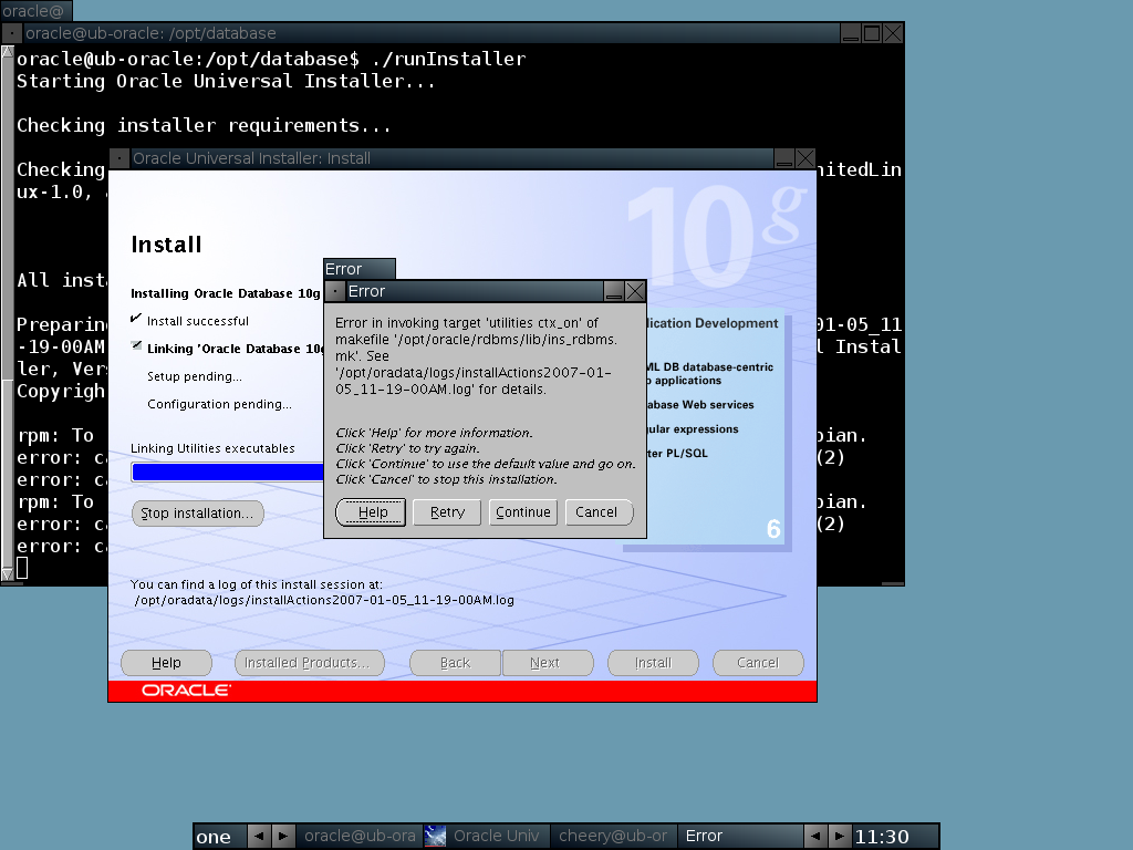

注意libc-dev,装到62%就除了一个link错误的多数因为少这个包。

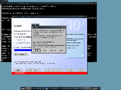

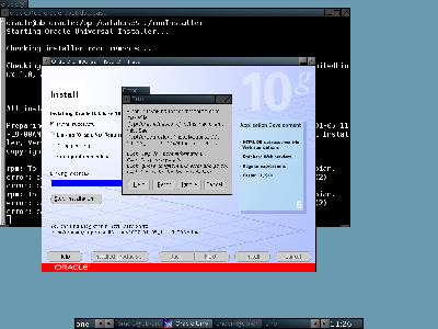

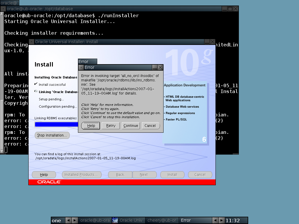

比较慢,慢慢等。中间会有两个编译错误,据说因为libaio版本的问题,可以忽略,所以直接continue。

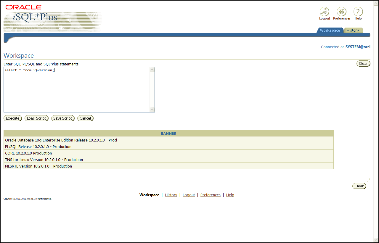

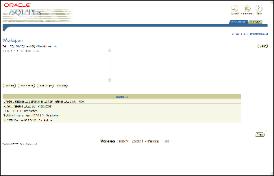

5 测试一下
最后的安装画面会给你企业管理器,isqlplus的网址。

I am not sure about the first linking error. I never saw it before and I need the install log to give you more information. Most likely it only depends on your environment.
But for the second one, it is a known issue since ubuntu is not configured as real Enterprise Linux, there is some assumption from Oracle about your linux.
When you faced this linking error, or better before you start installnation, you should do the following as 'oracle' user:
export LD_LIBRARY_PATH=$ORACLE_HOME/lib
ln ­-s /usr/bin/basename /bin/basename
ln ­-s $ORACLE_HOME/lib/libclient10.a $ORACLE_HOME/lib/libagtsh.a
/* Run the following shell command */
$ORACLE_HOME/bin/genagtsh $ORACLE_HOME/lib/libagtsh.so 1.0
That linking error will gone.
