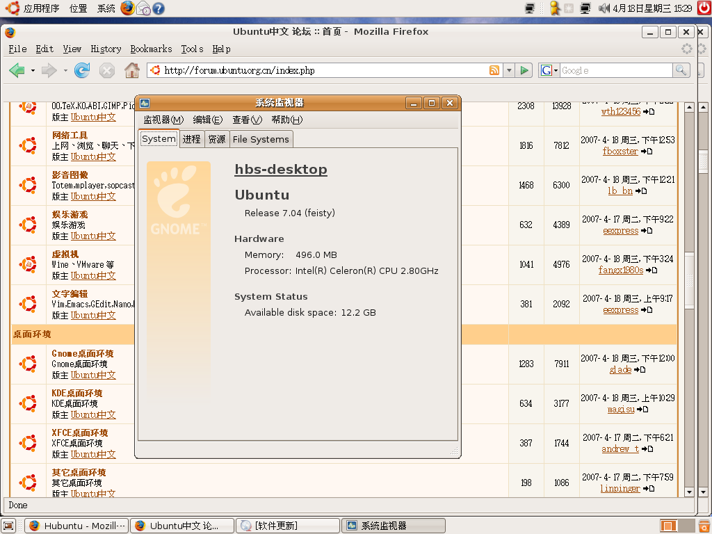

由 toawinner47 » 2007-04-18 15:24
install again / 8.2G /home 7.5G swap 1 G why question now?????
windywinter
- 帖子: 192
- 注册时间: 2007-02-17 12:24
帖子
由 windywinter » 2007-04-18 15:49
toawinner47 写了:install again / 8.2G /home 7.5G swap 1 G why question now?????
???没看到有什么问题啊
