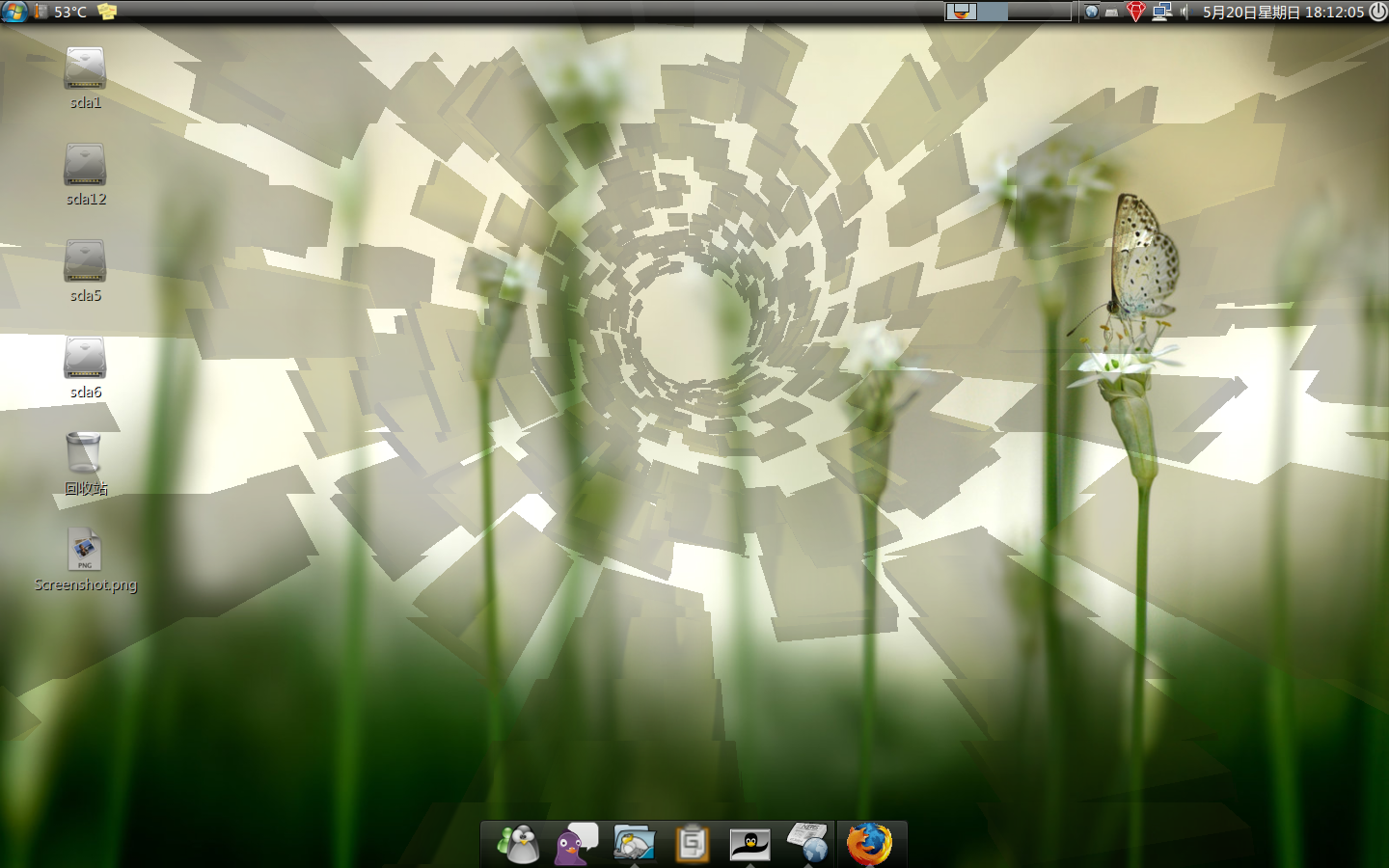

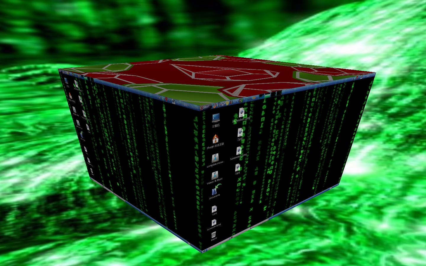

1。使用屏保来装点桌面

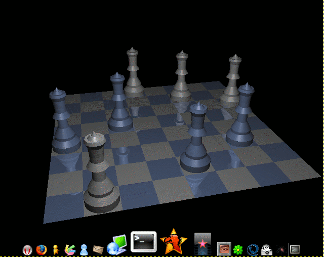

一些例子:
xwinwrap -ni -argb -fs -s -st -sp -b -nf -o .5 -- /usr/lib/xscreensaver/lavalite -root -window-id WID #puts xscreensaver lavalite on desktop, partially transparent
xwinwrap -ni -argb -fs -s -st -sp -a -nf -- /usr/lib/xscreensaver/glmatrix -window-id WID #runs matrix screensaver in foreground
xwinwrap -ni -o 0.6 -fs -s -st -sp -b -nf -- mplayer -wid WID -quiet movie.mpg #play movie.mpg with no window
xwinwrap -ni -argb -fs -s -st -sp -b -nf -- q3demo -window-id WID #cool if quake demo is installed

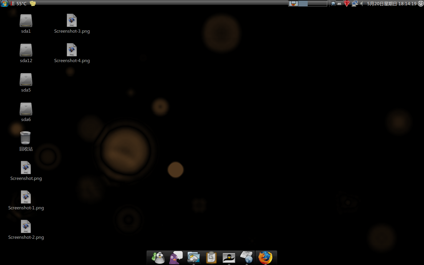

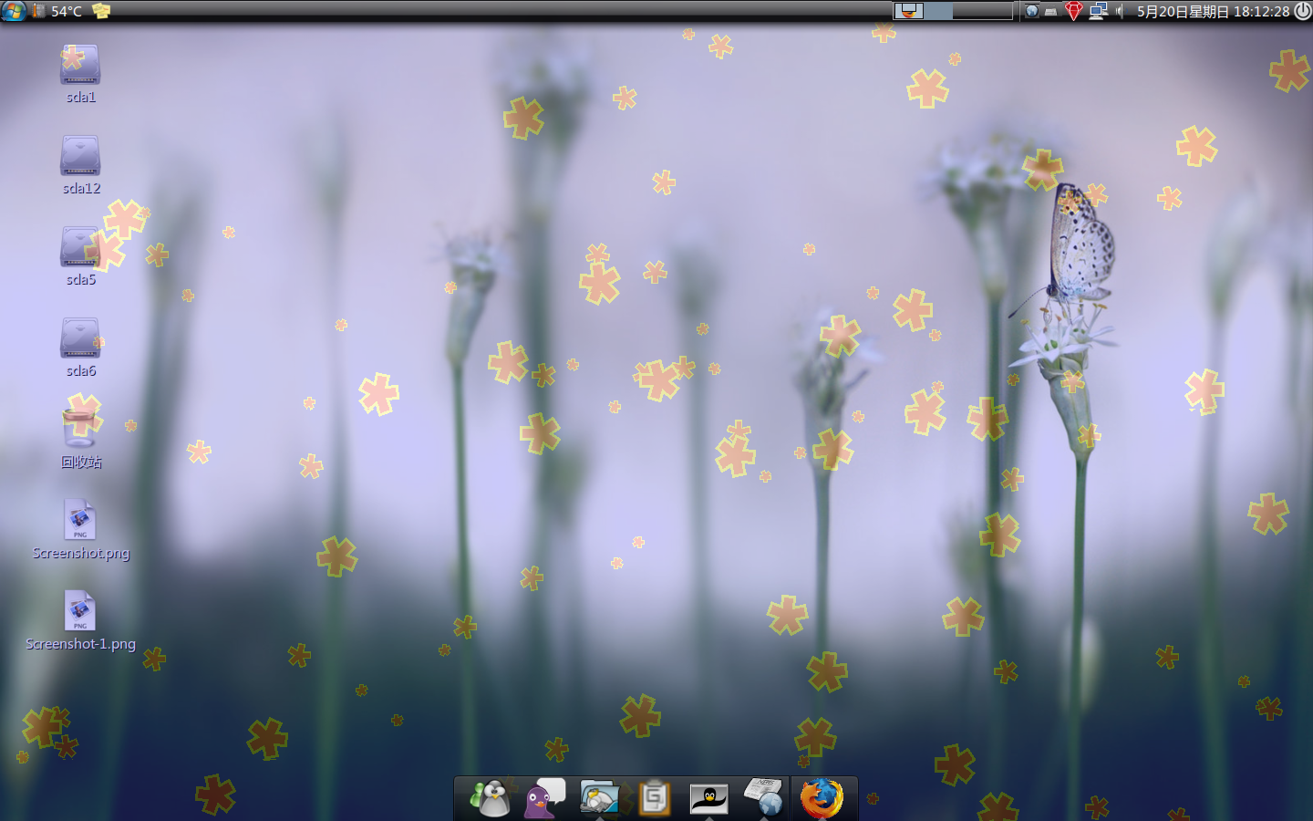

Atlantis: xwinwrap -o 0.3 -ni -argb -fs -s -st -sp -b -nf -- /usr/lib/xscreensaver/atlantis -window-id WID -delay 10000 -texture -gradient
Blocktube: xwinwrap -o 0.3 -ni -argb -fs -s -st -sp -b -nf -- /usr/lib/xscreensaver/blocktube -window-id WID -delay 10000 -visual 1
Flurry: xwinwrap -o 0.3 -ni -argb -fs -s -st -sp -b -nf -- /usr/lib/xscreensaver/flurry -window-id WID
Fuzzy Flakes: xwinwrap -o 0.3 -ni -argb -fs -s -st -sp -b -nf -- /usr/lib/xscreensaver/fuzzyflakes -window-id WID -color black
Halftone: xwinwrap -o 0.3 -ni -argb -fs -s -st -sp -b -nf -- /usr/lib/xscreensaver/halftone -window-id WID -colors 1 -cycle-speed 1000
Matrix: xwinwrap -o 0.3 -ni -argb -fs -s -st -sp -b -nf -- /usr/lib/xscreensaver/glmatrix -window-id WID -delay 10000 -speed 0.4 -density 8 -fog -rotate -waves
Ripples: xwinwrap -o 0.3 -ni -argb -fs -s -st -sp -b -nf -- /usr/lib/xscreensaver/ripples -window-id WID
Starwars: xwinwrap -o 0.3 -ni -argb -fs -s -st -sp -b -nf -- /usr/lib/xscreensaver/starwars -window-id WID
Starwars (just the starfield): xwinwrap -o 0.3 -ni -argb -fs -s -st -sp -b -nf -- /usr/lib/xscreensaver/starwars -window-id WID -lines 0
