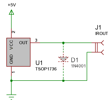

This driver supports the IR-audio IR receiver module. A more detailed description of how to build and set up the hardware can be found by following the link.

没事作的家伙,都可以测试。那二极管不需要的。
