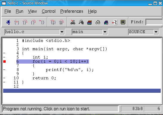

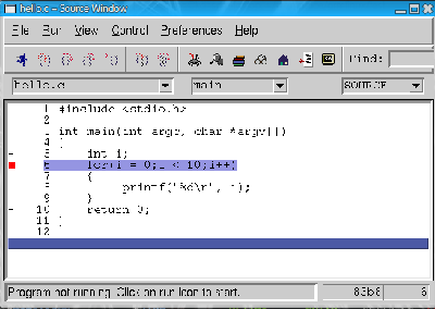

kanson@kanson:~/workspace$ arm-linux-insight hello
启动arm-linux-insight软件如图1所示

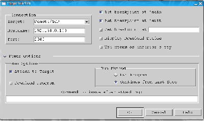

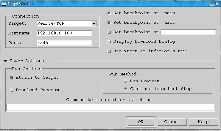

Files->Target Settings
如下图2设置
