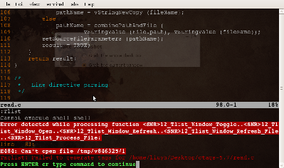

在vim下如果使用Tlist,就会出现如下错误信息:
:Tlist
Cannot execute shell shell
Error detected while processing function <SNR>12_Tlist_Window_Toggle..<SNR>12_Tl
ist_Window_Open..<SNR>12_Tlist_Window_Refresh..<SNR>12_Tlist_Window_Refresh_File
..<SNR>12_Tlist_Process_File:
line 83:
E484: Can't open file /tmp/v846940/1
Taglist: Failed to generate tags for /home/liuyh/Desktop/ctags-5.7/sml.c
Press ENTER or type command to continue

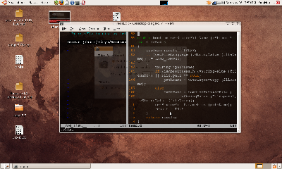

如图所示:
如果按esc取消,则会在屏幕左侧的vertical split出现一行屏幕信息,而没有函数列表。
