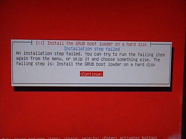

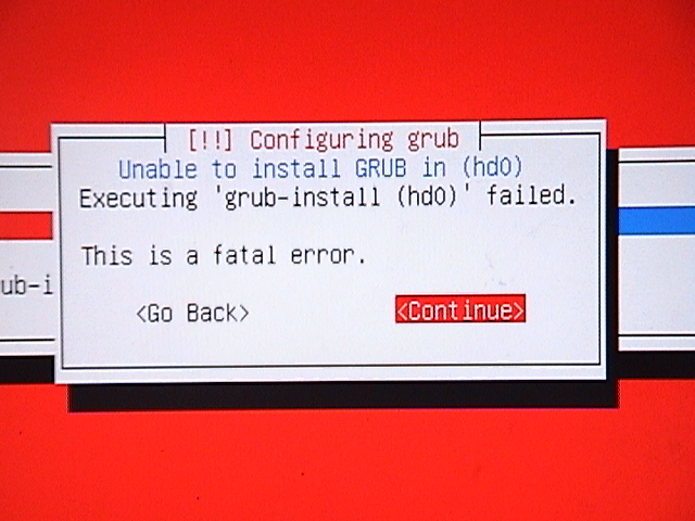

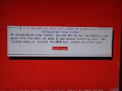

Software Raid0安装到Grub boot loader的时侯失败

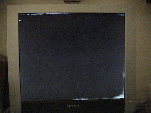

4块SCSI硬盘,按照步骤设置好了Raid0之后,接下来安装,一直到“Install the GRUB boot loader on a hard disk"这一步出错,如图所示,然后我继续安装,continue to install without grub boot. 安装完了之后重启,光标就在黑黑的屏幕上闪,没有任何提示,也不知道如何进入命令界面,请指点

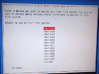

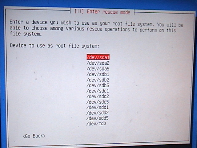

Re: Software Raid0安装到Grub boot loader的时侯失败
[Enter rescue mod]
Enter a device you wish to use as your root file system. You will be able to choose among various rescue operations to perform on this file system.
Device to use as root file system:
/dev/sda1
/dev/sda2
/dev/sda5
/dev/sdb1
/dev/sdb2
/dev/sdb5
/dev/sdc1
/dev/sdc2
/dev/sdc5
/dev/sdd1
/dev/sdd2
/dev/sdd5
/dev/md0
/dev/sda1
/dev/sda2
/dev/sda5
/dev/sdb1
/dev/sdb2
/dev/sdb5
/dev/sdc1
/dev/sdc2
/dev/sdc5
/dev/sdd1
/dev/sdd2
/dev/sdd5
/dev/md0
