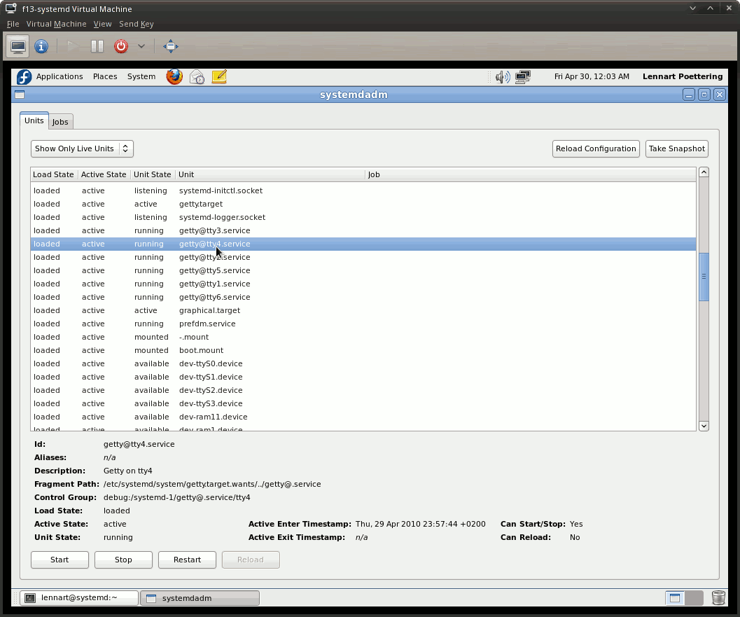

Even simpler than downloading and booting the qemu image is looking at pretty screen-shots. Since an init system usually is well hidden beneath the user interface, some shots of systemadm and ps must do:
That's systemadm showing all loaded units, with more detailed information on one of the getty instances.

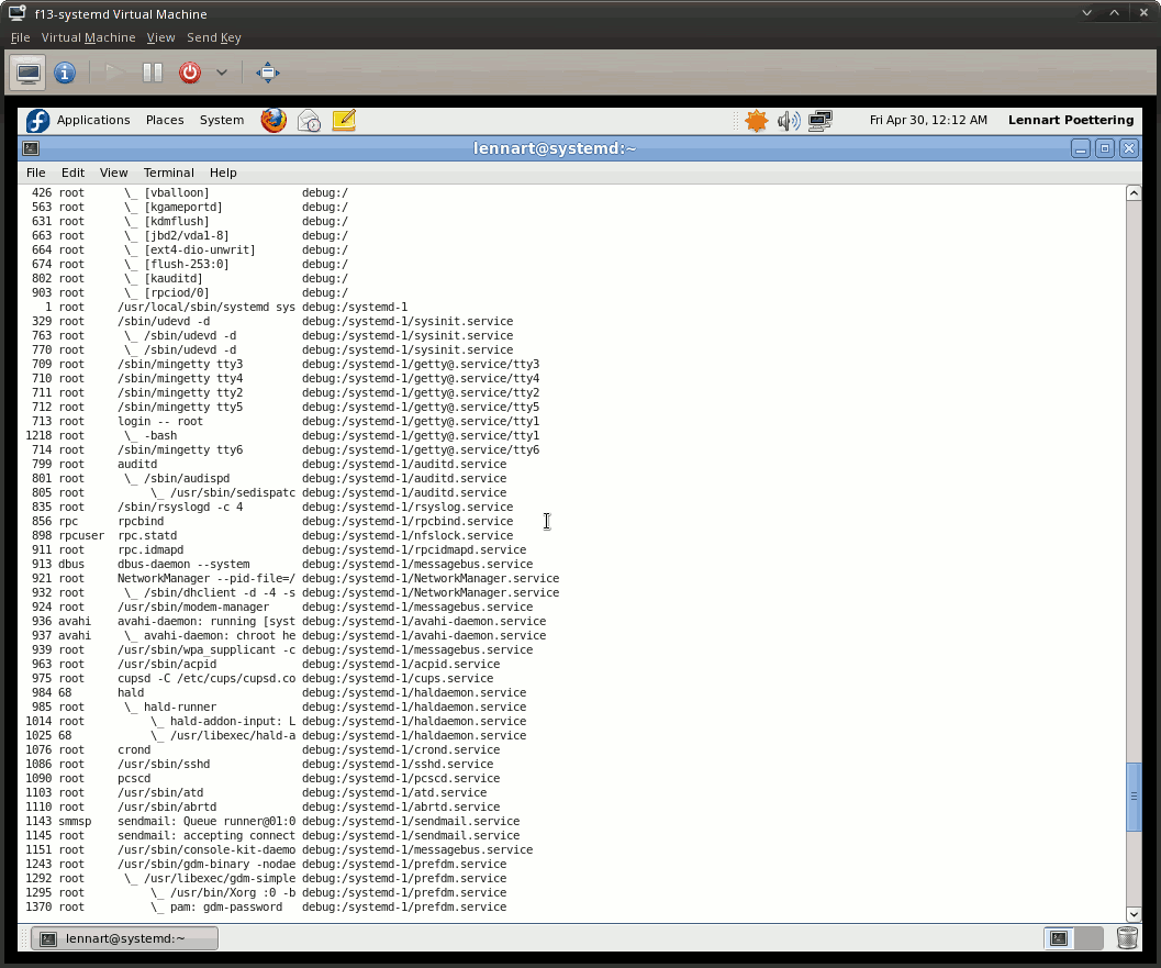

That's an excerpt of the output of ps xaf -eo pid,user,args,cgroup showing how neatly the processes are sorted into the cgroup of their service. (The fourth column is the cgroup, the debug: prefix is shown because we use the debug cgroup controller for systemd, as mentioned earlier. This is only temporary.)
Note that both of these screenshots show an only minimally modified Fedora 13 Live CD installation, where services are exclusively loaded from the existing SysV init scripts. Hence, this does not use socket or bus activation for any existing service.
