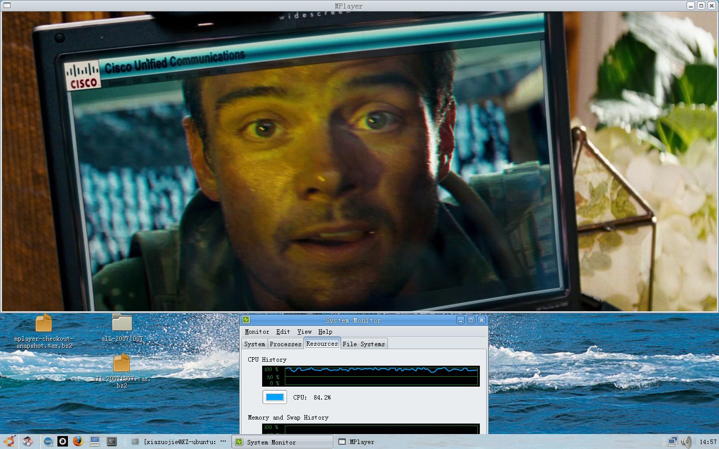

I have Succeeded in using CoreAVC 1.3 in ubuntu 710.
There is an error in the introduction, that is, it is "registercodec -r
$HOME/.mplayer/registry" rather than "registercodec -r
$HOME/.mplayer/registry32".
The following is a screenshot for " Transformers 2007 HDDVD 1080p DTS
x264-CtrlHD(1080p 12.4G)�"�
My CPU is Athlon 3000+ overclocked to 2.6GH.
While playing the movie with mplayer,I have disabled Deinterlacing, Agressive
Deinterlacing, Deblocking, Force VMR AR Correction and enabled frame-dropping.
