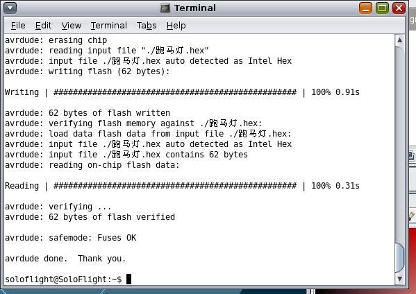

现在就可以烧录AT89S52的单片机了,
例如我想烧录放在桌面上的编译好的跑马灯程序,
用命令
sudo avrdude -p 8052 -c usbasp -e -U flash:w:'./跑马灯.hex' 顺便问下各位大哥们,avr-gcc能编译c51的代码不?我正缺少个编译器。

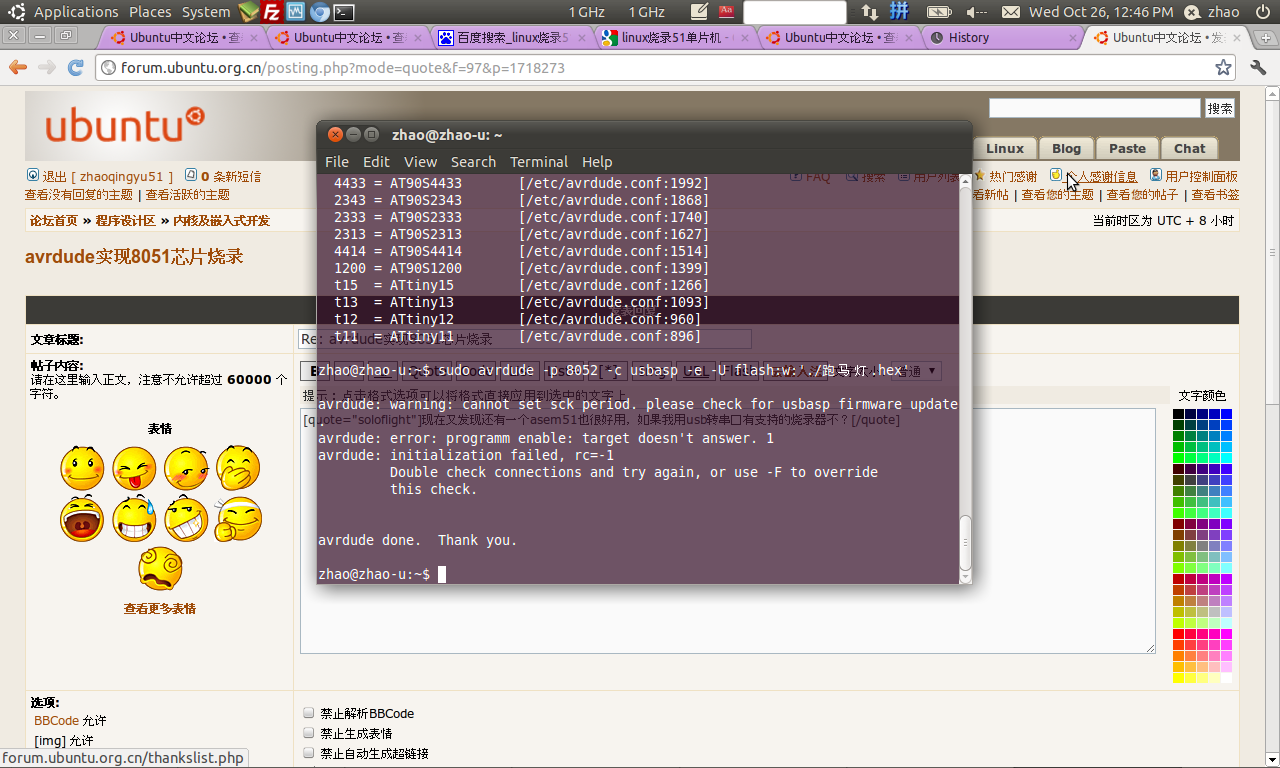

$ avrdude -p 8052 -c stk200 -e -v
avrdude: Version 5.11.1, compiled on Dec 4 2011 at 15:16:50
Copyright (c) 2000-2005 Brian Dean, http://www.bdmicro.com/
Copyright (c) 2007-2009 Joerg Wunsch
System wide configuration file is "/etc/avrdude.conf"
User configuration file is "/home/a/.avrduderc"
Using Port : /dev/parport0
Using Programmer : stk200
AVR Part : AT89S52
Chip Erase delay : 20000 us
PAGEL : P00
BS2 : P00
RESET disposition : dedicated
RETRY pulse : SCK
serial program mode : yes
parallel program mode : yes
Timeout : 200
StabDelay : 100
CmdexeDelay : 25
SyncLoops : 32
ByteDelay : 0
PollIndex : 3
PollValue : 0x53
Memory Detail :
Block Poll Page Polled
Memory Type Mode Delay Size Indx Paged Size Size #Pages MinW MaxW ReadBack
flash 33 12 0 0 no 8192 0 0 4000 9000 0xff 0xff
signature 0 0 0 0 no 3 0 0 0 0 0x00 0x00
Programmer Type : PPI
Description : STK200
VCC = (not used)
BUFF = 4,5
RESET = 9
SCK = 6
MOSI = 7
MISO = 10
ERR LED = 0
RDY LED = 0
PGM LED = 0
VFY LED = 0
avrdude: AVR device not responding
avrdude: initialization failed, rc=-1
Double check connections and try again, or use -F to override
this check.
avrdude done. Thank you.
