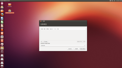

新手求问:安装第三步的安装类型里是空的分区表,如图
安装第三步截图
安装第三步截图
下面是分区的信息 求帮忙啊。。。。非常感谢!!! :em03
sudo fdisk -l
Disk /dev/sda: 2000.4 GB, 2000398934016 bytes
255 heads, 63 sectors/track, 243201 cylinders, total 3907029168 sectors
Units = sectors of 1 * 512 = 512 bytes
Sector size (logical/physical): 512 bytes / 4096 bytes
I/O size (minimum/optimal): 4096 bytes / 4096 bytes
Disk identifier: 0x61f3bb12
Device Boot Start End Blocks Id System
/dev/sda1 63 80324 40131 de Dell Utility
Partition 1 does not start on physical sector boundary.
/dev/sda2 * 81920 32940031 16429056 7 HPFS/NTFS/exFAT
/dev/sda3 32940032 242653183 104856576 7 HPFS/NTFS/exFAT
/dev/sda4 242653184 3907018751 1832182784 f W95 Ext'd (LBA)
/dev/sda5 242655232 1310154751 533749760 7 HPFS/NTFS/exFAT
/dev/sda6 1310156800 2334154751 511998976 7 HPFS/NTFS/exFAT
/dev/sda7 2334156800 3907016703 786429952 7 HPFS/NTFS/exFAT
Disk /dev/sdb: 32.0 GB, 32017047552 bytes
255 heads, 63 sectors/track, 3892 cylinders, total 62533296 sectors
Sector size (logical/physical): 512 bytes / 512 bytes
I/O size (minimum/optimal): 512 bytes / 512 bytes
Disk identifier: 0xba000000
Disk /dev/sdb doesn't contain a valid partition table
Disk /dev/sdc: 2111 MB, 2111832064 bytes
63 heads, 62 sectors/track, 1055 cylinders, total 4124672 sectors
Disk identifier: 0x00000000
/dev/sdc1 * 64 4124671 2062304 6 FAT16
su
sudo parted /dev/sda print
Model: ATA ST2000DM001-9YN1 (scsi)
Disk /dev/sda: 2000GB
Sector size (logical/physical): 512B/4096B
Partition Table: msdos
Number Start End Size Type File system Flags
1 32.3kB 41.1MB 41.1MB primary fat16 diag
2 41.9MB 16.9GB 16.8GB primary ntfs boot
3 16.9GB 124GB 107GB primary ntfs
4 124GB 2000GB 1876GB extended lba
5 124GB 671GB 547GB logical ntfs
6 671GB 1195GB 524GB logical ntfs
7 1195GB 2000GB 805GB logical ntfs
