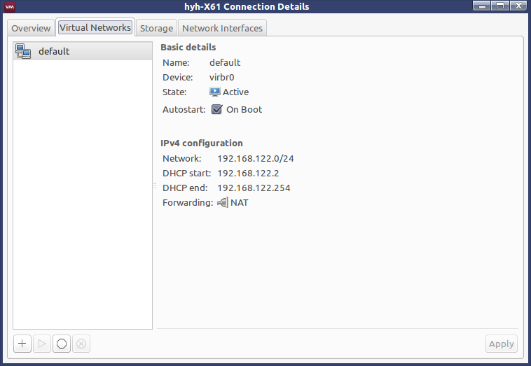

求助,用virt-manager创建了两个虚拟机,工作一切正常,访问外网也正常,但就是两个虚拟机之间ping不通。使用的NAT模式,如图

使用的NAT模式
https://help.ubuntu.com/community/KVM/Networking
The default virtual network configuration is known as Usermode Networking. Traffic is NATed through the host interface to the outside network.
一般 使用 Nat 方便上外網 但是 要讓 其它電腦看到 Guest 不容易
Alternately, you can configure Bridged Networking to enable external hosts to directly access services on the guest operating system.
如果你希望 其它電腦 存取你的 Guest 試試 Bridged Networking
詳細細節 參閱
補充
Ubuntu uses KVM as the back-end virtualization technology primarily for non-graphic servers and libvirt as its toolkit/API. Libvirt front ends for managing VMs include virt-manager (GUI) or virsh (CLI). Alternative management options include convirt (GUI) or convirt2 (WWW).
意思是 virt-manager 是 前端工具 KVM 是後端服務

使用的NAT模式
Other virtual network switch routing types
Virtual network switches can operate in two other modes, instead of NAT:
Virtual network switches 不是使用 NAT 而是在兩種模式下運作
Routed mode
Isolated mode
In this mode, guests connected to the virtual switch can communicate with each other
所以 你要選的是 Isolated mode 就不是 NAT
两个虚拟机之间还是ping不通
分別到 兩個虛擬機 及 host
sudo ifconfig -a
sudo route -nv
把結果複製 貼上來
