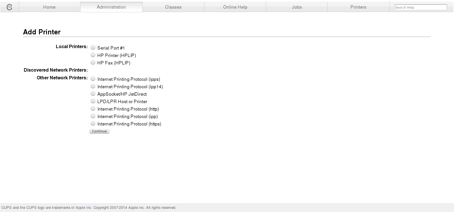

帖子 jimlon » 2014-08-11 17:04
http://localhost:631/admin/
中添加打印机
只有:
Add Printer
Local Printers: HP Printer (HPLIP)
Serial Port #1
HP Fax (HPLIP)
Discovered Network Printers:
Other Network Printers:
Internet Printing Protocol (ipp14)
Internet Printing Protocol (ipp)
Internet Printing Protocol (http)
LPD/LPR Host or Printer
Internet Printing Protocol (https)
AppSocket/HP JetDirect
Internet Printing Protocol (ipps)
原来不是应该有SMB网络打印机的选项吗?怎么没了?

抱歉,没写清楚
我的系统是Kubuntu14.10 64位
看了您发的参照页面
但我这里根本就没有windows printers via samba 这种选项,

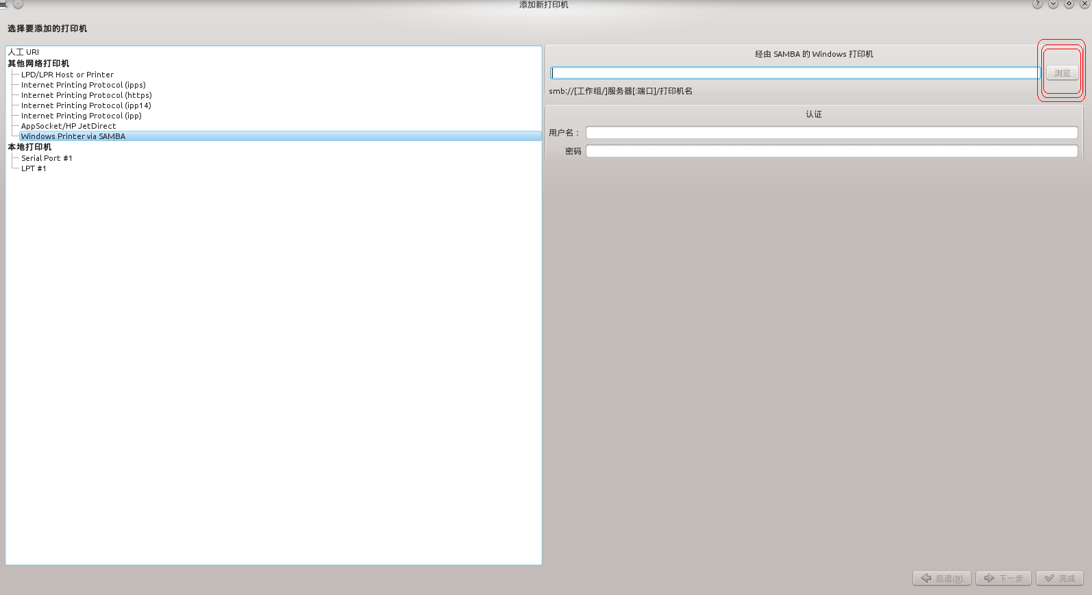

sudo apt-get install hannah-foo2zjs printer-driver-foo2zjs printer-driver-foo2zjs-common libcups2
安装完毕后
下载PPD文件
http://www.openprinting.org/printer/Gen ... DI_Printer
gdi (driver home page)
This driver is free software.
Type: Ghostscript built-in
Download: PPD file: View PPD, directly download PPD
在打印机设置页面,添加打印机,出现:
可以看到在选择”经由samba的windows打印机"时,“浏览”始终是灰色不可选的,
并且,虽然在DOLPHIN中可以打开SAMBA共享文件夹,但看不到windows机器共享出来的打印机
在/etc/samba/smb.conf中
[printers]
comment = All Printers
browseable = yes
path = /var/spool/samba
printable = yes
guest ok = yes
public = yes
; read only = yes
create mask = 0700
# Windows clients look for this share name as a source of downloadable
# printer drivers
[print$]
comment = Printer Drivers
path = /var/lib/samba/printers
browseable = yes
read only = yes
; guest ok = no
(后来不管这些,先填写smb打印机的地址和机器名/用户名/密码,选择那个PPD驱动后,强行建了个打印机出来并且共享,发现在局域网中的windows机器中可以打开看到这台kubuntu共享出的打印机)
確認是否已經安裝 cups 套件 並且 設定妥當
參閱
https://help.ubuntu.com/community/Print ... bInterface
https://help.ubuntu.com/14.04/serverguide/cups.html
http://www.cups.org/doc-1.1/sam.html
