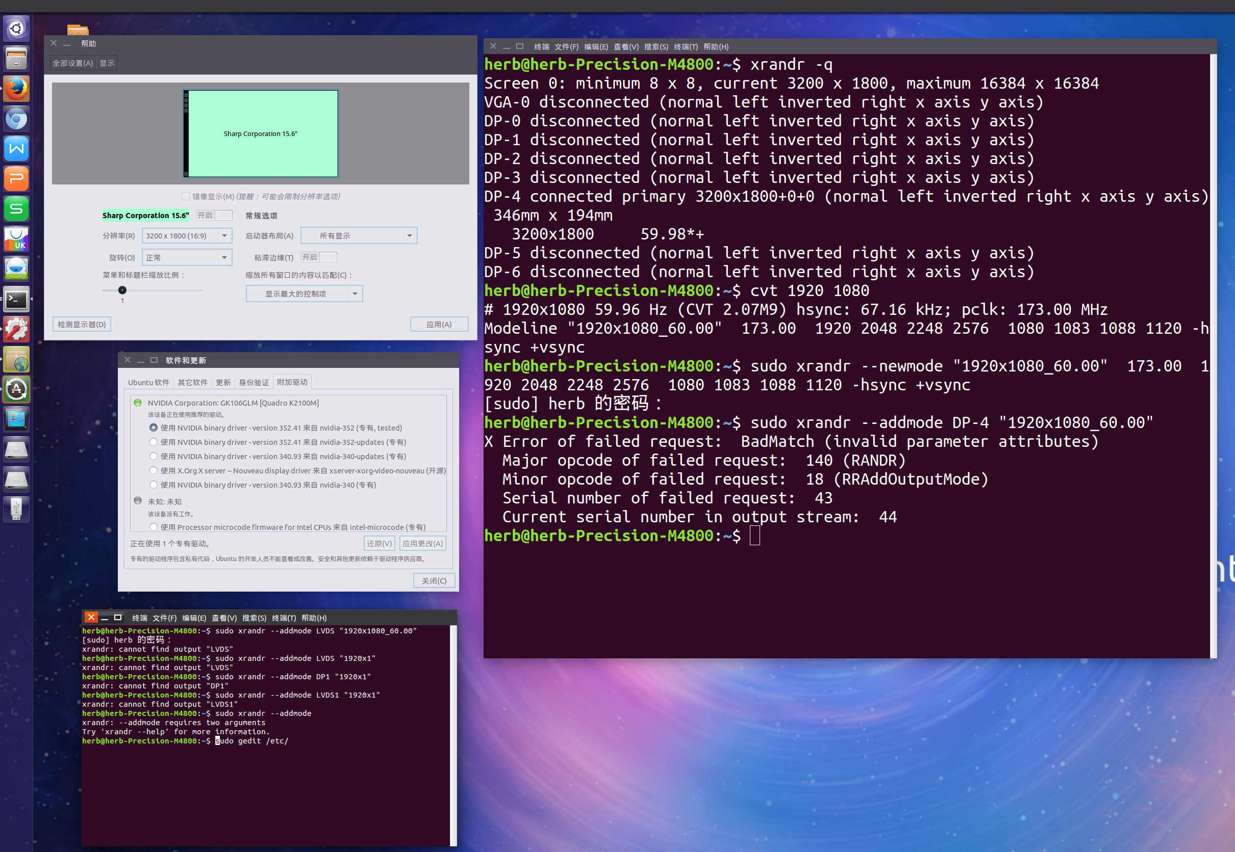

楼主是怎么设置的呢?我想把分辨率调小到高清,但我的dell-m4800笔记本4k屏幕装的ubuntukylin系统,分辨率总是调整不成功,驱动从开源X.org换成Nvidia的专用tested驱动也还是不成,设置完后注销再登陆会出现分辨率是小了,但是鼠标点击却还在4k分辨率里。。。。
听说fvwm能解决。。 但还不知道怎么设置

在驱动是开源xorg的时候,无论是系统设置里设置1920x1080,还是用xrandr其他分辨率,都会直接黑屏..... 我通常都是ctrl+alt+f1盲打要求sudo shutdown后电脑会自动亮屏到登陆界面。
在驱动改成NVIDIa的时候,系统设置里就只有3200x1800分辨率,但xrandr -s 5 可以暂时的得到我想要1920x1080分辨率,于是我按照您给我发的链接打算加入新模式1920x1080分辨率,却各种失败,下面就是我的终端内容:
(笔记本基本环境:dell-m4800笔记本,win7+ubuntukylin15.10双系统独立安装在两块ssd硬盘上,ubuntukylin15.10新装后仅在ustc源update&upgrade过,再其他的就什么都没有安装过或设置过了)
herb@herb-Precision-M4800:~$ xrandr -q
Screen 0: minimum 8 x 8, current 3200 x 1800, maximum 16384 x 16384
VGA-0 disconnected (normal left inverted right x axis y axis)
DP-0 disconnected (normal left inverted right x axis y axis)
DP-1 disconnected (normal left inverted right x axis y axis)
DP-2 disconnected (normal left inverted right x axis y axis)
DP-3 disconnected (normal left inverted right x axis y axis)
DP-4 connected primary 3200x1800+0+0 (normal left inverted right x axis y axis) 346mm x 194mm
   3200x1800     59.98*+
DP-5 disconnected (normal left inverted right x axis y axis)
DP-6 disconnected (normal left inverted right x axis y axis)
herb@herb-Precision-M4800:~$ cvt 1920 1080
# 1920x1080 59.96 Hz (CVT 2.07M9) hsync: 67.16 kHz; pclk: 173.00 MHz
Modeline "1920x1080_60.00"  173.00  1920 2048 2248 2576  1080 1083 1088 1120 -hsync +vsync
herb@herb-Precision-M4800:~$ sudo xrandr --newmode "1920x1080_60.00"  173.00  1920 2048 2248 2576  1080 1083 1088 1120 -hsync +vsync
[sudo] herb 的密码:
   3200x1800     59.98*+
  1920x1080_60.00 (0x32d) 173.000MHz
        h: width  1920 start 2048 end 2248 total 2576 skew    0 clock  67.16KHz
        v: height 1080 start 1083 end 1088 total 1120           clock  59.96Hz
herb@herb-Precision-M4800:~$ sudo xrandr --addmode DP-4 "1920x1080_60.00"
X Error of failed request:  BadMatch (invalid parameter attributes)
  Major opcode of failed request:  140 (RANDR)
  Minor opcode of failed request:  18 (RRAddOutputMode)
  Serial number of failed request:  43
  Current serial number in output stream:  44
2015-11-14 13-32-13屏幕截图.jpg [ 393.7 KiB | 被浏览 6560 次 ]

0. 你在 monitor 及 顯卡 之間使用什麼連接線 ? 有沒有 dvi 連接線及插口 ?
引用:
dell-m4800 笔记本
1. 把下面指令 複製 貼進終端機 執行
1-1. uname -r
1-2. sudo lspci -knn
1-3. sudo lshw -numeric -class video
1-4. sudo ubuntu-drivers devices
把結果直接 選取/複製 貼上來

谢谢你的回复!我其实还是菜鸟,问题0没听懂。
下面就是我终端复制上来的结果:
herb@herb-Precision-M4800:~$ uname -r
4.2.0-18-generic
herb@herb-Precision-M4800:~$ sudo lspci -knn
[sudo] herb 的密码:
00:00.0 Host bridge [0600]: Intel Corporation Xeon E3-1200 v3/4th Gen Core Processor DRAM Controller [8086:0c04] (rev 06)
   Subsystem: Dell Device [1028:05cc]
00:01.0 PCI bridge [0604]: Intel Corporation Xeon E3-1200 v3/4th Gen Core Processor PCI Express x16 Controller [8086:0c01] (rev 06)
   Kernel driver in use: pcieport
00:14.0 USB controller [0c03]: Intel Corporation 8 Series/C220 Series Chipset Family USB xHCI [8086:8c31] (rev 04)
   Kernel driver in use: xhci_hcd
00:16.0 Communication controller [0780]: Intel Corporation 8 Series/C220 Series Chipset Family MEI Controller #1 [8086:8c3a] (rev 04)
   Kernel driver in use: mei_me
00:19.0 Ethernet controller [0200]: Intel Corporation Ethernet Connection I217-LM [8086:153a] (rev 04)
   DeviceName:  Onboard LAN
   Kernel driver in use: e1000e
00:1a.0 USB controller [0c03]: Intel Corporation 8 Series/C220 Series Chipset Family USB EHCI #2 [8086:8c2d] (rev 04)
   Kernel driver in use: ehci-pci
00:1b.0 Audio device [0403]: Intel Corporation 8 Series/C220 Series Chipset High Definition Audio Controller [8086:8c20] (rev 04)
   Kernel driver in use: snd_hda_intel
00:1c.0 PCI bridge [0604]: Intel Corporation 8 Series/C220 Series Chipset Family PCI Express Root Port #1 [8086:8c10] (rev d4)
00:1c.2 PCI bridge [0604]: Intel Corporation 8 Series/C220 Series Chipset Family PCI Express Root Port #3 [8086:8c14] (rev d4)
00:1c.3 PCI bridge [0604]: Intel Corporation 8 Series/C220 Series Chipset Family PCI Express Root Port #4 [8086:8c16] (rev d4)
00:1c.4 PCI bridge [0604]: Intel Corporation 8 Series/C220 Series Chipset Family PCI Express Root Port #5 [8086:8c18] (rev d4)
00:1c.6 PCI bridge [0604]: Intel Corporation 8 Series/C220 Series Chipset Family PCI Express Root Port #7 [8086:8c1c] (rev d4)
00:1c.7 PCI bridge [0604]: Intel Corporation 8 Series/C220 Series Chipset Family PCI Express Root Port #8 [8086:8c1e] (rev d4)
00:1d.0 USB controller [0c03]: Intel Corporation 8 Series/C220 Series Chipset Family USB EHCI #1 [8086:8c26] (rev 04)
00:1f.0 ISA bridge [0601]: Intel Corporation QM87 Express LPC Controller [8086:8c4f] (rev 04)
   Kernel driver in use: lpc_ich
00:1f.2 SATA controller [0106]: Intel Corporation 8 Series/C220 Series Chipset Family 6-port SATA Controller 1 [AHCI mode] [8086:8c03] (rev 04)
   Kernel driver in use: ahci
00:1f.3 SMBus [0c05]: Intel Corporation 8 Series/C220 Series Chipset Family SMBus Controller [8086:8c22] (rev 04)
01:00.0 VGA compatible controller [0300]: NVIDIA Corporation GK106GLM [Quadro K2100M] [10de:11fc] (rev a1)
   Kernel driver in use: nvidia
01:00.1 Audio device [0403]: NVIDIA Corporation GK106 HDMI Audio Controller [10de:0e0b] (rev a1)
03:00.0 PCI bridge [0604]: Wilocity Ltd. Wil6200 PCI Express Root Port [1ae9:0101] (rev 04)
04:00.0 PCI bridge [0604]: Wilocity Ltd. Wil6200 Wireless PCI Express Port [1ae9:0201] (rev 04)
04:02.0 PCI bridge [0604]: Wilocity Ltd. Wil6200 Wireless PCI Express Port [1ae9:0201] (rev 04)
04:03.0 PCI bridge [0604]: Wilocity Ltd. Wil6200 Wireless PCI Express Port [1ae9:0201] (rev 04)
05:00.0 Network controller [0280]: Qualcomm Atheros AR9462 Wireless Network Adapter [168c:0034] (rev 01)
   Subsystem: Dell Device [1028:020d]
   Kernel driver in use: ath9k
15:00.0 SD Host controller [0805]: O2 Micro, Inc. SD/MMC Card Reader Controller [1217:8520] (rev 01)
   Kernel driver in use: sdhci-pci
herb@herb-Precision-M4800:~$ sudo lshw -numeric -class video
  *-display
       product: GK106GLM [Quadro K2100M] [10DE:11FC]
       vendor: NVIDIA Corporation [10DE]
       physical id: 0
       bus info: pci@0000:01:00.0
       version: a1
       width: 64 bits
       clock: 33MHz
       capabilities: pm msi pciexpress vga_controller bus_master cap_list rom
       configuration: driver=nvidia latency=0
       resources: irq:35 memory:f4000000-f4ffffff memory:e0000000-efffffff memory:f0000000-f1ffffff ioport:e000(size=128) memory:f5000000-f507ffff
herb@herb-Precision-M4800:~$ sudo ubuntu-drivers devices
== cpu-microcode.py ==
driver   : intel-microcode - distro non-free
== /sys/devices/pci0000:00/0000:00:01.0/0000:01:00.0 ==
model    : GK106GLM [Quadro K2100M]
modalias : pci:v000010DEd000011FCsv00001028sd000005CCbc03sc00i00
vendor   : NVIDIA Corporation
driver   : nvidia-340-updates - distro non-free
driver   : nvidia-340 - distro non-free
driver   : nvidia-352 - distro non-free recommended
driver   : nvidia-352-updates - distro non-free
driver   : xserver-xorg-video-nouveau - distro free builtin

poloshiao 写道:
不知道下面的图是不是你想了解的: 似乎没有所谓的DVI?
图片来源:http://www.notebookcheck.net/Review-Dell-Precision-M4800-Notebook.104416.0.html
另外,我现在外接了一个VGA显示器,显示器显示分辨率是正常的,但是笔记本的显示仍然是有问题的,分辨率降不下来。
Screen 0: minimum 8 x 8, current 4800 x 1800, maximum 16384 x 16384
VGA-0 connected primary 1600x900+0+0 (normal left inverted right x axis y axis) 432mm x 240mm
   1600x900      60.00*+  75.00
   1440x900      59.89
   1280x1024     75.02    70.00    60.02
   1152x864      75.00
   1024x768      75.03    70.07    60.00
   800x600       75.00    72.19    60.32    56.25
   640x480       75.00    72.81    59.94
DP-4 connected 3200x1800+1600+0 (normal left inverted right x axis y axis) 346mm x 194mm
   3200x1800     59.98*+
