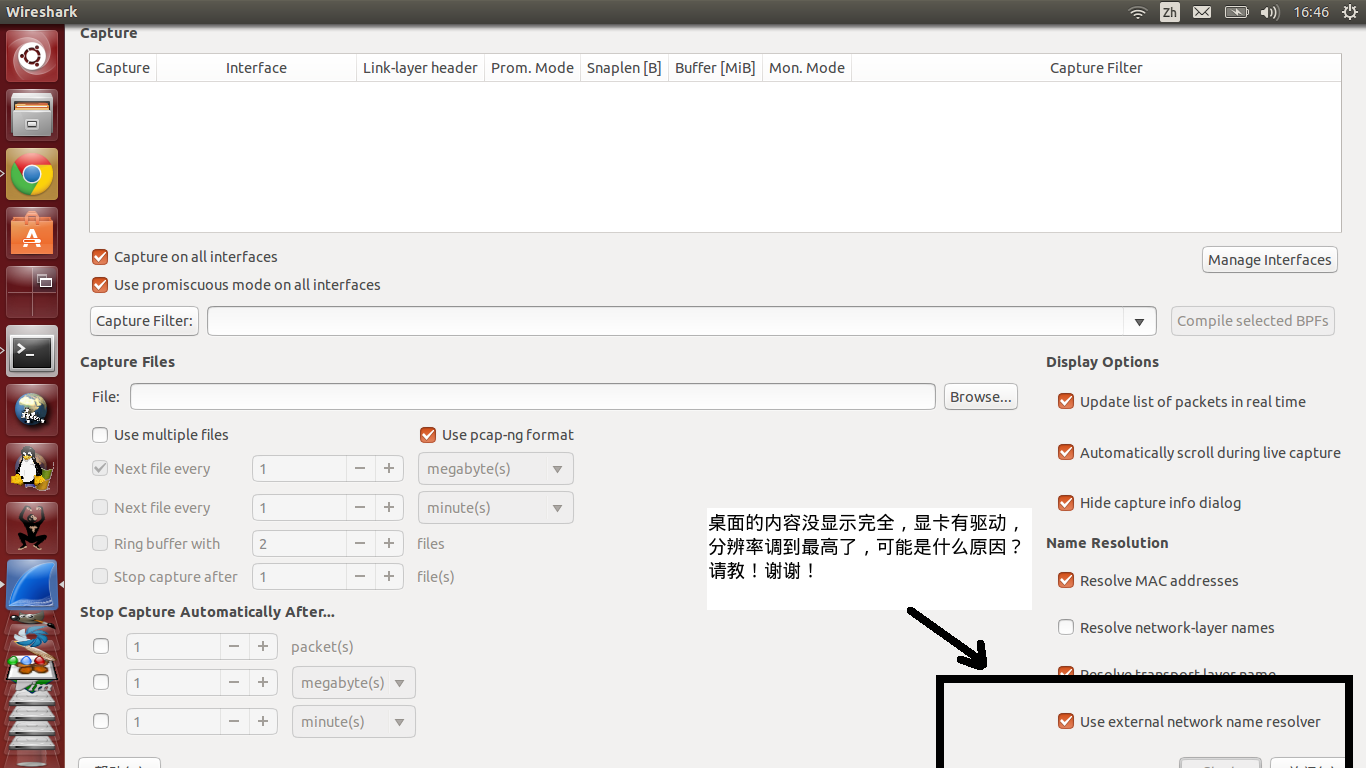

见附图,桌面下面还有文字,但是显示不完整,显卡已驱动,分辨率已调到最高了,可能是什么原因请教。。。。
2015-08-25屏幕截图.png [ 201.18 KiB | 被浏览 2002 次 ]

你的屏幕的分别率太低,而应用设计的分别率超出了你的屏幕的分别率,所以一部分控件显示到屏幕外去了。
从你提供的截图看,你的屏幕的分别率只有1366x768.
你试试把应用最大化,看看能不能出现滚动条。

我的笔记本显卡最高配置就是1366*768
就是应用是最大化了还显示不全才提问的。

参考这条链接:http://www.wireshark.org/lists/wireshark-bugs/201307/msg00198.html
如果打不开,用这个bing的搜索缓存:http://cncc.bingj.com/cache.aspx?q=wireshark+low+resolution+screen&d=4515313474995374&mkt=zh-CN&setlang=zh-CN&w=dvzHMRabxM4FU51JGnIsRDwjz89h-mT9
引用:
Build Information:
wireshark 1.10.0 (SVN Rev Unknown from unknown)
Copyright 1998-2013 Gerald Combs <gerald@wireshark.org> and contributors.
This is free software; see the source for copying conditions. There is NO
warranty; not even for MERCHANTABILITY or FITNESS FOR A PARTICULAR PURPOSE.
Compiled (64-bit) with GTK+ 2.24.18, with Cairo 1.12.14, with Pango 1.34.1,
with
GLib 2.36.3, with libpcap, with libz 1.2.7, with POSIX capabilities (Linux),
without libnl, with SMI 0.4.8, with c-ares 1.10.0, with Lua 5.1, without
Python,
with GnuTLS 3.1.11, with Gcrypt 1.5.2, with MIT Kerberos, with GeoIP, with
PortAudio V19-devel (built May 4 2013 13:59:07), with AirPcap.
Running on Linux 3.9.9-301.fc19.x86_64, with locale en_US.utf8, with libpcap
version 1.4.0, with libz 1.2.7, GnuTLS 3.1.11, Gcrypt 1.5.2, without AirPcap.
Genuine Intel(R) CPU U2300 @ 1.20GHz
Built using gcc 4.8.1 20130603 (Red Hat 4.8.1-1).
Steps to reproduce:
1: Use a 1366x768 or lower resolution display
2: Open wireshark gui
3: Click on "Capture Options" in first column
Observed results:
1: Bottom of window is cut off and unable to see or access those options with
mouse.
2: Window cannot be resized smaller than about 761x756 px width*height (not
including titlebar).
3: Workarounds involve using the keyboard and comparing with a screenshot, or
enabling desktop panning.
Expected results:
Capture Options window should be able to be resized even smaller and show
scrollbars and/or redesigned to accommodate lower resolution displays.

引用:
如果要顯示的頁面 超過 1366*768
試試
http://askubuntu.com/questions/513751/e ... croll-bars
Enable permanent vertical and horizontal scroll bars

要么期望wireshark自己修复这个界面溢出的bug,要么换更高分别率的屏幕。 :em20

如果只是一个BUG那就算了,我以为是哪没搞明白呢。。。不过还好,现在只有wireshark这个软件有发现这个问题。
