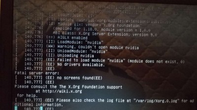

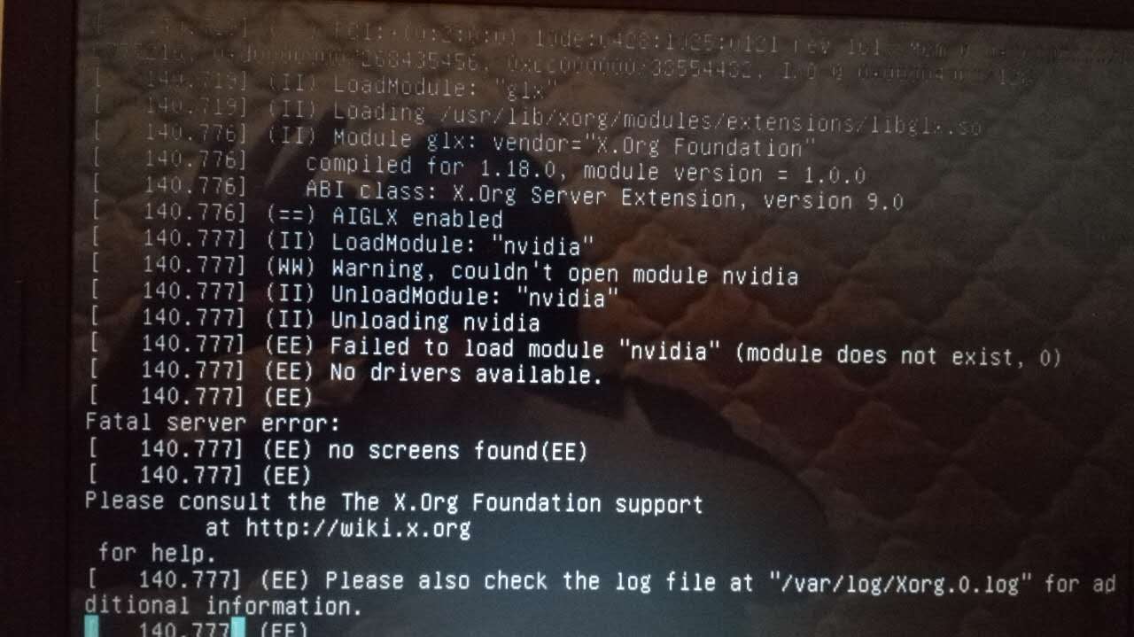

刚才又试了一下,执行到nouevau加到blacklist,启机提示load kernel module failed,进不了X,看了下日志,说是nvidia module does't exist
