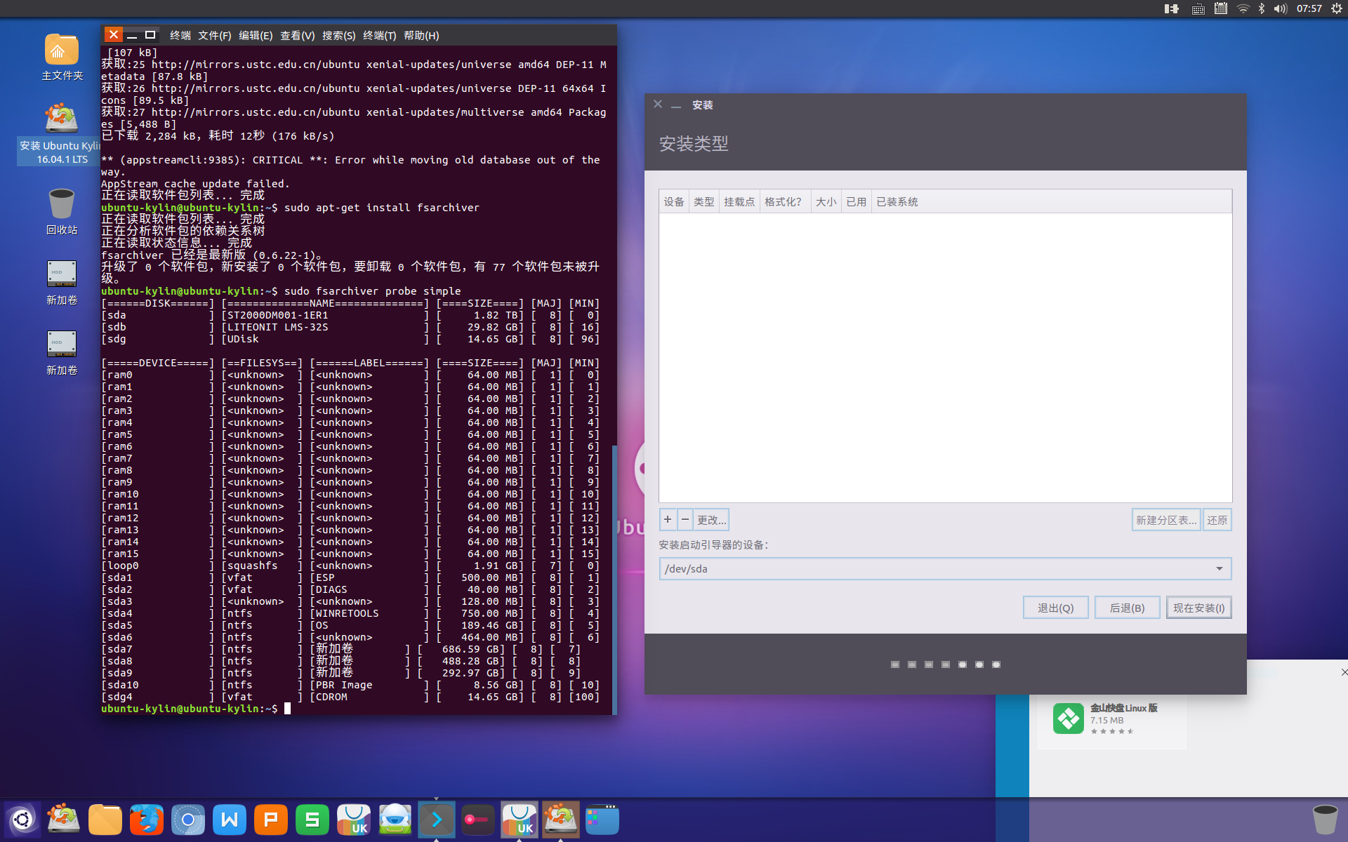

poloshiao 写道:
http://forum.ubuntu.org.cn/viewtopic.php?f=77&t=467746&p=3173010#p3173010
sudo apt-get install fsarchiver
sudo fsarchiver probe simple
敲完上述代码后,重新安装还是不行
2016-08-17 07-57-49屏幕截图.png [ 578.69 KiB | 被浏览 1729 次 ]
 文章标题 : Re: DELL XPS 8900 安装win10和Ubuntu14.0.4,安装Ubuntu时找不到硬盘
帖子发表于 : 2016-08-17 16:17
注册: 2009-08-04 16:33
帖子: 16891
送出感谢: 21
接收感谢: 1826
引用:
請把終端機指令及回應文字 全部複製貼上來 不必擷圖
回覆時引用
方便你閱讀
引用:
敲完上述代码后,重新安装还是不行
上面指令只是讀出數據 沒有其它改變
數據可以提供判讀

poloshiao 写道:
引用:
回覆時引用
方便你閱讀
引用:
敲完上述代码后,重新安装还是不行
上面指令只是讀出數據 沒有其它改變
數據可以提供判讀
ubuntu-kylin@ubuntu-kylin:~$ sudo fsarchiver probe simple
[======DISK======] [=============NAME==============] [====SIZE====] [MAJ] [MIN]
[sda ] [ST2000DM001-1ER1 ] [ 1.82 TB] [ 8] [ 0]
[sdb ] [LITEONIT LMS-32S ] [ 29.82 GB] [ 8] [ 16]
[sdg ] [UDisk ] [ 14.65 GB] [ 8] [ 96]
[=====DEVICE=====] [==FILESYS==] [======LABEL======] [====SIZE====] [MAJ] [MIN]
[ram0 ] [<unknown> ] [<unknown> ] [ 64.00 MB] [ 1] [ 0]
[ram1 ] [<unknown> ] [<unknown> ] [ 64.00 MB] [ 1] [ 1]
[ram2 ] [<unknown> ] [<unknown> ] [ 64.00 MB] [ 1] [ 2]
[ram3 ] [<unknown> ] [<unknown> ] [ 64.00 MB] [ 1] [ 3]
[ram4 ] [<unknown> ] [<unknown> ] [ 64.00 MB] [ 1] [ 4]
[ram5 ] [<unknown> ] [<unknown> ] [ 64.00 MB] [ 1] [ 5]
[ram6 ] [<unknown> ] [<unknown> ] [ 64.00 MB] [ 1] [ 6]
[ram7 ] [<unknown> ] [<unknown> ] [ 64.00 MB] [ 1] [ 7]
[ram8 ] [<unknown> ] [<unknown> ] [ 64.00 MB] [ 1] [ 8]
[ram9 ] [<unknown> ] [<unknown> ] [ 64.00 MB] [ 1] [ 9]
[ram10 ] [<unknown> ] [<unknown> ] [ 64.00 MB] [ 1] [ 10]
[ram11 ] [<unknown> ] [<unknown> ] [ 64.00 MB] [ 1] [ 11]
[ram12 ] [<unknown> ] [<unknown> ] [ 64.00 MB] [ 1] [ 12]
[ram13 ] [<unknown> ] [<unknown> ] [ 64.00 MB] [ 1] [ 13]
[ram14 ] [<unknown> ] [<unknown> ] [ 64.00 MB] [ 1] [ 14]
[ram15 ] [<unknown> ] [<unknown> ] [ 64.00 MB] [ 1] [ 15]
[loop0 ] [squashfs ] [<unknown> ] [ 1.91 GB] [ 7] [ 0]
[sda1 ] [vfat ] [ESP ] [ 500.00 MB] [ 8] [ 1]
[sda2 ] [vfat ] [DIAGS ] [ 40.00 MB] [ 8] [ 2]
[sda3 ] [<unknown> ] [<unknown> ] [ 128.00 MB] [ 8] [ 3]
[sda4 ] [ntfs ] [WINRETOOLS ] [ 750.00 MB] [ 8] [ 4]
[sda5 ] [ntfs ] [OS ] [ 189.46 GB] [ 8] [ 5]
[sda6 ] [ntfs ] [<unknown> ] [ 464.00 MB] [ 8] [ 6]
[sda7 ] [ntfs ] [新加卷 ] [ 686.59 GB] [ 8] [ 7]
[sda8 ] [ntfs ] [新加卷 ] [ 488.28 GB] [ 8] [ 8]
[sda9 ] [ntfs ] [新加卷 ] [ 292.97 GB] [ 8] [ 9]
[sda10 ] [ntfs ] [PBR Image ] [ 8.56 GB] [ 8] [ 10]
[sdg4 ] [vfat ] [CDROM ] [ 14.65 GB] [ 8] [100]

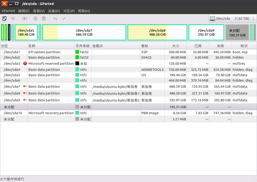

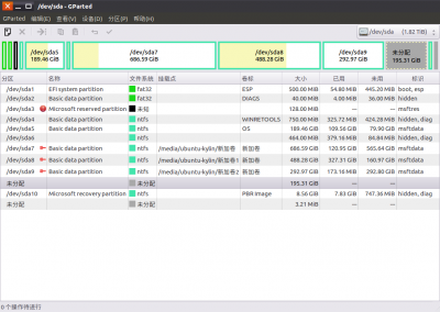

GParted分区表.png [ 127.87 KiB | 被浏览 1700 次 ]
帖子发表于 : 2016-08-17 16:24
注册: 2011-06-12 13:01
帖子: 16
用GParted查看硬盘信息时,要刷很长时间才能读到上图信息,大神能否通过这个分区情况给予分析。
帖子发表于 : 2016-08-17 16:47
帖子: 16
poloshiao 写道:
引用:
1. 沒有看到 /dev/sdb 的分割區
引用:
2.這兩個 不像是 RAID 的組成分割區
3. 沒有看到其它的 RAID 的組成分割區
引用:
网上查到电脑是固态和机械硬盘虚拟raid
4. 意思是 跟 RAID 關係不大
引用:

0. 這裡看到是 基本 GPT
1. 先把 gparted 更新到最新版 (因為有一些 Bug Report)
2. 倒數第三行
未分配 195.31 GB
看看 能否使用 Gparted 分割 / 格式化 成 ext4 格式
帖子发表于 : 2016-08-17 23:11
帖子: 16891
送出感谢: 21
接收感谢: 1826
引用:
表示你的硬盤/分割區/分割區裡面的 superblock / 分割區掛載的 檔案系統
有瑕疵 (可能是硬件 但是比較可能是軟件)
但是你的分割區都是 NTFS 或 FAT32 最好使用 Windows 的 磁盤管理程式 裡面 來維修
