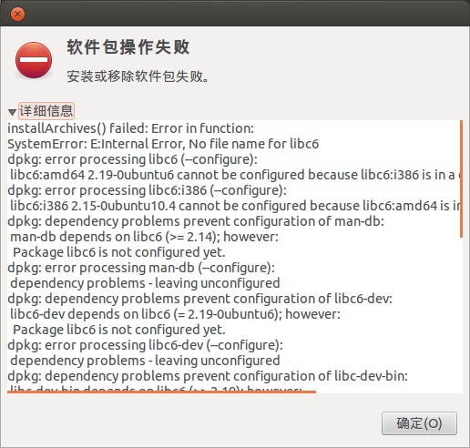

以下是软件包失败的详细信息
installArchives() failed: Error in function:
SystemError: E:Internal Error, No file name for libc6
dpkg: error processing libc6 (--configure):
 libc6:amd64 2.19-0ubuntu6 cannot be configured because libc6:i386 is in a different version (2.15-0ubuntu10.4)
dpkg: error processing libc6:i386 (--configure):
 libc6:i386 2.15-0ubuntu10.4 cannot be configured because libc6:amd64 is in a different version (2.19-0ubuntu6)
dpkg: dependency problems prevent configuration of man-db:
 man-db depends on libc6 (>= 2.14); however:
  Package libc6 is not configured yet.
dpkg: error processing man-db (--configure):
 dependency problems - leaving unconfigured
dpkg: dependency problems prevent configuration of libc6-dev:
 libc6-dev depends on libc6 (= 2.19-0ubuntu6); however:
dpkg: error processing libc6-dev (--configure):
dpkg: dependency problems prevent configuration of libc-dev-bin:
 libc-dev-bin depends on libc6 (>> 2.19); however:
 libc-dev-bin depends on libc6 (<< 2.20); however:
dpkg: error processing libc-dev-bin (--configure):
dpkg: dependency problems prevent configuration of libc6-i386:
 libc6-i386 depends on libc6 (= 2.19-0ubuntu6); however:
dpkg: error processing libc6-i386 (--configure):
dpkg: dependency problems prevent configuration of libnih1:
 libnih1 depends on libc6 (>= 2.15~); however:
dpkg: error processing libnih1 (--configure):
dpkg: dependency problems prevent configuration of libnih-dbus1:
 libnih-dbus1 depends on libnih1 (= 1.0.3-4ubuntu25); however:
  Package libnih1 is not configured yet.
 libnih-dbus1 depends on libc6 (>= 2.3.4); however:
dpkg: error processing libnih-dbus1 (--configure):
麻烦大家帮忙看看,有没有解决方法?

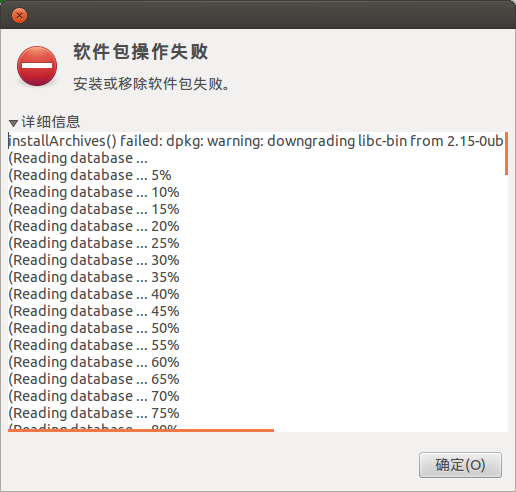

执行第三步终端报错
W: 无法下载 http://dl.google.com/linux/chrome/deb/dists/stable/Release  Unable to find expected entry 'main/binary-i386/Packages' in Release file (Wrong sources.list entry or malformed file)
E: Some index files failed to download. They have been ignored, or old ones used instead.
点开软件中心弹出修复提示点击修复后报错:
    installArchives() failed: dpkg: warning: downgrading libc-bin from 2.15-0ubuntu10.4 to 2.15-0ubuntu10.
    (Reading database ...
    (Reading database ... 5%
    (Reading database ... 10%
    (Reading database ... 15%
    (Reading database ... 20%
    (Reading database ... 25%
    (Reading database ... 30%
    (Reading database ... 35%
    (Reading database ... 40%
    (Reading database ... 45%
    (Reading database ... 50%
    (Reading database ... 55%
    (Reading database ... 60%
    (Reading database ... 65%
    (Reading database ... 70%
    (Reading database ... 75%
    (Reading database ... 80%
    (Reading database ... 85%
    (Reading database ... 90%
    (Reading database ... 95%
    (Reading database ... 100%
    (Reading database ... 260926 files and directories currently installed.)
    Preparing to replace libc-bin 2.15-0ubuntu10.4 (using .../libc-bin_2.15-0ubuntu10_amd64.deb) ...
    Unpacking replacement libc-bin ...
    Setting up libc-bin (2.15-0ubuntu10) ...
    libc6-dev depends on libc6 (= 2.19-No apport report written because the error message indicates its a followup error from a previous failure.
    No apport report written because MaxReports is reached already
    0ubuntu6); however:
    libc6-dev depends on libc-dev-bin (= 2.19-0ubuntu6); however:
    Package libc-dev-bin is not configured yet.
    Errors were encountered while processing:
    libc6
    libc6:i386
    libc6-i386
    libc-dev-bin
    libc6-dev
    libnih1
    libnih-dbus1
    man-db
    Error in function:
    感觉快要疯了....大神还有救吗?

    麻烦大家帮帮忙看看,以下是点击修复软件包的报错详细信息:
      installArchives() failed: dpkg: error processing libc6 (--configure):
      dpkg: dependency problems prevent configuration of libnNo apport report written because MaxReports is reached already
      ih1:
      dependency problems - leaving unconfiguredNo apport report written because MaxReports is reached already
      libc6
      libc6:i386
      libc6-i386
      libc-dev-bin
      libc6-dev
      libnih1
      libnih-dbus1
      man-db
      Error in function:
      SystemError: E:Sub-process /usr/bin/dpkg returned an error code (1)
