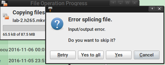

我有一个文件,可正常打开和使用,但复制粘贴别的地方时,就报错,无法完整地复制过去。
复制文件时报错:Error splicing file. Input/output error.
copy_error.png [ 33.22 KiB | 被浏览 941 次 ]
这是什么情况?
是不是硬盘有问题……
kashu:/tmp$ smudo sartctl -a /dev/sdb

kashu 写道:
系统:Xubuntu 14.04.5 LTS 64-bit
问题:
这是什么情况?
试试用dd和ddrescue命令各复制一份,然后用MD5校验一下三者(原文件,dd的输出,ddrescue的输出)是否相同?
还有注意一下可用空间什么的
直觉上感觉好像是文件系统损坏了之类的问题

根据我的常识
理论上能读取就应该可以复制(读取和复制出来的数据是否已经损坏是另一回事)
是不是复制的目标设备的问题?
试试看更换一下复制的目标设备看问题是否继续存在?

用badblocks检查有21个坏道,我的心……好塞啊 :Cry
kashu:/tmp$ sudo badblocks -sv /dev/sdb
Checking blocks 0 to 488386583
Checking for bad blocks (read-only test): 14199092done, 3:12 elapsed. (0/0/0 errors)
14199093done, 3:15 elapsed. (1/0/0 errors)
14199094done, 3:17 elapsed. (2/0/0 errors)
14199095done, 3:19 elapsed. (3/0/0 errors)
 25.76%  72.34% done, 1:24:23 elapsed. (4/0/0 errors)
400084796one, 1:38:25 elapsed. (4/0/0 errors)
400084797one, 1:38:27 elapsed. (5/0/0 errors)
400084798one, 1:38:29 elapsed. (6/0/0 errors)
400084799one, 1:38:32 elapsed. (7/0/0 errors)
410224648one, 1:44:35 elapsed. (8/0/0 errors)
410224649one, 1:44:38 elapsed. (9/0/0 errors)
410224650one, 1:44:41 elapsed. (10/0/0 errors)
410224651one, 1:44:44 elapsed. (11/0/0 errors)
410225224one, 1:44:46 elapsed. (12/0/0 errors)
410225225one, 1:44:49 elapsed. (13/0/0 errors)
410225226one, 1:44:51 elapsed. (14/0/0 errors)
410225227one, 1:44:54 elapsed. (15/0/0 errors)
410225228one, 1:44:56 elapsed. (16/0/0 errors)
410225229one, 1:44:59 elapsed. (17/0/0 errors)
410225230one, 1:45:01 elapsed. (18/0/0 errors)
410225231one, 1:45:04 elapsed. (19/0/0 errors)
410225876one, 1:45:06 elapsed. (20/0/0 errors)
done
Pass completed, 21 bad blocks found. (21/0/0 errors)
