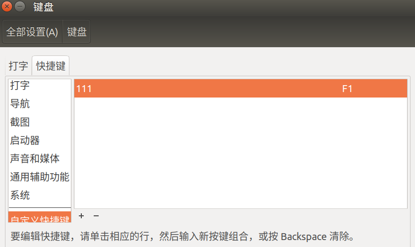

http://askubuntu.com/questions/58147/ho ... elp-f1-key
引用:
Just to Disable F1 may not be functioning in gnome. The practice way to avoid F1 to bring up Help window is to assign it to some unused function or a common function, such as 'raise'.
In most Ubuntu releases, using Settings->Keyboard->Shortcuts to assign F1 to 'raise' should work, except Ubuntu 14.04. Under Ubuntu 14.04, use dconf-editor to reassign F1 to 'raise' described by The Thunder Chimp above.
虽然说的是禁用F1,不过设置应该也差不多,当然我的系统不是14.04,14.04可能要用dconf-editor来设置
2017-02-07 15-54-54屏幕截图.png [ 50.77 KiB | 被浏览 1554 次 ]
恩恩在14.04,在应用这个界面,没办法获取到F1,按F1直接跳出帮助。谢谢你
