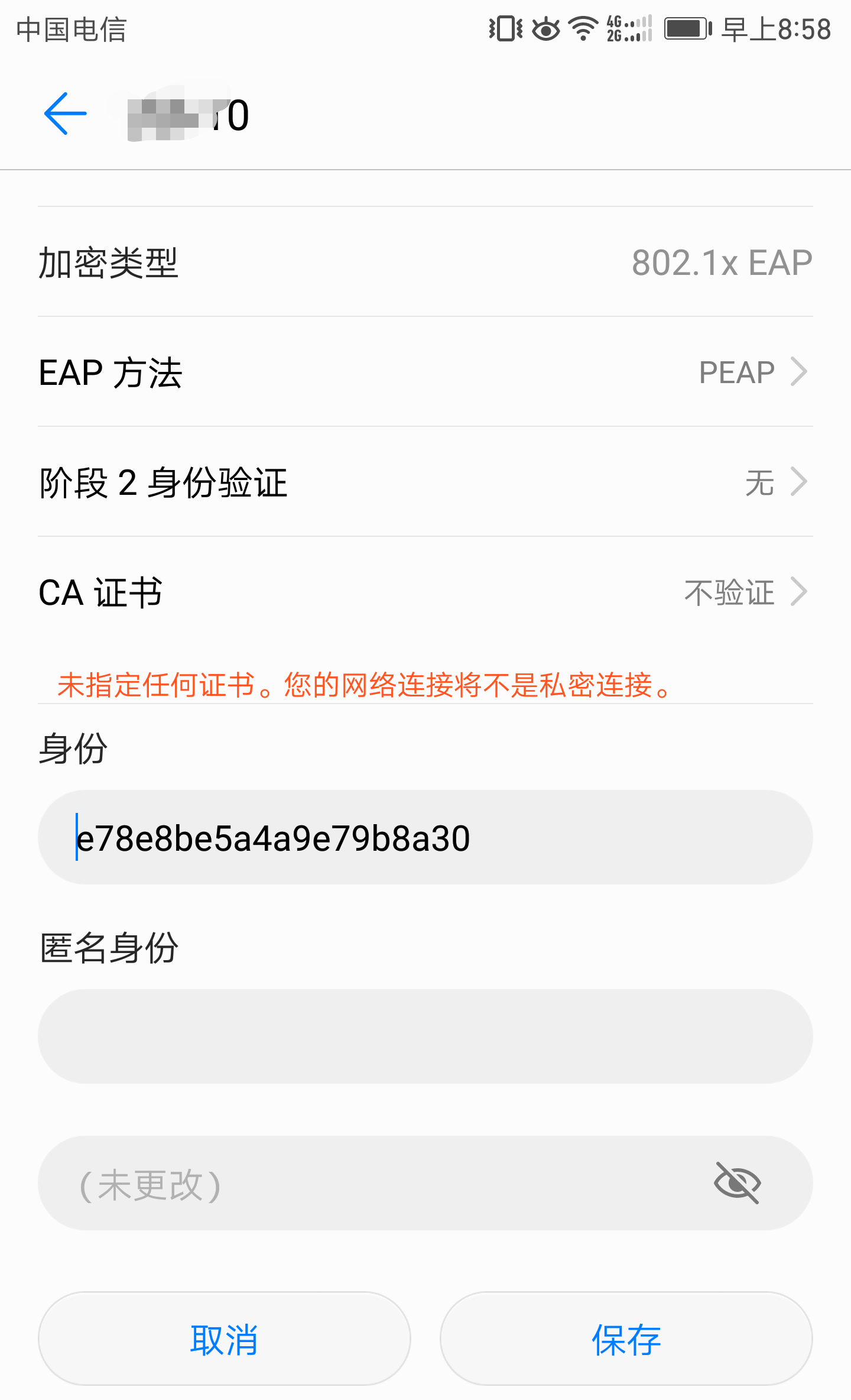

单位使用了锐捷无线网络认证,认证的方式好像是802.1X EAP 用户名加密码,外加mac地址绑定。
这种方式在windows macOS 和Android 下都可以用,但单位技术人员就是说不支持linux。
android都支持,ubuntu真的就不支持吗?
我附上一张手机网络配置的图片,可否有高手指导下,在ubuntu里应该怎样配置。

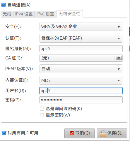

taohunter 写道:
谢谢啦,我用的是ubuntu12.04,系统自带wpa_suplicant,我的配置如图片附件,但是还是连接不上。
我将syslog中相关日志也传上来,希望有大神能够抽出点时间帮我分析下,看看问题出在哪里,谢谢啦!
Mar 22 16:44:49 etcity NetworkManager[946]: <info> Activation (eth1) starting connection 'office-10'
Mar 22 16:44:49 etcity NetworkManager[946]: <info> (eth1): device state change: disconnected -> prepare (reason 'none') [30 40 0]
Mar 22 16:44:49 etcity NetworkManager[946]: <info> Activation (eth1) Stage 1 of 5 (Device Prepare) scheduled...
Mar 22 16:44:49 etcity NetworkManager[946]: <info> (eth1): supplicant interface state: completed -> disconnected
Mar 22 16:44:49 etcity NetworkManager[946]: <info> Activation (eth1) Stage 1 of 5 (Device Prepare) started...
Mar 22 16:44:49 etcity dbus[878]: [system] Successfully activated service 'org.freedesktop.nm_dispatcher'
Mar 22 16:44:50 etcity NetworkManager[946]: <info> (eth1): set MAC address to A4:CA:A0:10:41:E0
Mar 22 16:44:50 etcity NetworkManager[946]: <info> Activation (eth1) Stage 2 of 5 (Device Configure) scheduled...
Mar 22 16:44:50 etcity NetworkManager[946]: <info> Activation (eth1) Stage 1 of 5 (Device Prepare) complete.
Mar 22 16:44:50 etcity NetworkManager[946]: <info> Activation (eth1) Stage 2 of 5 (Device Configure) starting...
Mar 22 16:44:50 etcity NetworkManager[946]: <info> (eth1): device state change: prepare -> config (reason 'none') [40 50 0]
Mar 22 16:44:50 etcity NetworkManager[946]: <info> Activation (eth1/wireless): connection 'office-10' has security, and secrets exist.  No new secrets needed.
Mar 22 16:44:50 etcity NetworkManager[946]: <info> Config: added 'ssid' value 'office-10'
Mar 22 16:44:50 etcity NetworkManager[946]: <info> Config: added 'scan_ssid' value '1'
Mar 22 16:44:50 etcity NetworkManager[946]: <info> Config: added 'key_mgmt' value 'WPA-EAP'
Mar 22 16:44:50 etcity NetworkManager[946]: <info> Config: added 'password' value '<omitted>'
Mar 22 16:44:50 etcity NetworkManager[946]: <info> Config: added 'eap' value 'PEAP'
Mar 22 16:44:50 etcity kernel: [ 6364.020505] IPv6: ADDRCONF(NETDEV_UP): eth1: link is not ready
Mar 22 16:44:50 etcity NetworkManager[946]: <info> Config: added 'fragment_size' value '1300'
Mar 22 16:44:50 etcity NetworkManager[946]: <info> Config: added 'phase2' value 'auth=MD5'
Mar 22 16:44:50 etcity NetworkManager[946]: <info> Config: added 'identity' value 'apt0'
Mar 22 16:44:50 etcity NetworkManager[946]: <info> Config: added 'anonymous_identity' value 'apt0'
Mar 22 16:44:50 etcity NetworkManager[946]: <info> Config: added 'bgscan' value 'simple:30:-45:300'
Mar 22 16:44:50 etcity NetworkManager[946]: <info> Activation (eth1) Stage 2 of 5 (Device Configure) complete.
Mar 22 16:44:50 etcity NetworkManager[946]: <info> Config: set interface ap_scan to 1
Mar 22 16:44:50 etcity NetworkManager[946]: <info> (eth1): supplicant interface state: disconnected -> scanning
Mar 22 16:44:50 etcity wpa_supplicant[1000]: Trying to associate with 06:69:6c:5a:e7:f2 (SSID='office-10' freq=2422 MHz)
Mar 22 16:44:50 etcity wpa_supplicant[1000]: Association request to the driver failed
Mar 22 16:44:50 etcity NetworkManager[946]: <info> (eth1): supplicant interface state: scanning -> associating
Mar 22 16:44:50 etcity wpa_supplicant[1000]: Associated with 06:69:6c:5a:e7:f2
Mar 22 16:44:50 etcity wpa_supplicant[1000]: bgscan simple: Failed to enable signal strength monitoring
Mar 22 16:44:50 etcity kernel: [ 6364.788141] IPv6: ADDRCONF(NETDEV_CHANGE): eth1: link becomes ready
Mar 22 16:44:50 etcity NetworkManager[946]: <info> (eth1): supplicant interface state: associating -> associated
Mar 22 16:44:51 etcity wpa_supplicant[1000]: CTRL-EVENT-EAP-STARTED EAP authentication started
Mar 22 16:44:51 etcity wpa_supplicant[1000]: CTRL-EVENT-EAP-PROPOSED-METHOD vendor=0 method=25
Mar 22 16:44:51 etcity wpa_supplicant[1000]: CTRL-EVENT-EAP-METHOD EAP vendor 0 method 25 (PEAP) selected
Mar 22 16:44:51 etcity wpa_supplicant[1000]: CTRL-EVENT-EAP-PEER-CERT depth=2 subject='/C=US/O=GeoTrust Inc./CN=GeoTrust Global CA'
Mar 22 16:44:51 etcity wpa_supplicant[1000]: CTRL-EVENT-EAP-PEER-CERT depth=1 subject='/C=US/O=GeoTrust, Inc./CN=RapidSSL CA'
Mar 22 16:44:51 etcity wpa_supplicant[1000]: CTRL-EVENT-EAP-PEER-CERT depth=0 subject='/serialNumber=S4r6ZPDEGxbrUXDiblCnGv0gZuUF02Z-/OU=GT96940710/OU=See www.rapidssl.com/resources/cps (c)14/OU=Domain Control Validated - RapidSSL(R)/CN=smp.ruijie.com.cn'
Mar 22 16:44:52 etcity wpa_supplicant[1000]: EAP-MSCHAPV2: Invalid header: len=32 ms_len=31
Mar 22 16:44:52 etcity wpa_supplicant[1000]: EAP-MSCHAPV2: workaround, ignore invalid ms_len 31 (len 32)
Mar 22 16:44:52 etcity avahi-daemon[935]: Joining mDNS multicast group on interface eth1.IPv6 with address fe80::a6ca:a0ff:fe10:41e0.
Mar 22 16:44:52 etcity avahi-daemon[935]: New relevant interface eth1.IPv6 for mDNS.
Mar 22 16:44:52 etcity avahi-daemon[935]: Registering new address record for fe80::a6ca:a0ff:fe10:41e0 on eth1.*.
Mar 22 16:45:46 etcity wpa_supplicant[1000]: CTRL-EVENT-EAP-STARTED EAP authentication started
Mar 22 16:45:46 etcity wpa_supplicant[1000]: CTRL-EVENT-EAP-PROPOSED-METHOD vendor=0 method=25
Mar 22 16:45:46 etcity wpa_supplicant[1000]: CTRL-EVENT-EAP-METHOD EAP vendor 0 method 25 (PEAP) selected
Mar 22 16:45:47 etcity wpa_supplicant[1000]: CTRL-EVENT-EAP-PEER-CERT depth=2 subject='/C=US/O=GeoTrust Inc./CN=GeoTrust Global CA'
Mar 22 16:45:47 etcity wpa_supplicant[1000]: CTRL-EVENT-EAP-PEER-CERT depth=1 subject='/C=US/O=GeoTrust, Inc./CN=RapidSSL CA'
Mar 22 16:45:47 etcity wpa_supplicant[1000]: CTRL-EVENT-EAP-PEER-CERT depth=0 subject='/serialNumber=S4r6ZPDEGxbrUXDiblCnGv0gZuUF02Z-/OU=GT96940710/OU=See www.rapidssl.com/resources/cps (c)14/OU=Domain Control Validated - RapidSSL(R)/CN=smp.ruijie.com.cn'
Mar 22 16:45:47 etcity wpa_supplicant[1000]: EAP-MSCHAPV2: Invalid header: len=32 ms_len=31
Mar 22 16:45:47 etcity wpa_supplicant[1000]: EAP-MSCHAPV2: workaround, ignore invalid ms_len 31 (len 32)
Mar 22 16:45:47 etcity wpa_supplicant[1000]: EAP-MSCHAPV2: Invalid header: len=61 ms_len=60
Mar 22 16:45:47 etcity wpa_supplicant[1000]: EAP-MSCHAPV2: workaround, ignore invalid ms_len 60 (len 61)
Mar 22 16:45:47 etcity wpa_supplicant[1000]: EAP-MSCHAPV2: Authentication succeeded
Mar 22 16:45:47 etcity wpa_supplicant[1000]: EAP-TLV: TLV Result - Success - EAP-TLV/Phase2 Completed
Mar 22 16:45:47 etcity wpa_supplicant[1000]: CTRL-EVENT-EAP-SUCCESS EAP authentication completed successfully
Mar 22 16:45:47 etcity NetworkManager[946]: <info> (eth1): supplicant interface state: associated -> 4-way handshake
Mar 22 16:45:50 etcity NetworkManager[946]: <warn> Activation (eth1/wireless): association took too long.
Mar 22 16:45:50 etcity NetworkManager[946]: <info> (eth1): device state change: config -> need-auth (reason 'none') [50 60 0]
Mar 22 16:45:50 etcity NetworkManager[946]: <warn> Activation (eth1/wireless): asking for new secrets
Mar 22 16:45:50 etcity NetworkManager[946]: <info> (eth1): supplicant interface state: 4-way handshake -> disconnected
Mar 22 16:45:50 etcity NetworkManager[946]: <warn> Couldn't disconnect supplicant interface: This interface is not connected.
Mar 22 16:45:50 etcity wpa_supplicant[1000]: CTRL-EVENT-DISCONNECTED bssid=00:00:00:00:00:00 reason=0
Mar 22 16:47:50 etcity NetworkManager[946]: <warn> No agents were available for this request.
Mar 22 16:47:50 etcity NetworkManager[946]: <info> (eth1): device state change: need-auth -> failed (reason 'no-secrets') [60 120 7]
Mar 22 16:47:50 etcity NetworkManager[946]: <warn> Activation (eth1) failed for access point (office-10)
Mar 22 16:47:50 etcity NetworkManager[946]: <info> Marking connection 'office-10' invalid.
Mar 22 16:47:50 etcity NetworkManager[946]: <warn> Activation (eth1) failed.
Mar 22 16:47:50 etcity NetworkManager[946]: <info> (eth1): device state change: failed -> disconnected (reason 'none') [120 30 0]
Mar 22 16:47:50 etcity NetworkManager[946]: <info> (eth1): deactivating device (reason 'none') [0]
Mar 22 16:47:50 etcity avahi-daemon[935]: Interface eth1.IPv6 no longer relevant for mDNS.
Mar 22 16:47:50 etcity avahi-daemon[935]: Leaving mDNS multicast group on interface eth1.IPv6 with address fe80::a6ca:a0ff:fe10:41e0.
Mar 22 16:47:50 etcity avahi-daemon[935]: Withdrawing address record for fe80::a6ca:a0ff:fe10:41e0 on eth1.
Mar 22 16:47:50 etcity NetworkManager[946]: <info> (eth1): reset MAC address to 00:04:23:98:0A:52
Mar 22 16:47:50 etcity kernel: [ 6544.368470] IPv6: ADDRCONF(NETDEV_UP): eth1: link is not ready
