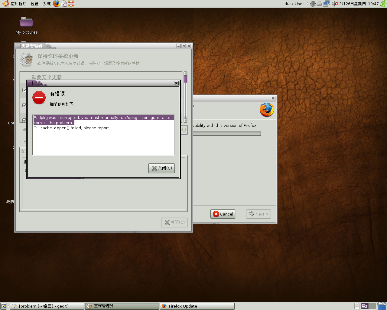

我的UBUNTU出现了一次断电,那时它正在更新安装。。于是,出现了这个问题,
E: dpkg was interrupted, you must manually run 'dpkg --configure -a' to correct the problem.
于是我又运行 了:
duck@duck-desktop:~/桌面$ sudo dpkg --configure -a
于是。。。。数秒后:
正在设置 libc6 (2.7-10ubuntu4) ...
Processing triggers for libc6 ...
ldconfig deferred processing now taking place
/sbin/ldconfig.real: /usr/lib/libartskde.so.1.2.0.dpkg-tmp is not an ELF file - it has the wrong magic bytes at the start.
/sbin/ldconfig.real: /usr/lib/libkdecore.so.4.2.0.dpkg-tmp is not an ELF file - it has the wrong magic bytes at the start.
/sbin/ldconfig.real: /usr/lib/libkabc.so.1.2.0.dpkg-tmp is not an ELF file - it has the wrong magic bytes at the start.
/sbin/ldconfig.real: /usr/lib/libkabc_file.so.1.0.0.dpkg-tmp is not an ELF file - it has the wrong magic bytes at the start.
/sbin/ldconfig.real: /usr/lib/libDCOP.so.4.2.0.dpkg-tmp is not an ELF file - it has the wrong magic bytes at the start.
Aborted
dpkg: 子进程 post-installation script 返回了错误号 134
可是安了安装更新又出现:
我该怎么办??现在不能更新,那个红色的箭头让我很郁闷。
安装时断电。。于是它就不能再更新了,怎么办
