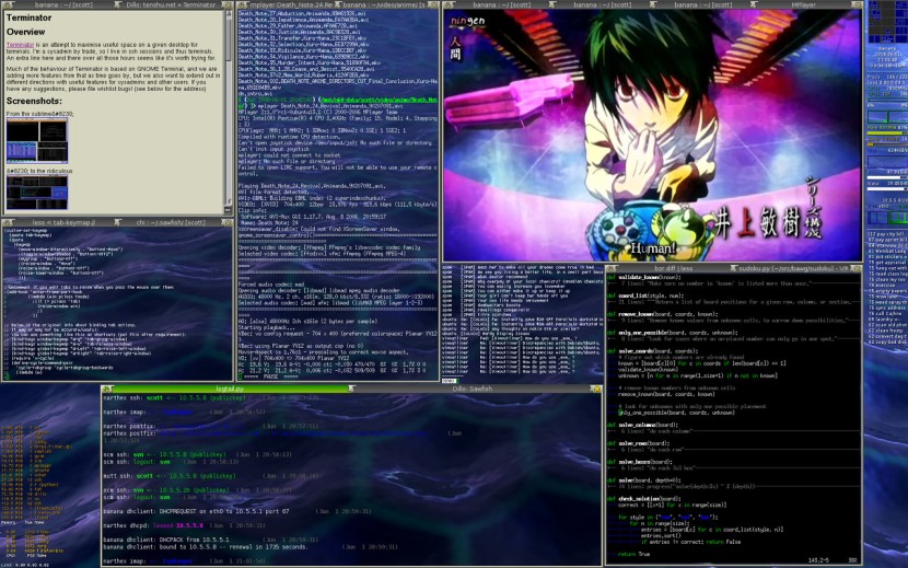

dynamic tiling window manager
Scrotwm is a minimalistic window manager that tries to stay out of the way so
that valuable screen real estate can be used for much more important stuff.
It has sane defaults and does not require one to learn a language to do any
configuration.
It was written by hackers for hackers and it strives to be small, compact
and fast.
我试着翻译一下:
动态平铺式窗口管理器
Scrotwm 是一个小型窗口管理器,他试图对如下问题找到出路:如何使宝贵的屏幕为重要的程序所用。它有健全的默认值,不需要学习一门语言做任何配置。他是黑客所写并为黑客所用,他努力做到小巧、紧凑和快速。
这个有点意思!
(这个不用贴图了,平铺的桌面都差不多,很难看。网上的评价不很好,说他没有配置时把panel也当成窗口给平铺了。)
(有闲杂时间的话,测试一下这个东西)

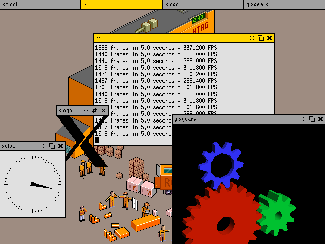

tiny window manager
TinyWM is a small, simple window manager. It has a minimal memory
footprint, which makes it useful in embedded systems. It features window
move, resize, and raise operations, and supports "sloppy focus".
Due to its simplicity, its source code (in C and Python) can be used as a
reference implementation for developers seeking to understand basic window
manager programming.
小的,主要用来学习窗口管理器工作原理用的
(这个还真没有找到截图,不过居然有人说他在用。好像没有边框按钮什么的,因为帮助上说
Move windows interactively with Alt+Button1 drag (left mouse button)(Alt+鼠标左键移动窗口)
Resize windows interactively with Alt+Button3 drag (right mouse button)(Alt+鼠标右键调整窗口大小)
Alt+F1 (升起窗口)
点击鼠标获得焦点

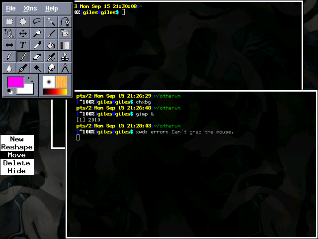

Plan 9窗体管理器8-1/2模拟器
9wm是一个X窗体管理器,尝试在X的限制下尽可能的模拟Plan 9窗体管理器8-1/2。
它提供一个简单但是舒服的用户界面,没有花哨的装饰或标题栏,或者图标。 而且它是点击即印。
用于shell的X菜单
9menu
这是一个允许你从shell创建X菜单的简单程序,这里每个菜单项将会运行一个命 令。9menu本来用于9wm,但是也可以用于其他窗体管理器
(也终于找到这个截图了,这是W9wm的截图,和9wm一个体系的。没有标题栏,移动和调整窗口需要点左边的菜单。这个好原始呀!)

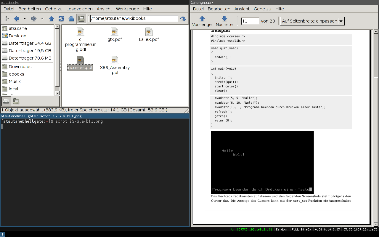

metapackage (i3 window manager, screen locker, menu, statusbar)
This metapackage installs the i3 window manager (i3-wm), the i3lock screen
locker (slightly improved version of slock), suckless-tools which contains dmenu
and i3status, which displays useful information about your system in
combination with dzen2. These are all the tools you need to use the i3 window
manager efficiently.
一个小而全的wm,平铺式的。2011-8-1有新版。
http://i3wm.org/

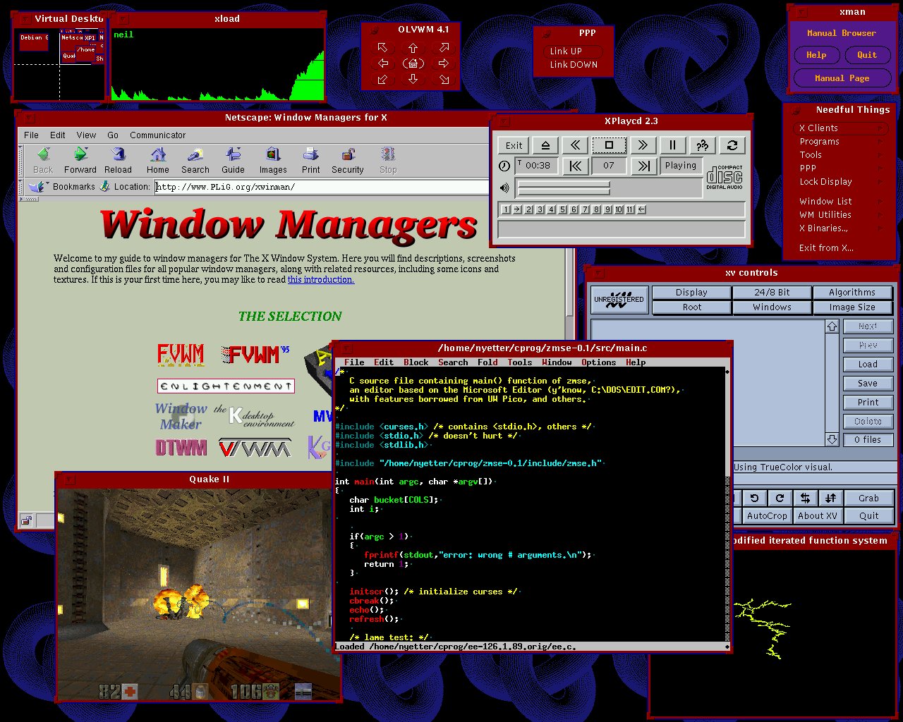

OpenLook virtual window manager
OLVWM
This package contains an extended version of olwm, the original
OpenLook window manager, enhanced for handling of virtual desktops.
听说过这个WM,听说他可以虚拟一个比现实屏幕大很多的桌面。

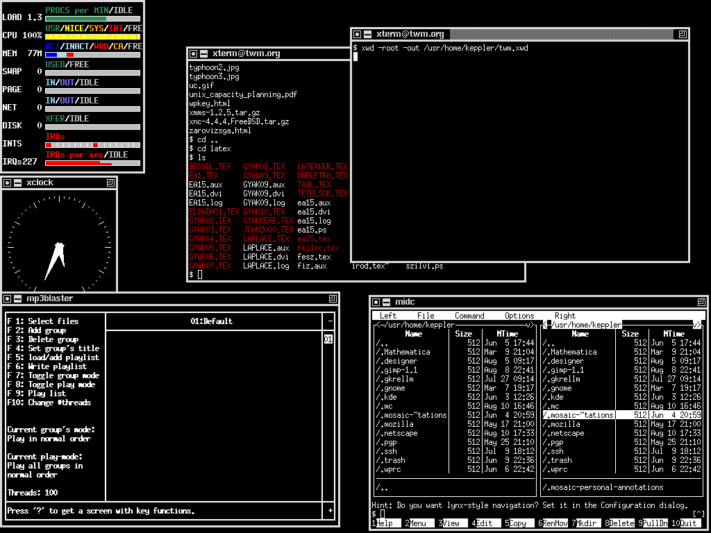

Tab 窗口管理器
twm 是用于 X 窗口系统的窗口管理器。提供标题栏、窗口轮廓、不同形式的图标管
理、用户定义宏函数点击和指针驱动的键盘焦点,用户可以指定键和光标按钮的绑定。
这好像是传说中最小的窗口管理器

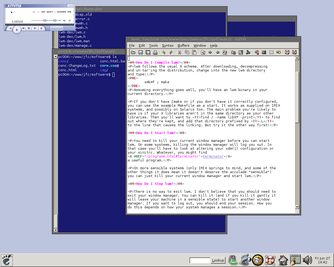

lightweight window manager
LWM
Low resource Window manager ideal for older PCs. It uses a minimum of
external libraries, thus very little memory. It doesn't iclude
icons, icon docs, button bars or root menus.
什么也没有?
最后一个版本是2009年的,也是终于找到贴图了。不过估计面板可能不是lwm的,应该是别的独立面板。

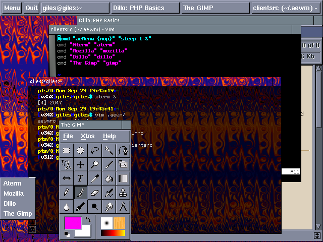

一种 X11 系统的最小窗口管理器
evilwm is based on aewm by Decklin Foster. It further maximises screen
real-estate and provides a good set of keyboard controls.
2011年7月最后发布最新版本
一种 X11 系统的最小窗口管理器
aewm 是一种 X11 系统的最小窗口管理器。它没有华丽的功能,但只占用很少的资源,界面极为简洁。它将逐步实现 ICCCM 标准所规定的功能。
aewm 提供了一些独立的程序来处理运行程序,切换窗口等功能。
也号称“最小”呀!

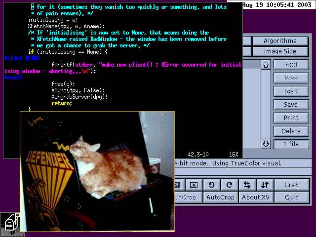

minimal window manager written in C++
aewm++ is a minimal window manager for X11, based on aewm. It keeps aewm's
minimalist look and feel but is written in C++, and adds some modern features
like virtual desktops. GNOME EWMH hints have been removed in this release,
because upstream wants to focus on making the code stable and minimalistic.
This package used to include appbar, aewm++_fspanel, setrootimage and
aewm++_xsession; these can now be found in the aewm++-goodies package.
补足一个最小的窗体管理器的工具
aewm++-goodies
These utilities were previously supplied with aewm++; they are intended to provide some of the typical desktop functionality that aewm++ itself does not include. This package provides:
* aewm++_appbar: a small application launcher
* aewm++_fspanel: a very small panel
* aewm++_setrootimage: draws a gradient on the X root window
* aewm++_xsession: keeps an X session alive
Note that some of these were named differently in previous releases.
(终于找到这个截图了,好难找呀。看上去很有个性呀,最后一个版本好像是2003年发布的)

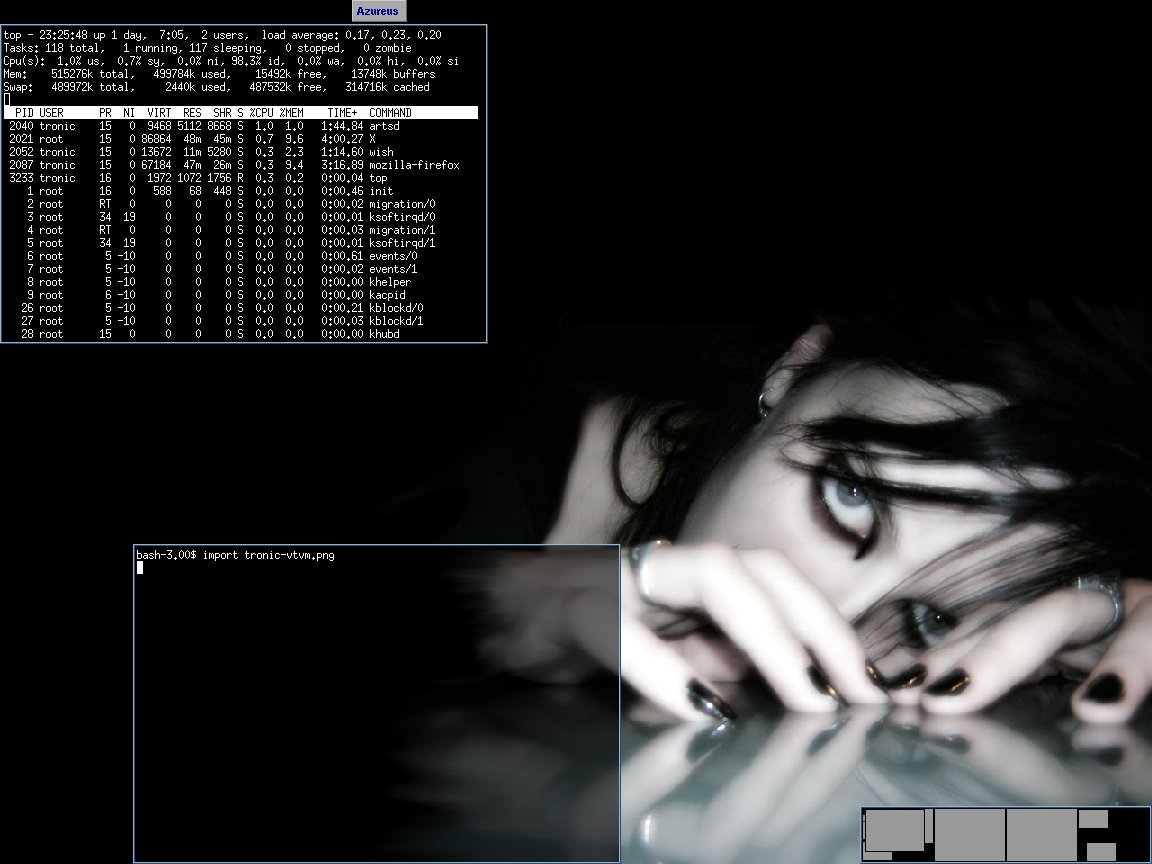

Virtual Tab Window Manager
VTWM is an enhanced version of the Tab window manager (TWM) that adds many
features -- primarily a virtual desktop, meaning that what is currently on
screen is just a portion of a larger workspace. What portion of the virtual
desktop that is displayed, and whatever windows might be visible within it,
are simple point-and-click operations within a scaled representation of the
workspace.
又是虚拟大于实际屏幕的虚拟桌面。

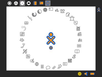

Sugar graphical shell - window manager
sugar-session-0.90
Sugar is a graphical user interface aimed at children.
Originating as intregral part of the OLPC "XO" a.k.a. the $100 laptop,
Sugar has since grown into a more widely usable low-ressource desktop
environment for kids.
This package contains the integrated session and window manager Sugar.
专为儿童设计的WM

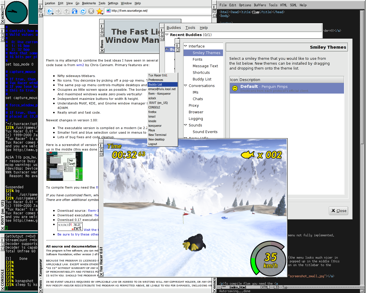

Fast Light Window Manager
Flwm is an attempt to combine the best ideas from several
window managers. The primary influence and code base is from
wm2 by Chris Cannam. Primary features copied from wm2 are:
- Does not look like Windows.
- Nifty sideways title bars.
- No icons. You deiconify by picking off a pop-up menu.
This means no space is wasted by icons.
- Really small and fast code.
It is enhanced by the author's own further nutty ideas:
- Does not use shape extension, more standard resize handles.
- Occupies as little screen space as possible. The border and titles
are as thin as you could possibly make them. And maximized
windows waste only 15 pixels horizontally and zero (count'em)
pixels vertically!
- Independent maximize buttons for width & height, close button.
- Understands Motif, KDE, and GNOME window manager hints.
- Multiple desktops, controlled from the same menu as the icons.
虽然没有完全看懂,不过可以看出这个WM在窗口、菜单、图标方面很有个性。

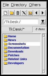

Tk/tcl based X11 Desktop/File manager
TkDesk is a graphical file manager for Unix (esp. Linux) and the X
Window System.
Compared with other file managers available, it offers the most
complete set of file operations and services, plus gives the user the
ability to configure most every aspect of TkDesk in a powerful way.
TkDesk has been influenced by various other systems and file managers,
such as NeXT, for laying out the file browser windows, Apple Finder,
for the idea of file annotations and, shock horror, Windows 95, for
some other inspirations.
一个独立文件/桌面管理器,自己说他影响了windows和苹果公司的产品。
