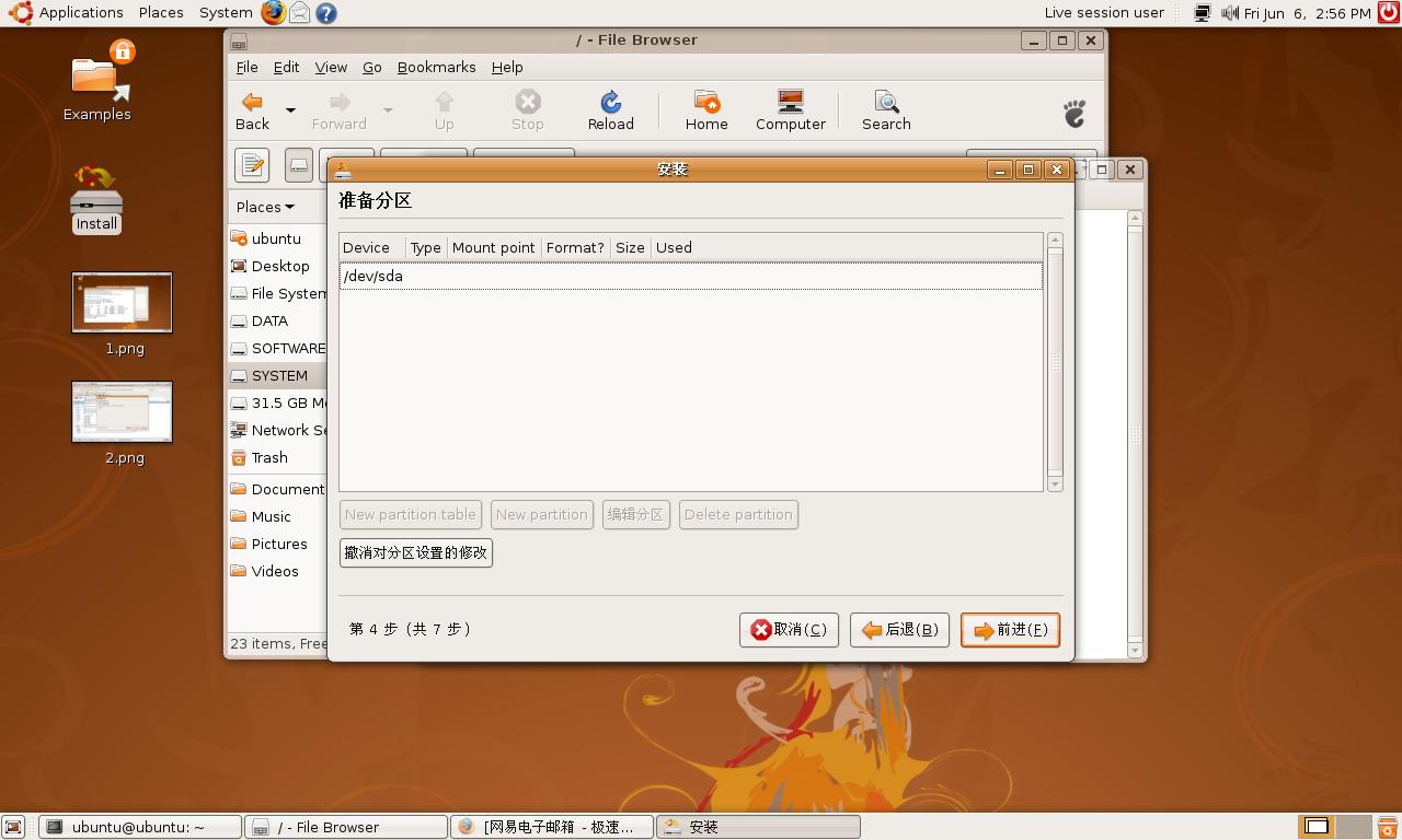

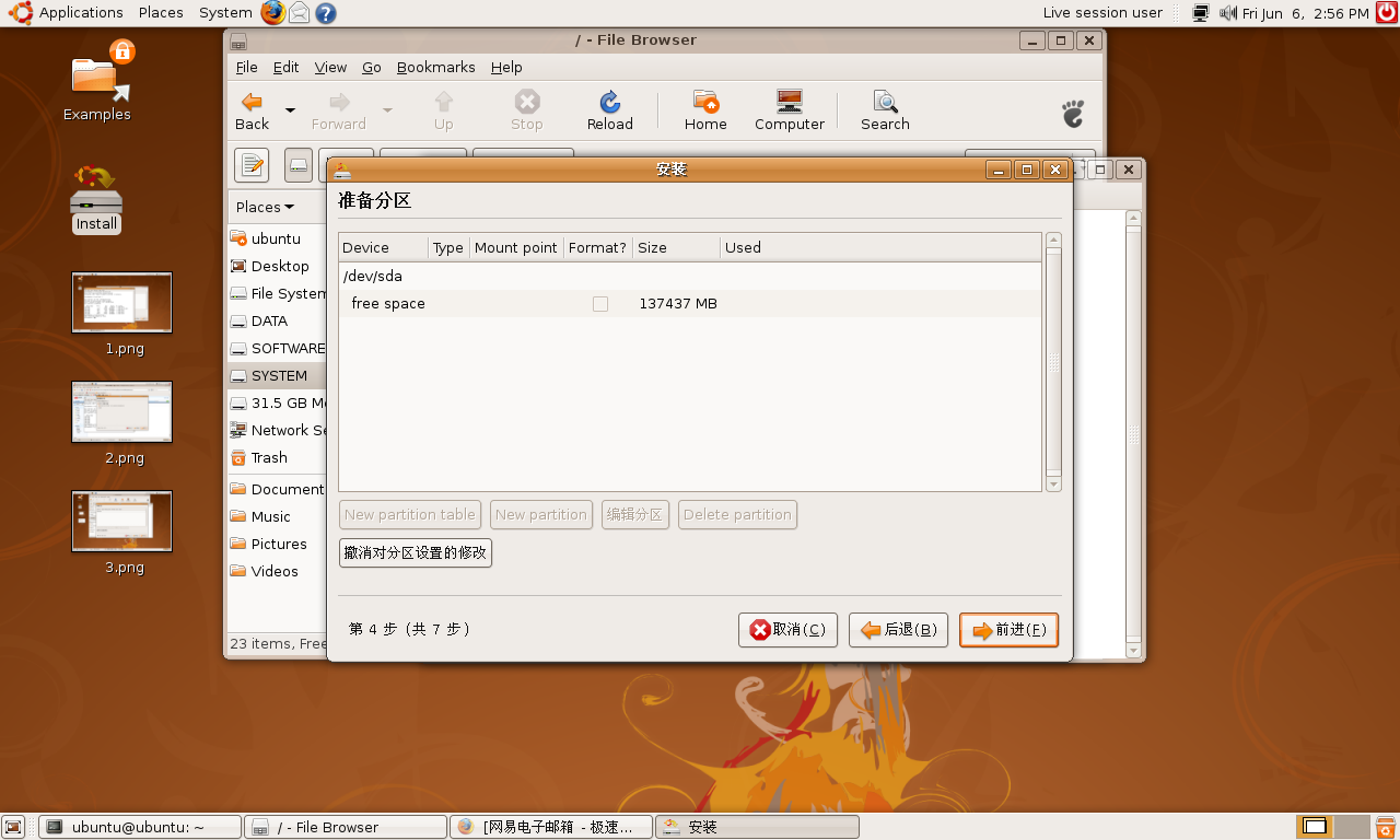

下载ubuntu-8.04-desktop-amd4.iso刻盘安装
之前有用过PQ调整过分区
然后进行到分区的时候
出现整个硬盘 是选择的手动 已经试了30多次
之前有用过PQ调整过分区
然后进行到分区的时候

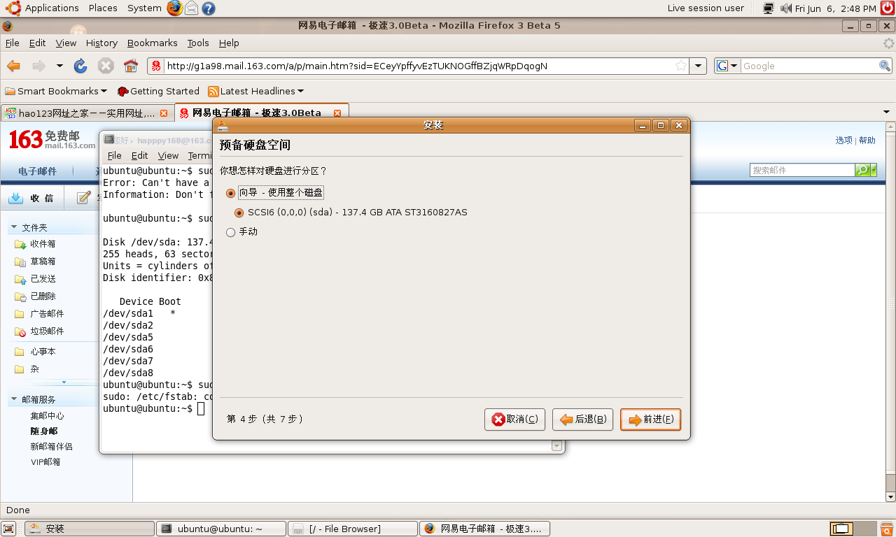

下面是在终端查看的结果
ubuntu@ubuntu:~$ sudo parted /dev/sda print
Error: Can't have a partition outside the disk!
Information: Don't forget to update /etc/fstab, if necessary.
ubuntu@ubuntu:~$ sudo fdisk -l
Disk /dev/sda: 137.4 GB, 137437871104 bytes
255 heads, 63 sectors/track, 16709 cylinders
Units = cylinders of 16065 * 512 = 8225280 bytes
Disk identifier: 0x8a941a0f
Device Boot Start End Blocks Id System
/dev/sda1 * 1 1020 8193118+ b W95 FAT32
/dev/sda2 1021 16710 126029925 f W95 Ext'd (LBA)
/dev/sda5 1021 3570 20482843+ b W95 FAT32
/dev/sda6 3571 7395 30724281 b W95 FAT32
/dev/sda7 7396 10536 25230051 b W95 FAT32
/dev/sda8 12878 16709 30780508+ b W95 FAT32
