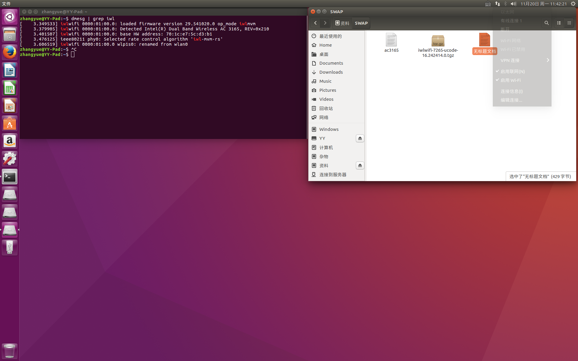

再附上一张截图,请看右上角的无线状态,那个启动wifi是我自己开机后选上的

帖子 vickycq » 2017-11-20 13:26
执行以下指令将结果全部复制贴上来
sudo lshw -numeric -C net
sudo rfkill list all
lsmod | grep -i 'pad\|wmi'
cat /sys/class/dmi/id/{sys_vendor,product_name}
另外 "YY-Pad" 是怎样的设备?

帖子 zhangyue510 » 2017-11-20 18:31
vickycq 写了:执行以下指令将结果全部复制贴上来
另外 "YY-Pad" 是怎样的设备?
以下是执行结果
zhangyue@YY-Pad:~$ sudo lshw -numeric -C net
[sudo] zhangyue 的密码:
*-network DISABLED
description: Wireless interface
product: Intel Corporation [8086:3166]
vendor: Intel Corporation [8086]
physical id: 0
bus info: pci@0000:01:00.0
logical name: wlp1s0
version: 99
serial: 70:1c:e7:5c:d3:b1
width: 64 bits
clock: 33MHz
capabilities: pm msi pciexpress bus_master cap_list ethernet physical wireless
configuration: broadcast=yes driver=iwlwifi driverversion=4.13.0-041300-generic firmware=29.541020.0 latency=0 link=no multicast=yes wireless=IEEE 802.11
resources: irq:284 memory:b1500000-b1501fff
*-network
description: Ethernet interface
physical id: 3
logical name: enx000ec6a063f3
serial: 00:0e:c6:a0:63:f3
capacity: 100Mbit/s
capabilities: ethernet physical tp mii 10bt 10bt-fd 100bt 100bt-fd autonegotiation
configuration: autonegotiation=on broadcast=yes driver=asix driverversion=22-Dec-2011 duplex=full firmware=ASIX AX88772 USB 2.0 Ethernet ip=192.168.1.108 link=yes multicast=yes port=MII speed=100Mbit/s
zhangyue@YY-Pad:~$ sudo rfkill list all
0: ideapad_wlan: Wireless LAN
Soft blocked: no
Hard blocked: yes
1: ideapad_bluetooth: Bluetooth
Soft blocked: yes
Hard blocked: yes
2: ideapad_3g: Wireless WAN
Soft blocked: no
Hard blocked: yes
3: hci0: Bluetooth
Soft blocked: yes
Hard blocked: no
4: phy0: Wireless LAN
Soft blocked: no
Hard blocked: no
zhangyue@YY-Pad:~$ lsmod | grep -i 'pad\|wmi'
snd_rawmidi 32768 1 snd_seq_midi
snd_seq_device 16384 3 snd_seq,snd_rawmidi,snd_seq_midi
wmi_bmof 16384 0
snd 81920 19 snd_compress,snd_hda_intel,snd_hwdep,snd_seq,snd_hda_codec,snd_timer,snd_rawmidi,snd_hda_codec_hdmi,snd_hda_codec_generic,snd_seq_device,snd_hda_codec_realtek,snd_soc_core,snd_pcm
ideapad_laptop 32768 0
sparse_keymap 16384 2 intel_vbtn,ideapad_laptop
acpi_pad 180224 0
wmi 24576 2 wmi_bmof,ideapad_laptop
video 40960 2 i915,ideapad_laptop
zhangyue@YY-Pad:~$ cat /sys/class/dmi/id/{sys_vendor,product_name}
LENOVO
80U1
关于本设备是联想的一款二合一平板电脑,这是中关村在线介绍的链接:https://item.jd.com/3653810.html
