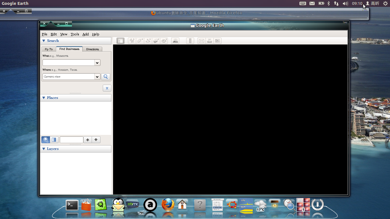

基本的命令格式都打错了,神仙也难救, rm gedit 后面有空格。xszzxuyang 写了:+++++++:~$ sudo rm/opt/google/earth/free/libQt*.*
sudo: rm/opt/google/earth/free/libQt*.*: command not found
+++++++:~$ sudo gedit/opt/google/earth/free/googleearth
sudo: gedit/opt/google/earth/free/googleearth: command not found
是什么原因啊,运行别的命令很多时候也这样,高手指点一下,谢!

这个问题怎么办呢?oliveryty 写了:终端下root权限用命令删除 /opt/google/earth/free/lang 里面的 zh-Hans.qm zh-Hant.qm zh-Hant-HK.qm
这样直接出来英文。很简洁很强大。

64位修改后无法启动了

按照楼主的方法后google earth不能启动
./googleearth-bin: symbol lookup error: ./libmoduleframework.so: undefined symbol: _Z34QBasicAtomicInt_fetchAndAddOrderedPVii

Re: 解决google earth 6显示乱码和开启后退出的问题
不行,12.04 ,改了之后启动不了
lc@lc-MXC062:~$ google-earth
我也启动不了了:seoul_sz 写了:sudo rm /opt/google/earth/free/libQt*.*
libQt一删google earth就启动不了
alice@laptop:/opt/google/earth/free$ tail googleearth
fi
dirname $fullpath
script_path=$(FindPath $0);
cd $script_path;
export LD_PRELOAD=/usr/lib/libfreeimage.so.3
LD_LIBRARY_PATH=.:$LD_LIBRARY_PATH ./googleearth-bin "$@"
alice@laptop:/opt/google/earth/free$ ./googleearth
[b]./googleearth-bin: symbol lookup error: ./librender.so: undefined symbol: _Z34QBasicAtomicInt_fetchAndAddOrderedPVii[/b]
alice@laptop:/opt/google/earth/free$ ls /usr/lib/libfreeimage.so.3
wealth_san 写了:诶这个方法好gaoxin 写了:这个问题怎么办呢?oliveryty 写了:终端下root权限用命令删除 /opt/google/earth/free/lang 里面的 zh-Hans.qm zh-Hant.qm zh-Hant-HK.qm
这样直接出来英文。很简洁很强大。
改了后确实英文了,但是让选directx还是opengl不管选什么都自动退出:
alice@laptop:/opt/google/earth/free$ tail /home/alice/.googleearth/crashlogs/crashlog-4faf0f09.txt
./libQtGui.so.4(_ZN7QWidget10setVisibleEb+0x1db)[0x10d8a2b]
./libQtGui.so.4(_ZN7QWidget10showNormalEv+0x5c)[0x10c616c]
./libgoogleearth_free.so(_ZN10MainWindow18readScreensizeInfoEv+0xdef)[0xe24acf]
./libgoogleearth_free.so(_ZN5earth6client11Application12SetupMainWinENS0_3Kvw7ProductEb+0x334)[0xe648c4]
./libgoogleearth_free.so(_ZN5earth6client11Application3runEv+0x7d2)[0xe6be22]
./libgoogleearth_free.so(+0xc511b)[0xe5c11b]
./libgoogleearth_free.so(earthmain+0x249)[0xe5c6f9]
./googleearth-bin[0x804878b]
/lib/tls/i686/cmov/libc.so.6(__libc_start_main+0xe6)[0x4ed5bd6]
./googleearth-bin[0x80486d1]
