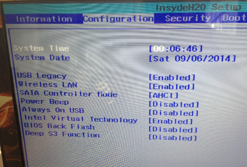

问题1.
我重新安装了grub-install ,boot目录中出现了 vmlinuz-3.13.0-34-generic.efi.signed
在bios里我没有启用EFI呀

问题1.
在bios里我没有启用EFI呀
dpkg -l | grep linux-signed-image
ii linux-signed-image-3.13.0-24-generic 3.13.0-24.47
ii linux-signed-image-3.13.0-27-generic 3.13.0-27.50
ii linux-signed-image-3.13.0-29-generic 3.13.0-29.53
ii linux-signed-image-3.13.0-30-generic 3.13.0-30.55
ii linux-signed-image-3.13.0-32-generic 3.13.0-32.57
ii linux-signed-image-3.13.0-33-generic 3.13.0-33.58
ii linux-signed-image-3.13.0-34-generic 3.13.0-34.60
ii linux-signed-image-generic 3.13.0.34.40
http://packages.ubuntu.com/trusty-updat ... c/filelist
/boot/vmlinuz-3.13.0-34-generic.efi.signed
來自

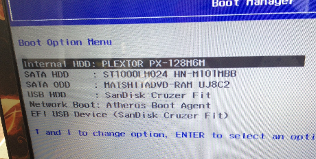

硬盘及硬盘分区:
sda ==> SSD, GPT
sdb ==> 机械硬盘, GPT
sdc ==> u盘启动盘, MBR
sda1 /boot (迁移后)
sda2 / (迁移后)
sda3 /usr (迁移后)
sda4 /var (迁移后)
sda5 other
sdb1 /boot
sdb2 /
sdb3 /home
sdb4 /usr
sdb5 /var
sdb6 swap
