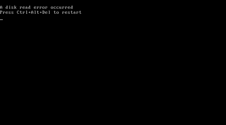

Boot Info Script 0.55    dated February 15th, 2010

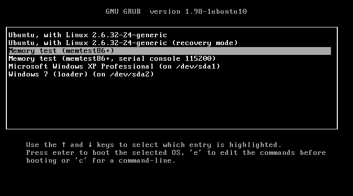

============================= Boot Info Summary: ==============================
 => Grub 2 is installed in the MBR of /dev/sda and looks on the same drive in
    partition #5 for /boot/grub.
sda1: _________________________________________________________________________
    File system:       ntfs
    Boot sector type:  Windows Vista/7
    Boot sector info:  No errors found in the Boot Parameter Block.
    Operating System:  Windows XP
    Boot files/dirs:   /ntldr /NTDETECT.COM
sda2: _________________________________________________________________________
    File system:       ntfs
    Boot sector type:  Windows XP
    Boot sector info:  According to the info in the boot sector, sda2 starts
                       at sector 63. But according to the info from fdisk,
                       sda2 starts at sector 10490508.
    Operating System:  Windows 7
    Boot files/dirs:   /bootmgr /Boot/BCD /Windows/System32/winload.exe

title        Ubuntu 10.04.1 LTS, kernel 2.6.32-24-generic
uuid        ea0922d5-ced5-42d2-9b12-a0df10257b4e
kernel        /boot/vmlinuz-2.6.32-24-generic root=UUID=ea0922d5-ced5-42d2-9b12-a0df10257b4e ro quiet splash
initrd        /boot/initrd.img-2.6.32-24-generic
quiet
title        Ubuntu 10.04.1 LTS, kernel 2.6.32-24-generic (recovery mode)
kernel        /boot/vmlinuz-2.6.32-24-generic root=UUID=ea0922d5-ced5-42d2-9b12-a0df10257b4e ro  single
title        Chainload into GRUB 2
root        ea0922d5-ced5-42d2-9b12-a0df10257b4e
kernel        /boot/grub/core.img
title        Ubuntu 10.04.1 LTS, memtest86+
kernel        /boot/memtest86+.bin
quiet
### END DEBIAN AUTOMAGIC KERNELS LIST

    search --no-floppy --fs-uuid --set ea0922d5-ced5-42d2-9b12-a0df10257b4e
    linux16    /boot/memtest86+.bin
menuentry "Memory test (memtest86+, serial console 115200)" {
    insmod ext2
    set root='(hd0,5)'
    linux16    /boot/memtest86+.bin console=ttyS0,115200n8
### END /etc/grub.d/20_memtest86+ ###
### BEGIN /etc/grub.d/30_os-prober ###
menuentry "Microsoft Windows XP Professional (on /dev/sda1)" {
    insmod ntfs
    set root='(hd0,1)'
    search --no-floppy --fs-uuid --set 622868ef2868c39f
    drivemap -s (hd0) ${root}
    chainloader +1
menuentry "Windows 7 (loader) (on /dev/sda2)" {
    insmod ntfs
    set root='(hd0,2)'
    search --no-floppy --fs-uuid --set 8218a2fa9499d62d
    chainloader +1
### END /etc/grub.d/30_os-prober ###
### BEGIN /etc/grub.d/40_custom ###
# This file provides an easy way to add custom menu entries.  Simply type the
# menu entries you want to add after this comment.  Be careful not to change
# the 'exec tail' line above.
### END /etc/grub.d/40_custom ###
=============================== sda5/etc/fstab: ===============================
# /etc/fstab: static file system information.
# Use 'blkid -o value -s UUID' to print the universally unique identifier
# for a device; this may be used with UUID= as a more robust way to name
# devices that works even if disks are added and removed. See fstab(5).
# <file system> <mount point>   <type>  <options>       <dump>  <pass>
proc            /proc           proc    nodev,noexec,nosuid 0       0
# / was on /dev/sda6 during installation
UUID=ea0922d5-ced5-42d2-9b12-a0df10257b4e /               ext4    errors=remount-ro 0       1
# swap was on /dev/sda7 during installation
UUID=f0f18abb-72de-44a5-ac04-6c6f44257c10 none            swap    sw              0       0
=================== sda5: Location of files loaded by Grub: ===================
  18.8GB: boot/grub/core.img
  18.8GB: boot/grub/grub.cfg
  18.8GB: boot/grub/menu.lst
  18.8GB: boot/grub/stage2
  19.2GB: boot/initrd.img-2.6.32-24-generic
  19.2GB: boot/vmlinuz-2.6.32-24-generic
  19.2GB: initrd.img
  19.2GB: vmlinuz

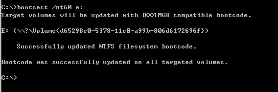

bootsect不能重写扇区boot sector类型吗?命令不就是 bootsect /nt60 d:吗?

bootsect /nt60 d:
命令没错,不知道哪个地方出错了,引导没写进去。也有可能逻辑分区转为主分区时引导扇区位置错误引起的
你执行bootsect /nt60 d: 应该不是提示成功写入,而是有什么报错信息才对

在PE下,我把bootsect放在D盘上是无法成功更新D盘的PBR的。仔细看了看提示,需要先卸载D盘,然后最后提示了一个,注意两者都有successfully的提示。汗 :em06,前者是成功,后者是假成功。
