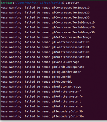

在虚拟机Vmware17下安装的Ubuntu22.04.4,安装了openFoam10,计算第一个案例的时候,一切都好,但就是paraFoam调用paraview图形化界面,就出现一下问题,能不能有大佬指点一下,我手动启动paraview然后导入数据文件可以显示图形,但是终端调用就是会这样不行。。。
Mesa warning:failed to remap glcompressedTexImage1D
Mesa warning:failed to remap glCompressedTexImage2D
Mesa warning:failed to remap glCompressedTexImage3D
Mesa warning:failed to remap glcompressedTexSubImage1D
Mesa warning:failed to remap glCompressedTexSubImage2D
Mesa warning:failed to remap glCompressedTexSubImage3D
Mesa warning:failed to remap glGetCompressedTexImage
Mesa warning:failed to remap glLoadTransposeMatrixd
Mesa warning:failed to remap glLoadTransposeMatrixf
Mesa warning:failed to remap glMultTransposeMatrixd
Mesa warning:failed to remap glMultTransposeMatrixf
Mesa warning:failed to remap glsamplecoverage
Mesa warning:failed to remap glBlendFuncSeparate
Mesa warning:failed to remap glFogCoordPointer
Mesa warning:failed to remap glFogCoordd
8
11
0x783e56e8ef76 pqServerManagerModel:serverAdded(pqServer*)+70
10
0x783e562f17c8/1ib/x86_64-1inuX-gnu/1ib0t5Core.s0.5(+0x2f17c8)[0x783e5
62f17c8]
9
0x783e57f59a26 pqDefaultviewBehavior:onServercreation(pqServer*)+86
8
0x783e55cd8489 vtkPVSessioncore:GatherInformation(unsigned int,vtkPVIn
formation*,unsigned int)+377
7
0x783e55cd819a vtkPVSessioncore:GatherInformationInternal(vtkPVInformat
ion*,unsigned int)+58
6
0x783e49dc621d vtkPVRenderingCapabilitiesInformation:CopyFromobject(vtk
object*)+13
5
0x783e49dc61e3 vtkPVRenderingCapabilitiesInformation:GetLocalCapabiliti
es()+339
4
0x783e55150675 vtkopenGLRenderwindow:SupportsopenGL()+1029
3
0x783e55154d05 vtkopenGLRenderwindow:OpenGLInit()+133
2
0x783e581b4f93 vtkglew glewInit 611
1
0x783e5819b33a /opt/paraviewopenfoam510/lib/libvtkglew-pv5.10.so.1(+0x5c
33a)
[0x783e5819b33a]
0x783e58242520
/11b/x8664-1inuX-gnu/1ibc.s0.6(+0x42520)[0x783e58242520
1.639s)
paraview
:0
FATL Signal:SIGSEG
段错误(核心已转储)

虚拟显卡不支持那些opengl调用吧。虚拟机设置里3d图形加速开没有,vmware tools安装成功没有
宿主机显卡如果不在支持列表里,还需要在vmx文件里加上
mks.gl.allowUnsupportedDrivers = "TRUE"
mks.gl.allowBlacklistedDrivers = "TRUE"
搞不定就去装双系统,vmware对opengl的加速也只是软件模拟的,性能不行

谢谢大哥!我都按你说的整了,但还是显示上述问题,唉,只好弄个双系统了,但是我不明白的是,既然显卡不支持,为什么手动打开paraview然后导入文件数据可以出图呢。。。
