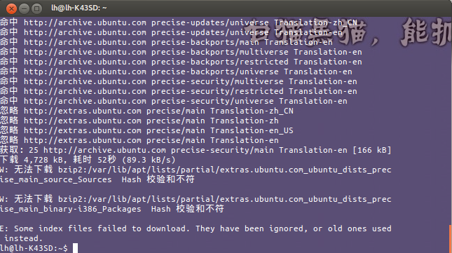

help!更新软件出现问提,本人新手求指导

终端的错误信息
W: 无法下载 bzip2:/var/lib/apt/lists/partial/extras.ubuntu.com_ubuntu_dists_precise_main_source_Sources Hash 校验和不符
W: 无法下载 bzip2:/var/lib/apt/lists/partial/extras.ubuntu.com_ubuntu_dists_precise_main_binary-i386_Packages Hash 校验和不符
E: Some index files failed to download. They have been ignored, or old ones used instead.

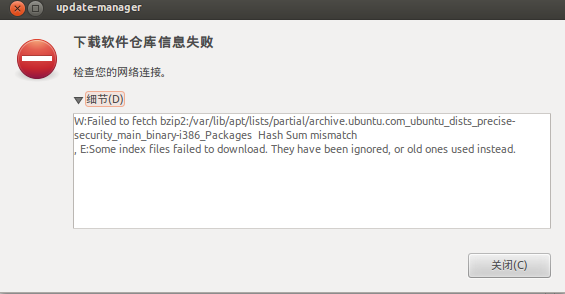

更新管理器的错误信息
W:Failed to fetch bzip2:/var/lib/apt/lists/partial/extras.ubuntu.com_ubuntu_dists_precise_main_source_Sources Hash Sum mismatch
, W:Failed to fetch bzip2:/var/lib/apt/lists/partial/extras.ubuntu.com_ubuntu_dists_precise_main_binary-i386_Packages Hash Sum mismatch
, E:Some index files failed to download. They have been ignored, or old ones used instead.
