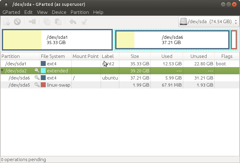

jin@1:~$ sudo fdisk -l
Device     Boot     Start       End  Sectors  Size Id Type
/dev/sda1  *         2048  74096639 74094592 35.3G 83 Linux
/dev/sda2        74098686 156311551 82212866 39.2G  5 Extended
/dev/sda5       152129536 156311551  4182016    2G 82 Linux swap / Solaris
/dev/sda6        74098688 152129535 78030848 37.2G 83 Linux
Can I change the partition number attached to the device name such as / dev / sda?
Since I have installed and erased Linux many times with multi boot,
I feel ugly that it has 5 or 6.
Can sda 6 be sda 3 and sda 5 (swap) be sda 4 in order from the top of the physical hard disk?
我可以更改附加到設備名稱的分區號,如/ dev / sda嗎?
由於我多次安裝和擦除Linux多次啟動,
我覺得醜陋,有5或6。
sda 6可以是sda 3和sda 5(swap)是sda 4從物理硬盤的頂部開始順序嗎?

引用:
1. http://unix.stackexchange.com/a/18759
it is a bad idea and you can lose everything.
1-1. If you still want to do it, refer to :
http://unix.stackexchange.com/questions ... a1-to-sda2
Change the number of the partition from sda1 to sda2
2. For your Reference :
2-1. There are many ways to mark and differentiate the partitions in a disk, Like label,uuid,partuuid,partlabel,.....
sometimes they are recommended to be used instead of /dev/sdax.
2-2. http://manpages.ubuntu.com/manpages/xen ... unt.8.html
The device indication
2-3. http://manpages.ubuntu.com/manpages/xen ... tab.5.html
The first field (fs_spec)
LABEL=<label> or UUID=<uuid> may be given instead of a device name. This is the recommended method, as device names are often a coincidence of hardware detection order, and can change when other disks are added or removed.

引用:
了解
jin@1:~$ lsblk -f
NAME   FSTYPE LABEL  UUID                                 MOUNTPOINT
sda
├─sda1 ext4   mint2  3fb1c77c-7d46-4243-a955-790755e6023b
├─sda2
├─sda5 swap          b27697f1-613f-485f-be6e-e1e5b65f1b14 [SWAP]
└─sda6 ext4   ubuntu fdbadeb3-1cf6-4d23-9a83-61d080ba2afe /
jin@1:~$
引用:
了解
