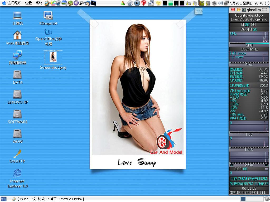

第三步:安装其它监控软件xsensors,ksensors,gdesklets(gdesklets里有很多桌面小程序),Gkrellm,hddtemp等,自己选择安装.
sudo apt-get install xsensors或者ksensors(KDE中推荐使用ksensors)
sudo apt-get install gdesklets gkrellm
安装硬盘温度监控:
sudo apt-get install hddtemp
安装完后重启系统就能正确监控了.
终端中输入sensors命令或者用xsensors或者ksensors就可随时监控CPU温度,风扇转速等硬件状态.

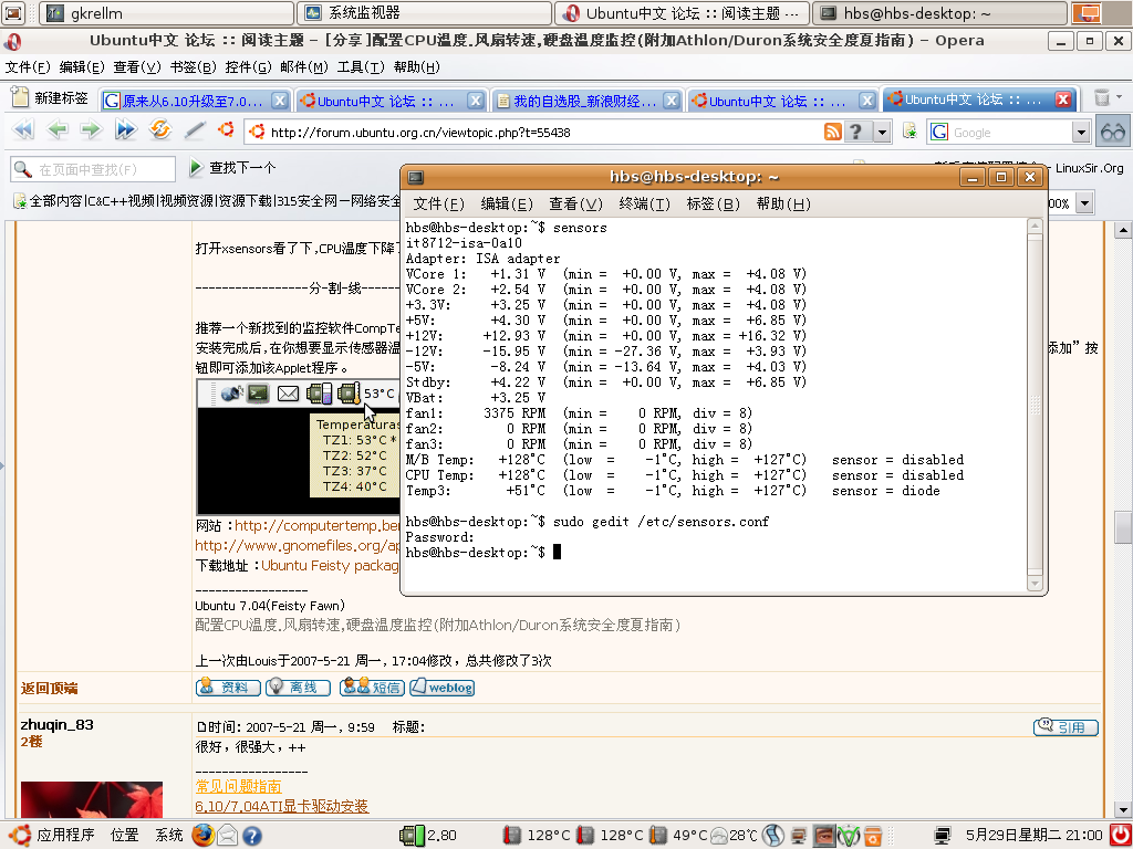

louis@Ubuntu-desktop:~$ sensors
lm90-i2c-0-4c
Adapter: SMBus Via Pro adapter at 0400
M/B Temp:    +37°C  (low  =    +0°C, high =   +70°C)
CPU Temp:  +45.0°C  (low  =  +0.0°C, high = +70.0°C)
M/B Crit:    +85°C  (hyst =   +75°C)
CPU Crit:    +75°C  (hyst =   +65°C)
it87-isa-0290
Adapter: ISA adapter
VCore 1:   +1.50 V  (min =  +0.00 V, max =  +4.08 V)
VCore 2:   +2.53 V  (min =  +0.00 V, max =  +4.08 V)
+3.3V:     +3.33 V  (min =  +0.00 V, max =  +4.08 V)
+5V:       +4.92 V  (min =  +0.00 V, max =  +6.85 V)
+12V:     +11.97 V  (min =  +0.00 V, max = +16.32 V)
-12V:     -19.75 V  (min = -27.36 V, max =  +3.93 V)
-5V:       -0.62 V  (min = -13.64 V, max =  +4.03 V)
Stdby:     +3.87 V  (min =  +0.00 V, max =  +6.85 V)
VBat:      +2.03 V
fan1:     3013 RPM  (min = 2008 RPM, div = 8)
fan2:        0 RPM  (min =    0 RPM, div = 8)
M/B Temp:    +42°C  (low  =  +127°C, high =   +65°C)   sensor = thermistor
CPU Temp:    -55°C  (low  =    -1°C, high =  +127°C)   sensor = thermistor
Temp3:       -20°C  (low  =    -1°C, high =  +127°C)   sensor = thermistor
显示结果中有些数值是不正确的,但是硬件实际的工作状态可能是正常的,只是显示问题.无效的项或者错误的项可以进行修改.
sudo gedit /etc/sensors.conf
搜索自己主板传感器配置段,比如我的就要搜索"lm90","it87"关键词,修改正确的电压显示表达式,过滤的无效项.哈哈,本人英语不过关,还在努力中,具体查看/usr/share/doc/lm-sensors/doc/lm_sensors-FAQ.html或者http://www.lm-sensors.org/wiki/iwizard/1.

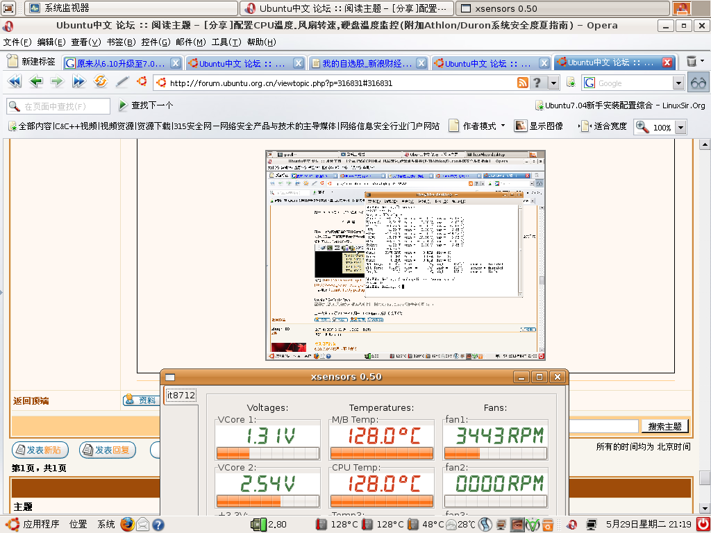

————————以下内容适用于使用Athlon/Duron处理器的系统—————————————————————————————————————
另外,前面提到了我的CPU夏天温度高到70几度,虽然主板有CPU烧不死的保护技术,还是有点恐怖,所以想采用CPU idle的方式进行降温,找到这么一个小软件Athcool,适用于采用Athlon/Duron处理器的系统。
安装降温软件Athcool:
sudo apt-get install athcool
查看它支持的芯片组:
athcool list
使用athcool开始降温:
sudo athcool on
打开xsensors看了下,CPU温度下降了10度左右,效果非常明显,不过麻烦的是每次开机要去运行它,这个夏天不用为CPU温度发愁了哈!!

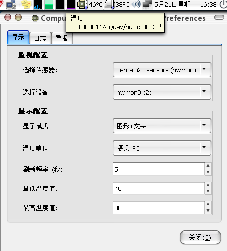

-----------------CompTemp Monitor--------------------------------------------------------------------------------------------
推荐一个新找到的监控软件CompTemp Monitor,功能和sensors-applet差不多差不多,中文界面
安装完成后,在你想要显示传感器温度的面板位置右键,选择“添加到面板”菜单命令,在列表中选择“Computer Temperature Monitor”后单击“添加”按钮即可添加该Applet程序。
网站:http://computertemp.berlios.de/screenshots.php
http://www.gnomefiles.org/app.php/CompTemp_Monitor

用上comptemp了,不过我不太明白设置里面最小和最大温度值是做什么用的啊。
帖子发表于 : 2007-05-28 17:10
注册: 2006-07-23 16:25
帖子: 1592
地址: 南京
哦,图形用的。

:em55 :em55 :em55 :em55 :em55 :em55 :em55 :em55 :em55
我的赛扬D335J cpu温度128℃了 :em84 :em87 :em92
cputemp1.png [ 136.59 KiB | 被浏览 19541 次 ]

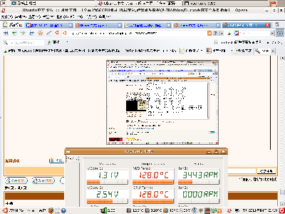

cputemp2.png [ 152.69 KiB | 被浏览 19129 次 ]
cputemp1.png [ 136.59 KiB | 被浏览 18523 次 ]
